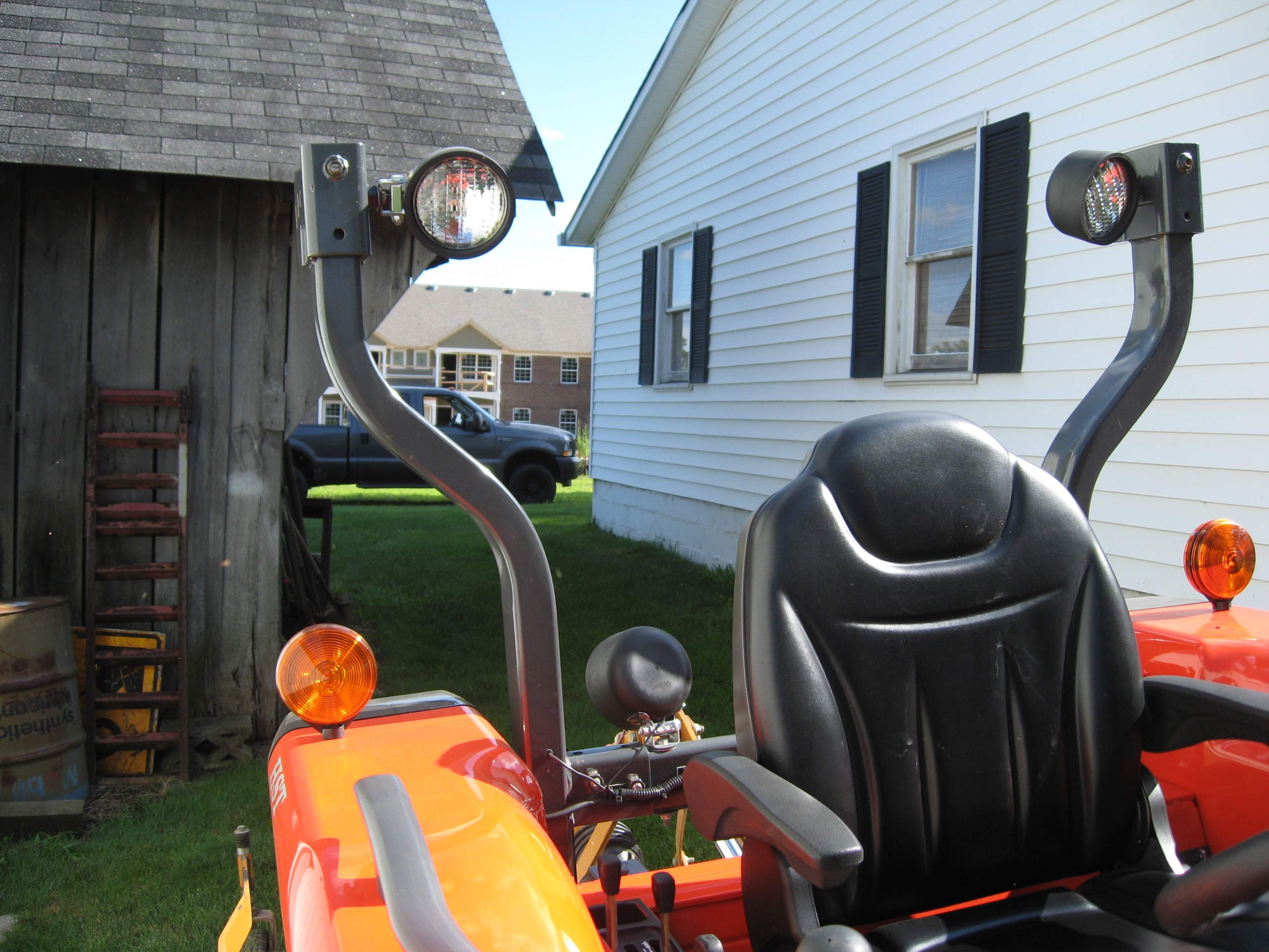

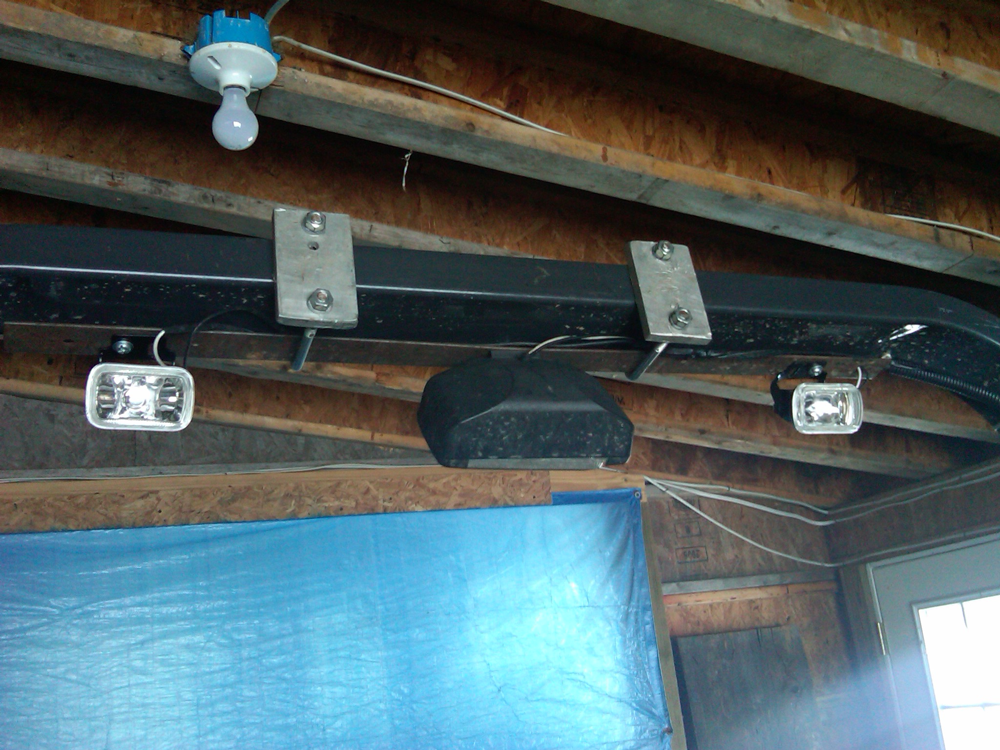

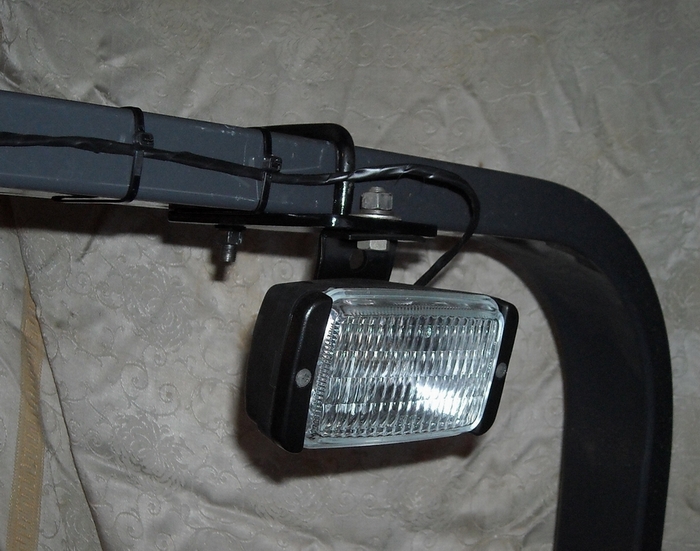

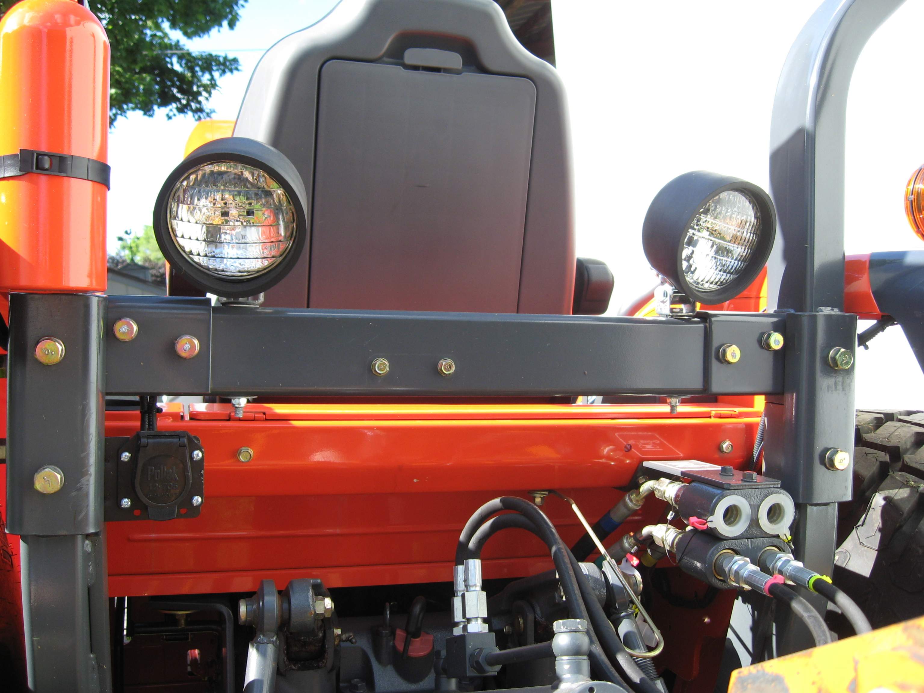

   / Lights for ROP? #2
A. Yes there is. Kubota sells it as an option, inlcude light and bracket. Check at your dealer.
B. I made my own bracket.
Philip

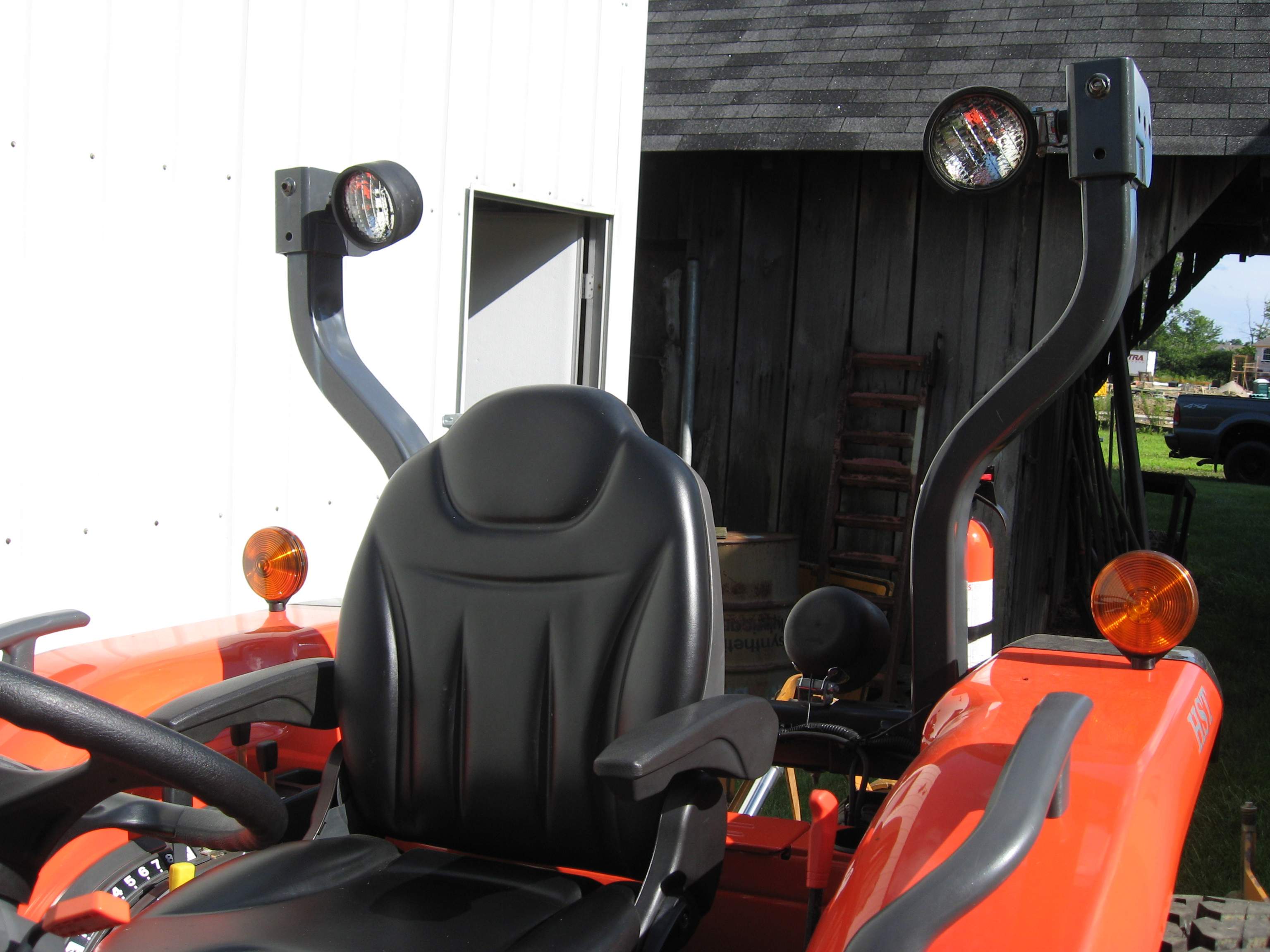

   / Lights for ROP? #4
I built my own using old bed frame and couple square clamps. It's easier then you think.

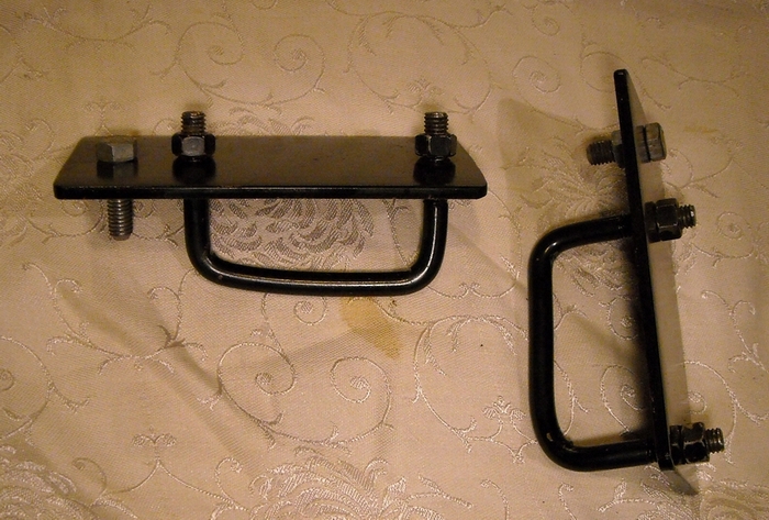

   / Lights for ROP? #7
I built my own brackets.
From my earlier post titled "Worklight Mounting on ROP"
I wanted to mount some worklights on my ROP and with all the posts about welding or drilling the ROP will void its certification, I designed a clamp on mount. The ROP on my BX2660 measures 1-1/2" x 3"
I searched a short time for a small 3 inch inside measurement shackle bolt but could not find a perfect match.
No problem, I'll just make one. Took some 3/8 steel rod, bent it in the shape I needed and threaded it. I then cut some 3/16 plate to 3 inches by 6 inches and drilled 3 holes. Two holes for the shackle bolt and one for the worklight mounting bolt.
$20 for the light at TSC and I already had the scrap metal.
