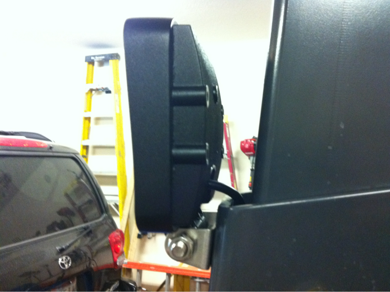

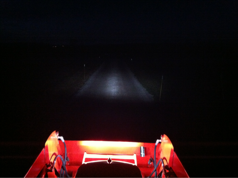

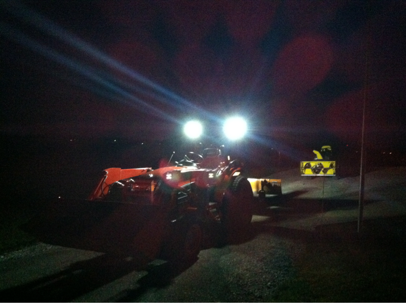

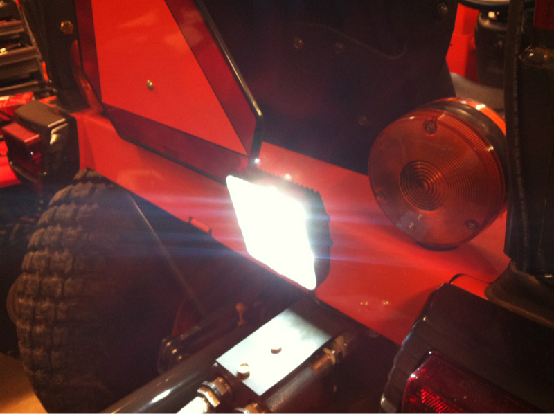

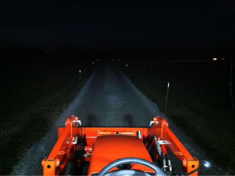

3 work lights of that wattage will consume 100% of the factory dynamo's output. You'll want to either get the 40A alternator upgrade kit or go with LED.
Among the pictures below you will see one with the factory headlights and one with just the LEDs on the ROPS. Each light draws 1.05A and output is 1100 lumens.

Are you using the same LED's that Birdman has listed in his post he linked in this thread? If not could you tell me the type/model # of that light you're using? Also are these 12v or 24v lights?
Reason I ask is when looking at your picture compared to Birdman's it looks like your LED's may be putting out more light. I need to add lights to my ROPS and I need to see as much distance as possible.
