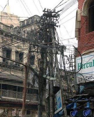

We could see how these guys do it for best practices....
