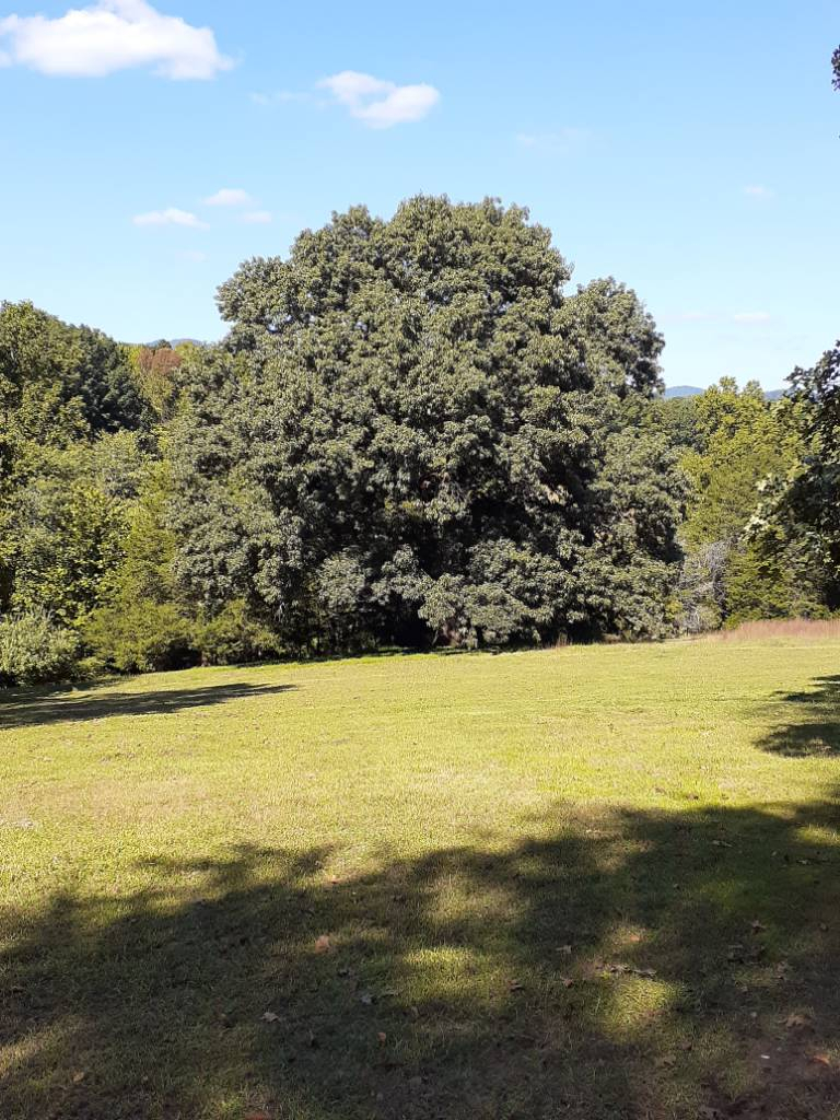

This large oak in one of my pastures has five cows buried under it. It was struck by lightning a few years ago.
Thomas Jefferson's Poplar Forest is close to here and all the oaks have lightning rods. The ground up high is so lightning will strike someplace else. Some people think it's so lightning hits them going to ground. With that massive voltage and current it would melt them.
