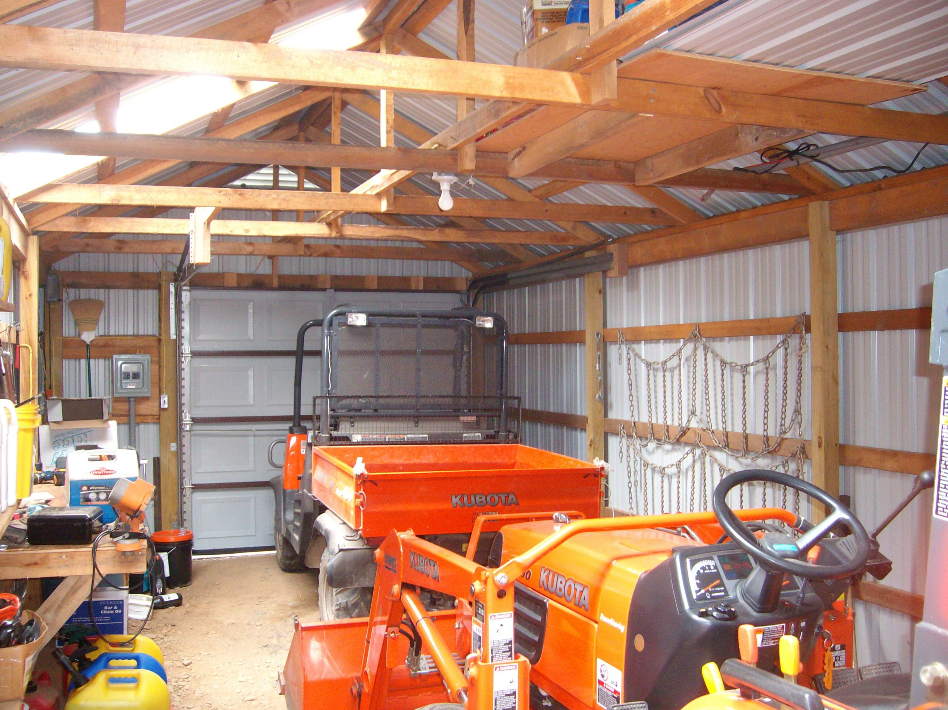

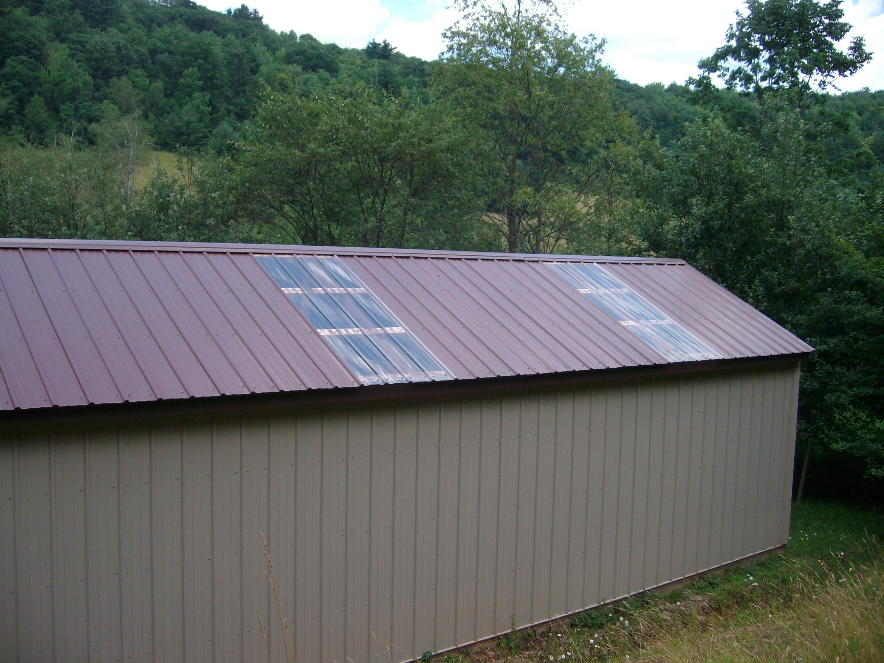

just wanted to throw these pictures of that shed i mentioned with the clear panels in the roof. shed is 12 x 30 with 2 clear panels. this picture was taken in afternoon, mostly sunny, with all doors shut, lights off and shed has no windows. the white on the inside of the shed will help too as compared if your walls are dark. but shed still has a lot of light with just those 2 panels.

majority all sheds around here use metal / tin sheets, any were from 2 feet to 4 feet wide, and up to 20 to 30 feet long. you can normally find the pattern these sheets come in at the large local hardware stores. and insert some clear panels for lighting. if not a local company that builds metal shields should be able to get you the correct pattern that will fit the metal / tin sheets you have on the roof.
have the "sky lights" errr clear panels in both sheds here, and make things bright enough to see fairly good. exception in the dark corners. or when ya in your own shadow looking at stuff along the sides.
