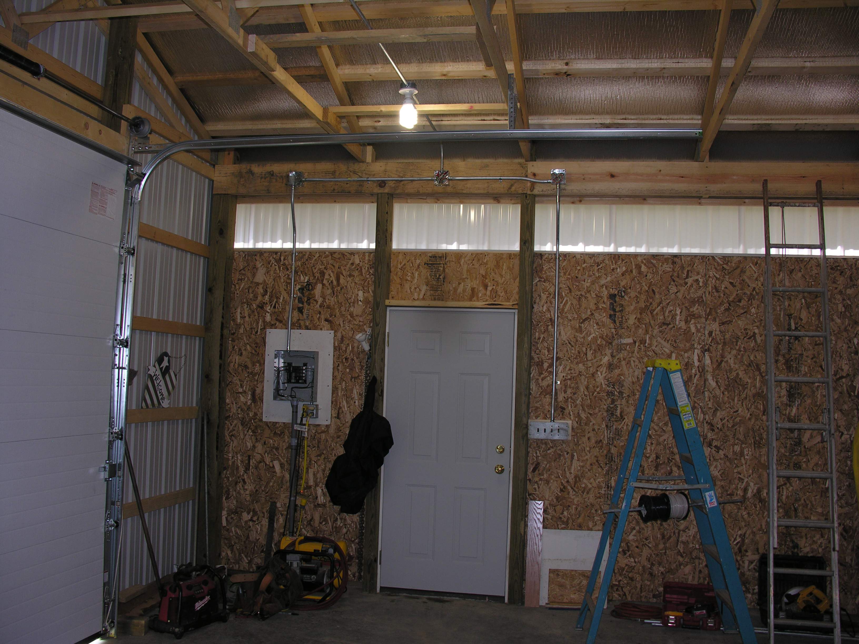

Thanks 5Picker,
I did obtain one of the 65 w CFL bulbs to try out. So far I only have one working light fixture in my building and I have yet to be there after dark since I got the fixture wired. With the beautiful weather we have been having I hate to be stuck working inside!:eek: Once I do see the light after dark I decide if I want more or if I will go for the higher wattage bulbs.
