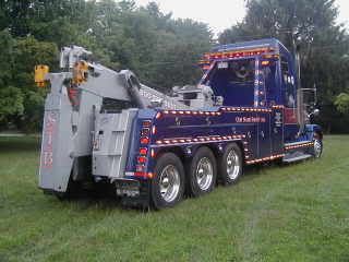

Installed thousands of LED's on road tractors over the years and your dead on about the flasher Ralph. In heavy trucks once you replace the last incandescent bulb with a LED one the flasher usually stops working, just not enough current draw to make the flasher function. However, it's very easy to fix. They make LED flasher relays, non electromechanical type's that are solid state. If you go to the CEC website I listed above and look at their flashers section you will find some that have their minimum operating current in the low milliamps, these are the ones for all LED systems. They work like a charm. I had been using the Grote brand LED relays up until I found the CEC ones. Theirs are about 2 times less expensive and I have yet had one go bad.
If you check the CEC website you will find they also have a full line of LED replacement bulbs like your talking about. The one thing you have to be watch when buying these is the veiwing angle. Some are designed for use as tail lights and emit no or little light to the side while others cover a good 180 degree's.
At last count I think we had gotten something like 280 LED lights on this tow truck. Even with 12 turn signal lights per side I still had to install a LED flasher, it just didn't draw enough to make the factory electromechanical one operate.
