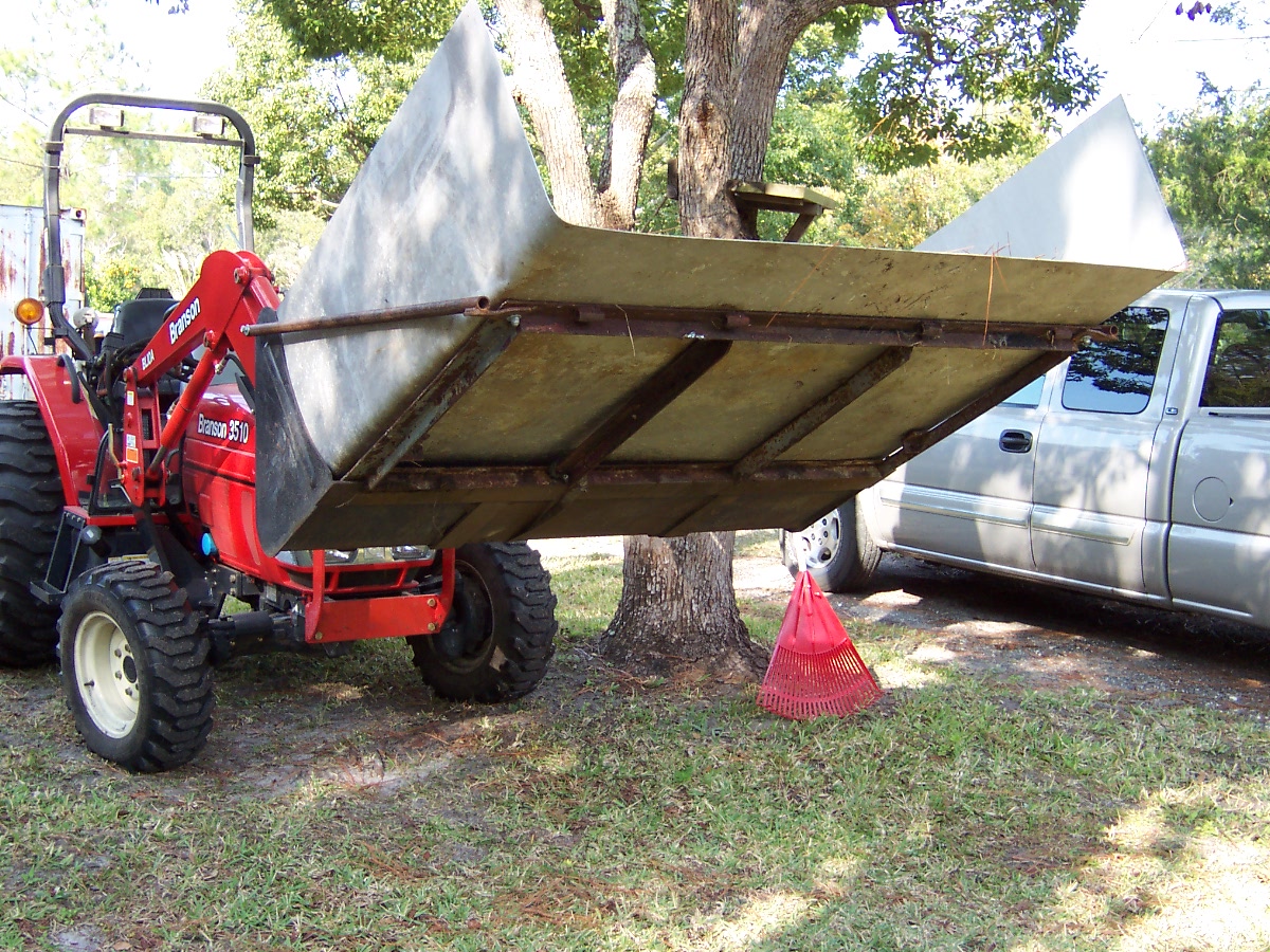

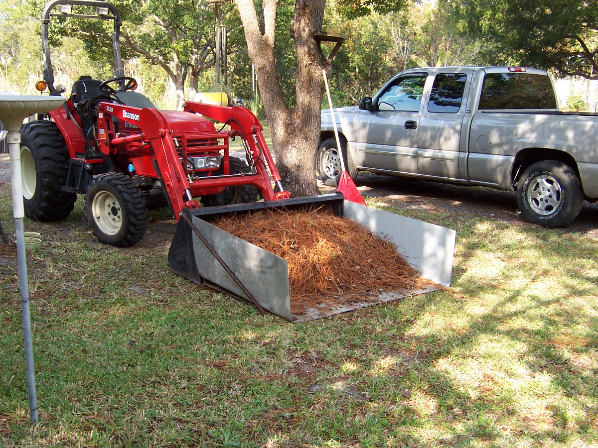

I had to deal with pine needles at my last property so I came up with this piece of aluminum and an old frame that was laying around.
Worked really great and I had 100% dump with bucket straight down.

Alright - see that extended bucket that stimw made on post #5. You get three or four cheap clamp on the bucket fork extensions - make an expansion like stimw did out of light sheet steel - set it on top of the bucket forks and tack weld to the forks. Make the welds out at the tips of the forks strong because that is where this "thing" will take the brunt of the action when you load it with chips. Unless you can see some reason - like stimw's unit - you should not even need a top.
You might even have to get a strip - 4" by the width of your expansion - tack weld it on the lip of the expansion for added strength. A strip of 10 gage steel - like 4" by 60" or whatever.
Using the cheap clamps on bucket forks - this "expansion" can be taken off or put back on - as needed.
