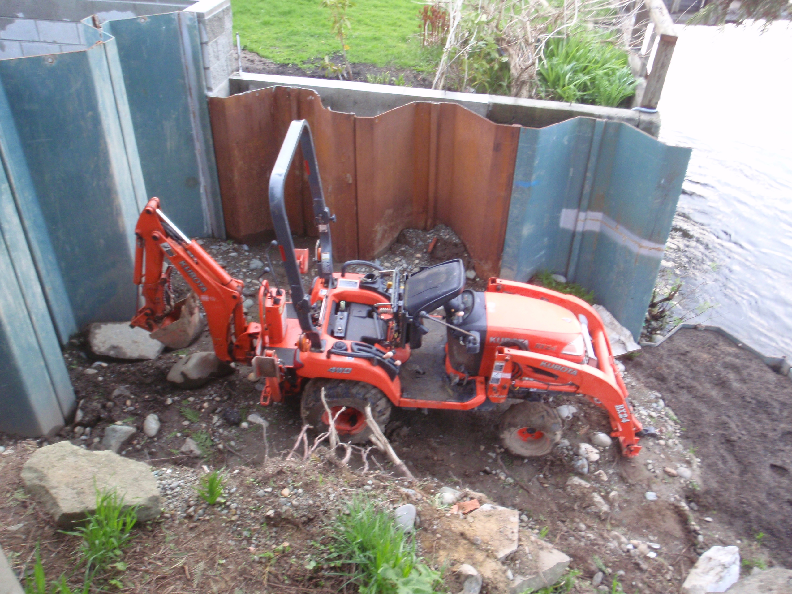

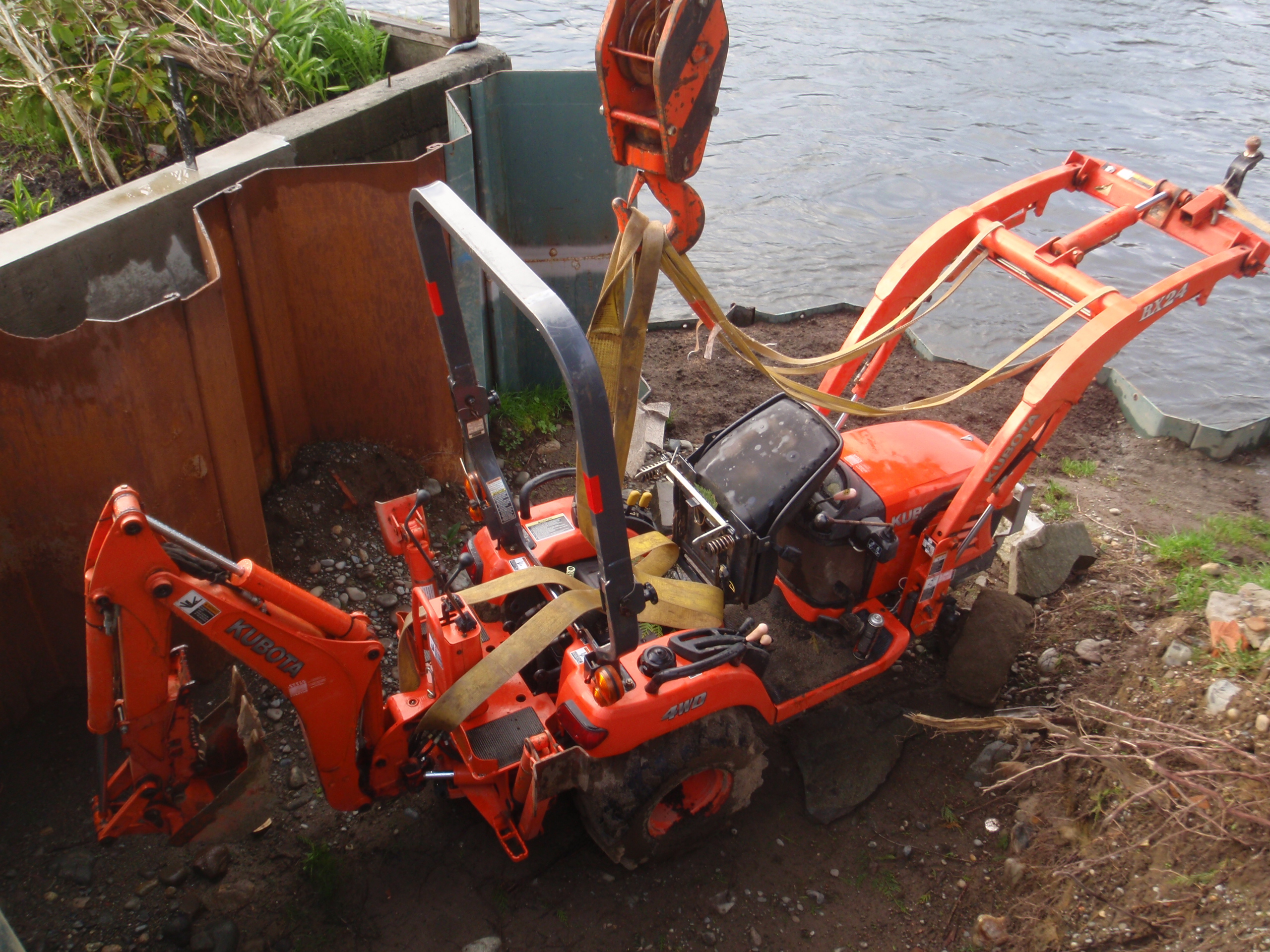

It's my crane. No worries about slings or crane operation. I was more curious about attachment points on the tractor.
I lifted it over the wall this evening. I picked it up by the BH pivot point and the FEL torque tube. All went well.
I had the FEL removed in the first pic. I changed my mind when I couldn't find any good points to sling it at the front.
Now I can dig the footing for my stairs down to the river! :thumbsup:

Good job and sweet crane.
From the angle of some of those pictures, it looks like your lowering it into the water.

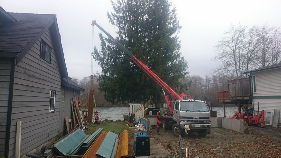

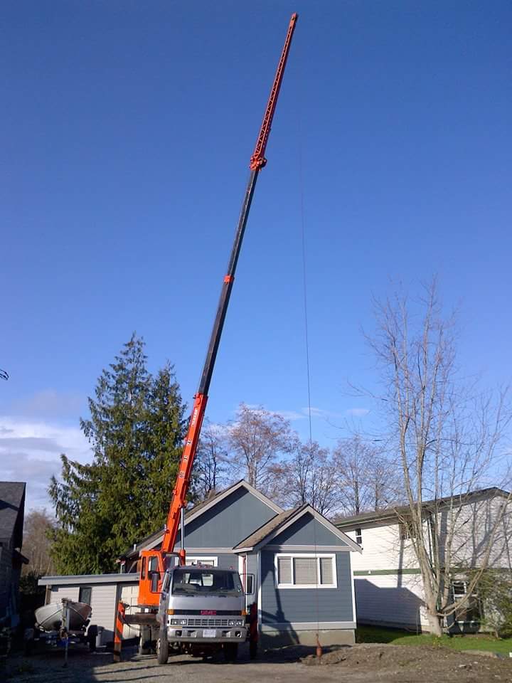

nice! how did it feel moving that bx with that crane size and whats it rated for? there is nothing like having your own crane.
   / Lifting Kubota BX24 with a crane
#20
It was a pretty stable lift. I'm rated for 7050 lb at that radius. I was originally planning to fly my 6600 lb excavator down instead, but I don't like to work that close to the edge of the load chart with such a precious load. The Kubota is a bit harder to maneuver down there, but it made for a really safe lift.
It's been quite a handy machine to have around. 70' boom length with the jib out.
