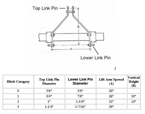

I bought a 2 bottom plow yesterday and I noticed the pins on the plow are a lot smaller then the ends of tractor lifting arm ends (BALLS ON THE END) IT'S. 3/4 MY TRACTOR TO 1\2 PLOW SO CAN I USE LIKE IT IS OR CAN I CHANG THE ENDS?.

/ lifting arms #4
Here are the dimensions for the lower and top link pins.
You can find lower and top link bushings at TSC (or similar ag stores).

Well the rain let up enough to get the tractor out and unload the plow from my pick up, as far as the dia. I need the plow holes are 1/2inch and my tractor are 7/8 the top link fits.
