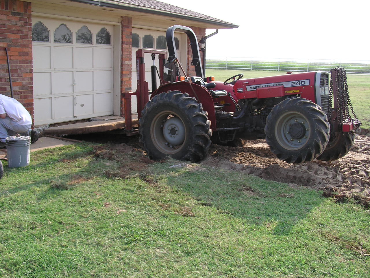

It should be no issue with the tractor. The 3 PH should withstand much more than the weight of the tractor's front end as used to counterbalance the load. Even if you have and FEL on the front OR loaded up with steel weights to the max per OEM recommendations, there should be no problem with the 3 PH.
When the front wheels come off the ground, that will be your balance point so be really careful driving around with a light front end. The 3 PH lift should be strong enough to do that all day long without the need to jockey with the top link. I have lifted lots of loads with all kinds of tractors that made the front end light and never damaged the 3 PH.

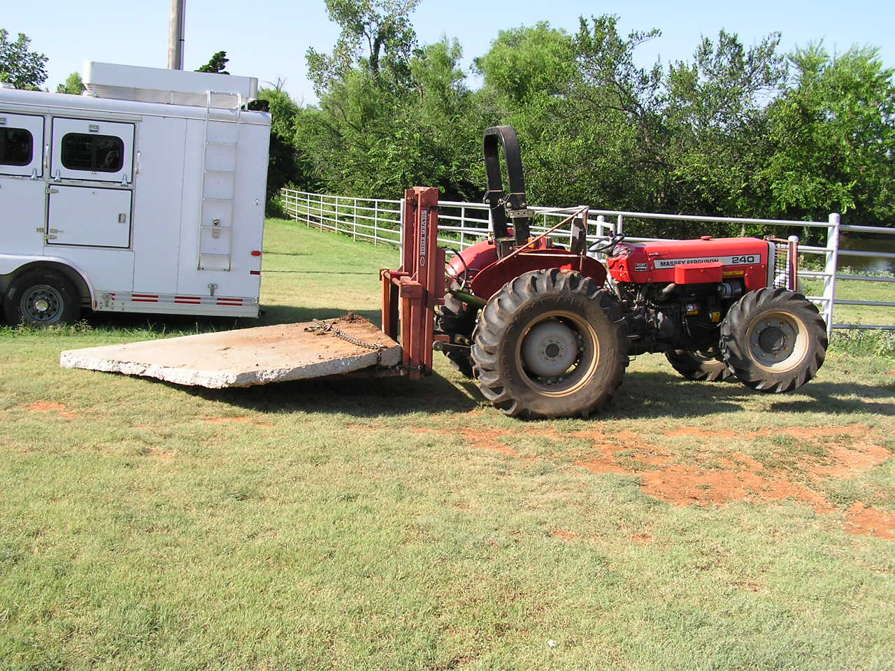

That should work. I had a hydraulic top link on a forklift that often overloaded the 3PH.
All 4 tires were loaded.
   / Lifting An Overweight Load with 3 Point Hitch using TNT Top Cylinder.
Looks like you might be steering that Massey with the wheel brakes.
   / Lifting An Overweight Load with 3 Point Hitch using TNT Top Cylinder. #7
Yep, did that a lot.
