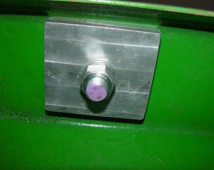

Here's what I did
   / Lift Hooks On A 200CX #5
On the under side

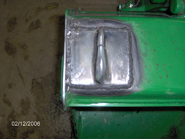

Andy, this is the way that I put hooks on my bucket, this pic is before painting. I sure does make your stomach feel alittle sick to grind off all of that expensive paint on a new tractor /forums/images/graemlins/crazy.gif but I've only had these on for a week or so and have already used them several times. Well worth the sick feeling /forums/images/graemlins/smile.gif
Larry

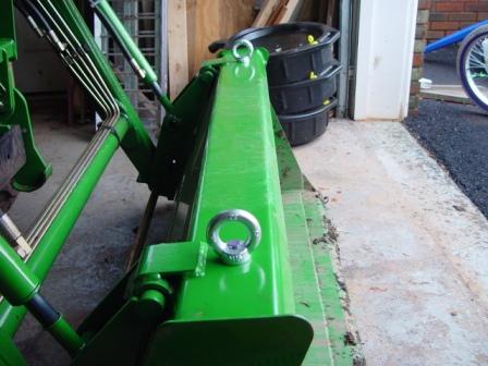

Here is what they look like all painted
Larry
