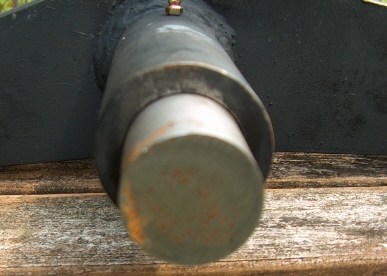

A little background. I noticed when using the mini hoe that the pivot center pin was starting to leak grease on one end (not the middle). I kept using the mini hoe on a major project but called a welder to weld the crack on the end. This helped for some time but again after using the mini hoe for a number of hours that this time I was gettiing grease out of both ends of the center pivot pin.
As I was unable to get the pin out, I sent the entire lift arm assembly to Tazewell and they repaired with a heavier center pin and so far I have not had any problems.
PJ
/ Lift arms #5
Shows broken center pivot pin, both sides.
PJ

Yes, That is where mine was starting to giveway before i welded it. Some time when you get time send us some pics of PT's repair. All i did was reweld with several passes. I guess we'll see later on how long my repair works.

Not a difficult repair! You can grind out the old pin, but have a good welding shop properly weld the new pin into place!
Power Trac has beefed up the toggle!
