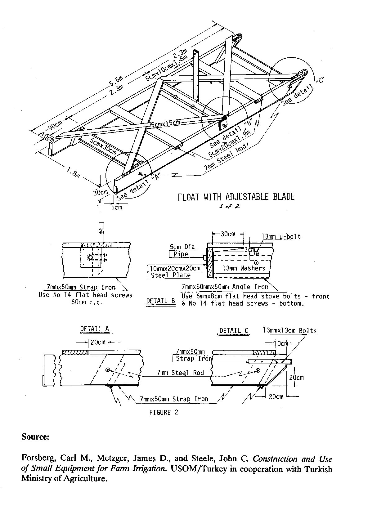

Irrigated land used to be smoothed with large wooden "floats" after disking. I think they were about 4x12 material, with all the bottoms steel sheathed. They were about 10-12 feet wide, maybe 20-30 feet long. Three cross pieces, with the front and rear at about a 30 degree angle, and the center one vertical. Steel rod diagonal bracing.
All I could find online was a plan for a much smaller one.
Bruce

Hi Bruce,
Thanks, that's an awesome illustration that will be going into my archive for future reference when I start "trying to make myself a land plane/grader.
Rutwad, hang in there, you will get this figured out and the basic materials you are working with (those rr rails) are so heavy duty that once you get it dialed in, it is going to really an amazing piece of work, given that everybody always says that with these implements weight is key to performance.
