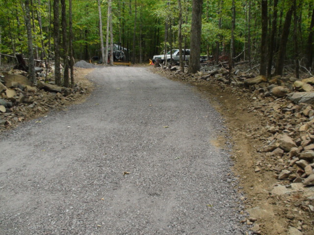

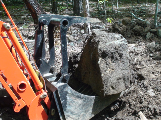

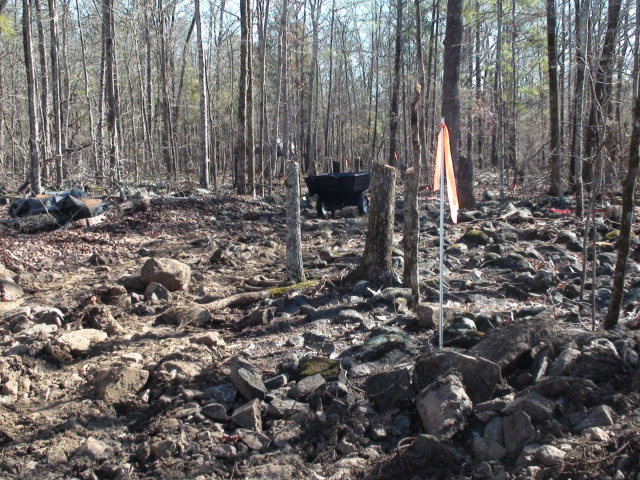

I just did similar on a small scale while clearing a new driveway through densely wooded, small boulder encapsulated at depth, heavy clay soil. I also had large holes from digging out stumps (~ 4' to 8' x 4' x 4' or so) and quite a few large, buried rocks. The FEL was taxed daily and many times the 700# ROBB and 100# tool box on the rear were not enough counterweight. I did mine in stages:
- Fill in the large holes with material using the FEL bucket and ROBB
- Next use the ROBB's shanks to loosen up the soil in the entire area
- Finally use the ETA landscape rake (with wheels) to level everything out
It all came out very nice and smooth. See before and after pics attached.

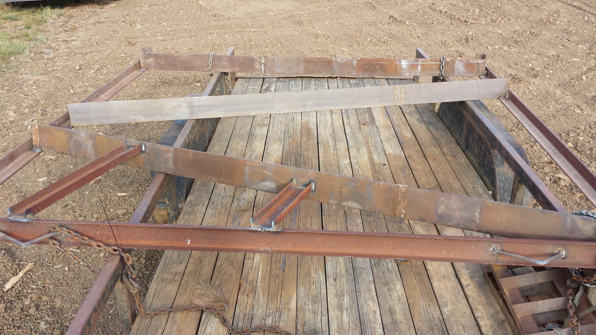

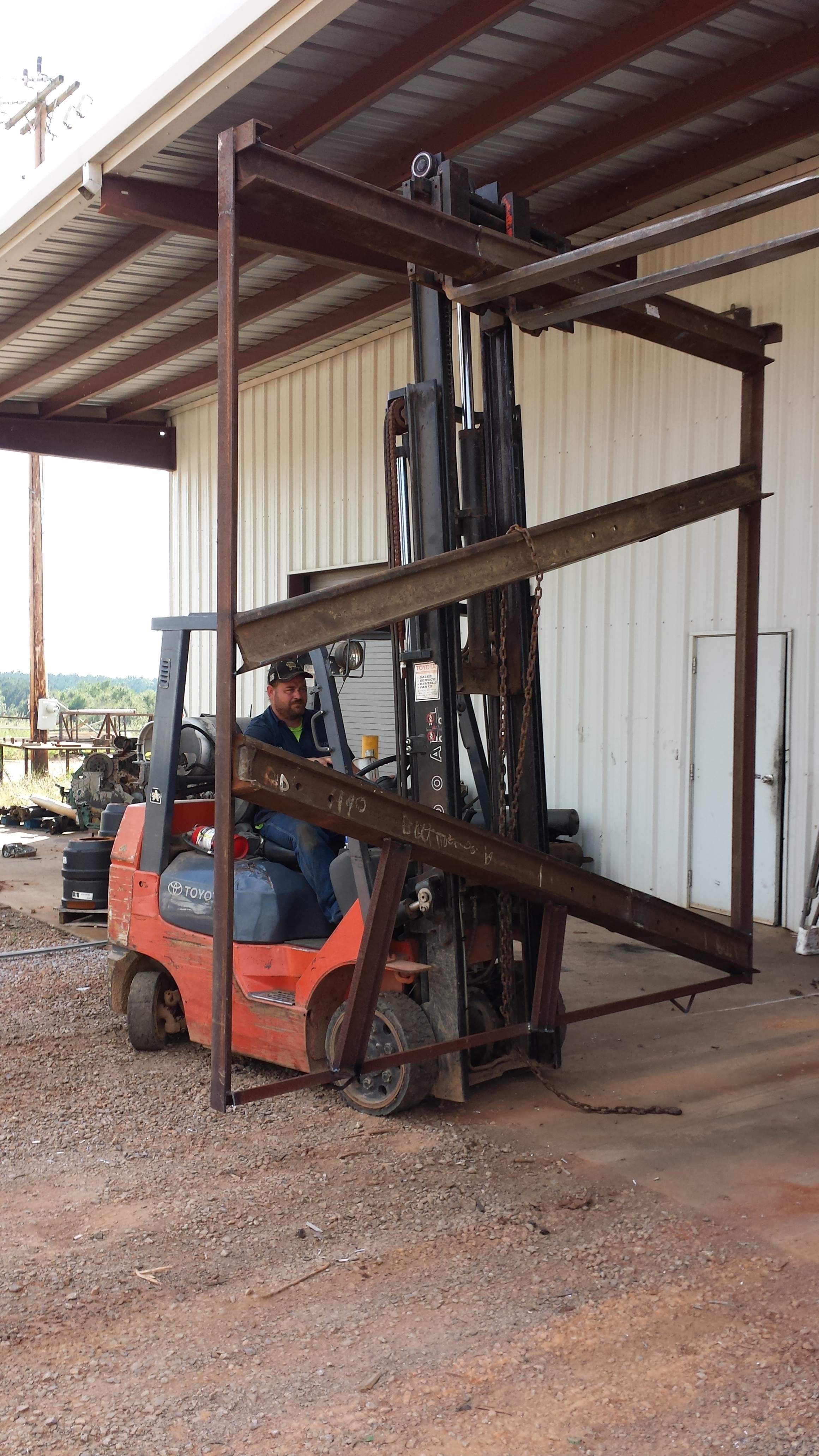

Well here is a rush build. It is pulled with the first blade angled, 2nd blade angled in opposite direction, and last blade is straight across.

it looks wimpy, add some fat to it,, errr some weight to it! if ya don't i am guessing it will hip hop and dance around on you. and never do a thing for you. it might level soft disc'ed ground, but digging down some into the softer dirt, and bring more of a load with it....
add some pegs (rebar) on the top, sticking up, for either concrete blocks, or some metal pipe, or some logs, what ever ya have laying around for added weight, and you think you can move easily, by yourself / man handle. without use of a tractor to remove / add the extra weight while out and about. bailing wire / fence wire can be your friend *arghs* some times it can be my worse enemy as well!
be prepared for roots / twigs getting hung up, and needing to clean the stuff out from under it. *arghs* that was not a fun task.

It weighs about 1600 pounds. Quick build and needs tweaking, I had thought about RR spikes welded up so it can be dragged as is or flipped to use spikes.
160lbs? i might bite but 1600lbs?
i just realized you have it chained to the trailer *uth oh* planning to tip the entire thing up side down when ya get to were ever? ok 1600lbs!! wow!!
i could see the RR spikes as well. ya just might loose some though. i am not seeing how you could get that much weld beads on them, and keep them from bending/breaking off. i would think you would loose to much of a spike length just from welds to keep them held on? *looks confused*
