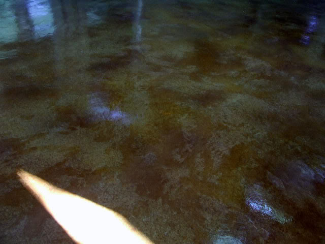

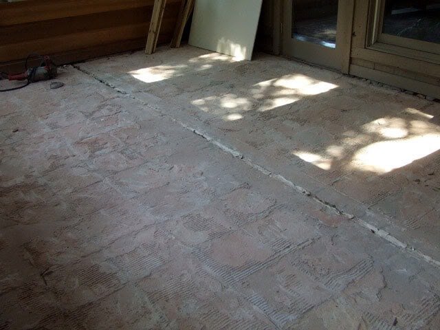

On this former patio floor, I used a product from Mapei Products to bring up the low side 2" in 10'. It's a non self-leveling polymer modified cement product. You can start from featheredge and build up to 3" thick. I think you'd be OK at 4" by adding aggregate to the mix.
I also cut, rebar stitched and repaired a section that used to be a wooden expansion joint using epoxy injection. I removed the baseboard, and used Deck-o-Foam DECK-O-FOAM Expansion Joint Filler - W. R. Meadows to separated the pour from the wall. I used a diamond cup grinding wheel to antique the smooth finish, then acid stained and sealed it. When it was all finished, I put the baseboard back in place and added a piece of quarter round to hide the foam.
Here's the before and after pics.

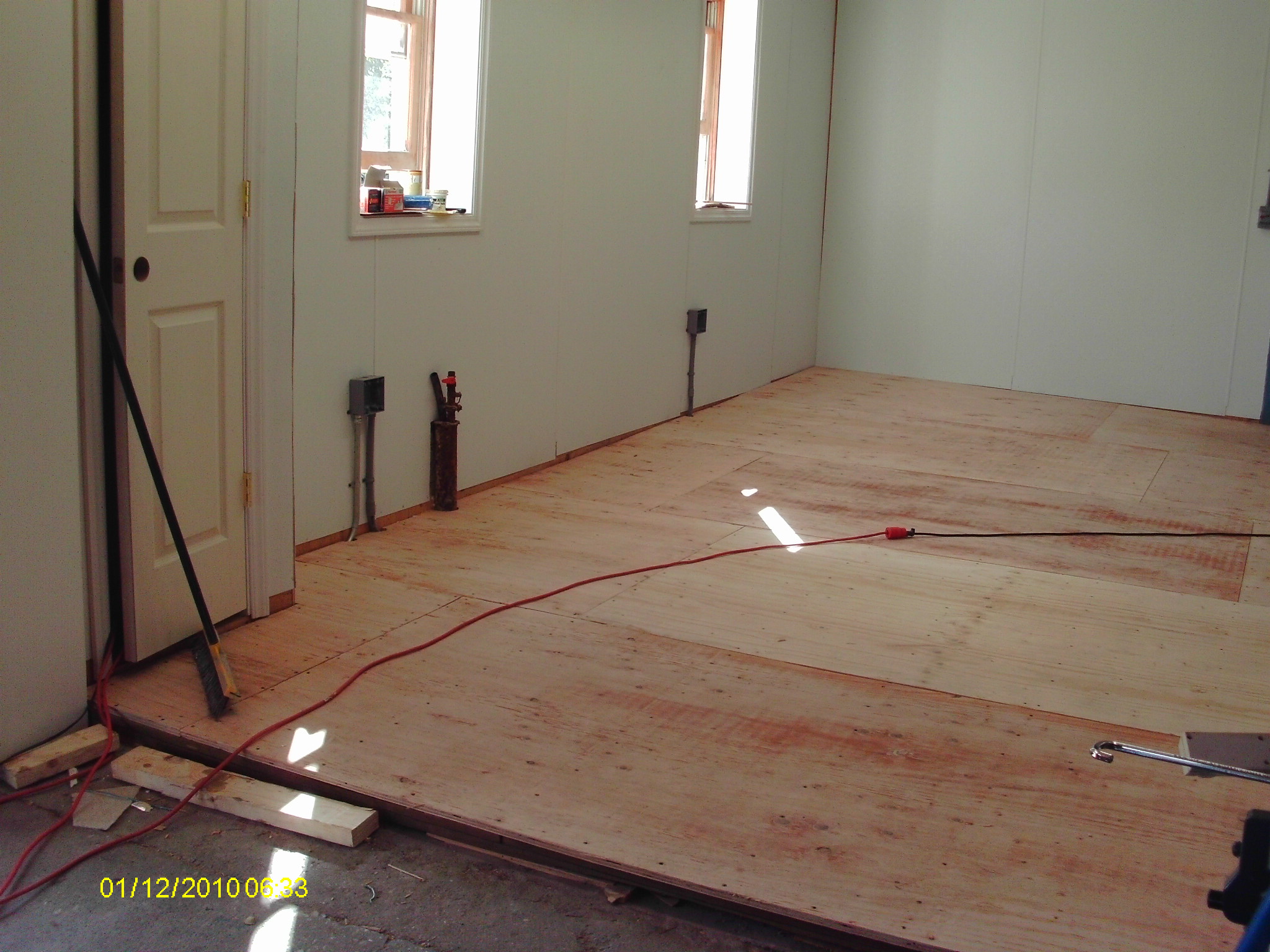

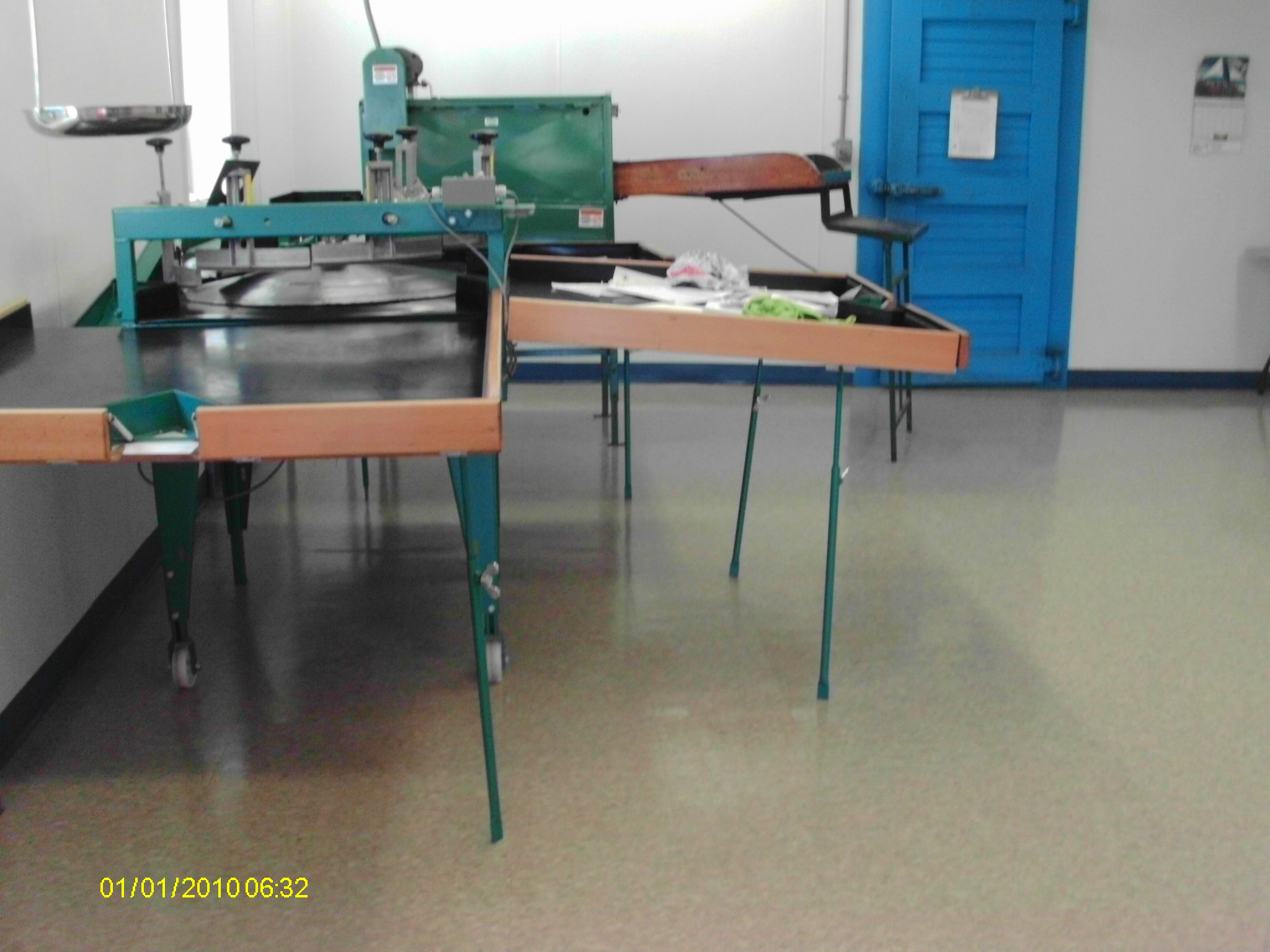

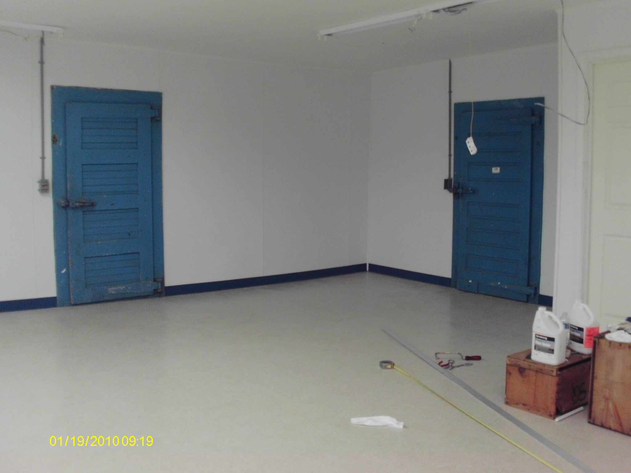

Yup I would go with PT sleepers shimmed and leveled over the concrete. That's what I did down at the orchard when we had to meet the new food grade standards for food processing. Also fit rigid insulation under the plywood floor so it hopefully wouldnt be as cold as it was standing on the old concrete for the people working there all day. The old barn floor was formed with a pitch better than 2 inches over 20 feet run...it that led out towards a big overhead exterior door. And was so rough it looked like it hadn't even been troweled off when it was poured. I had similar problems with existing gigantic insulated walk cooler doors. They couldn't be raised or cutoff either. What PITA. The doors dictated just what I could do. Originally we discussed using concrete levelers but this is what we ended up with. Overall it came out good and held up well in a commercial setting. No sag or movement and they load up to around 3 ton live load/dead load sometimes. One day I walked in there was like 100 40 lb crates of apples, 8 people and the machinery. I was shocked :shocked: They're rough on that stuff!
