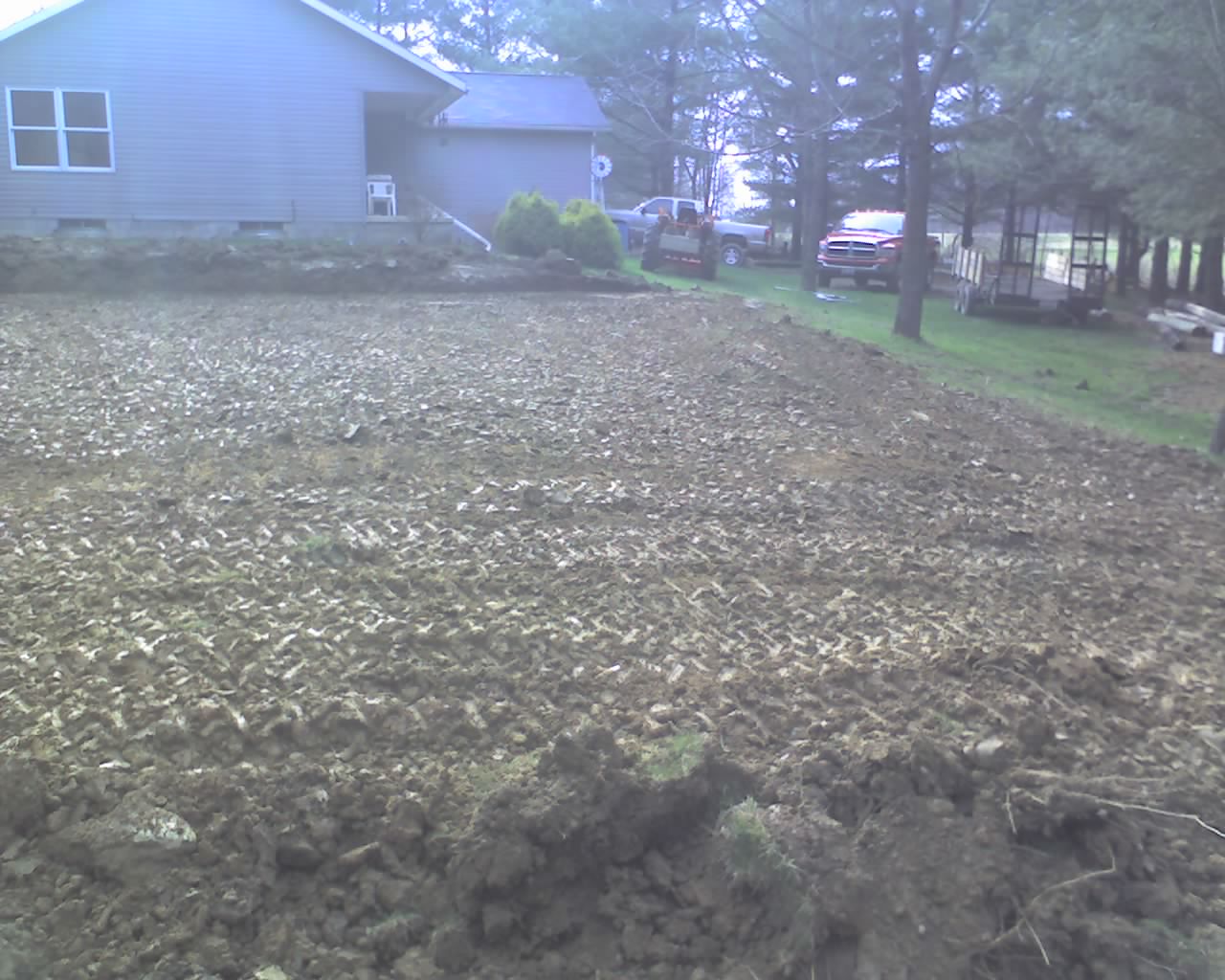

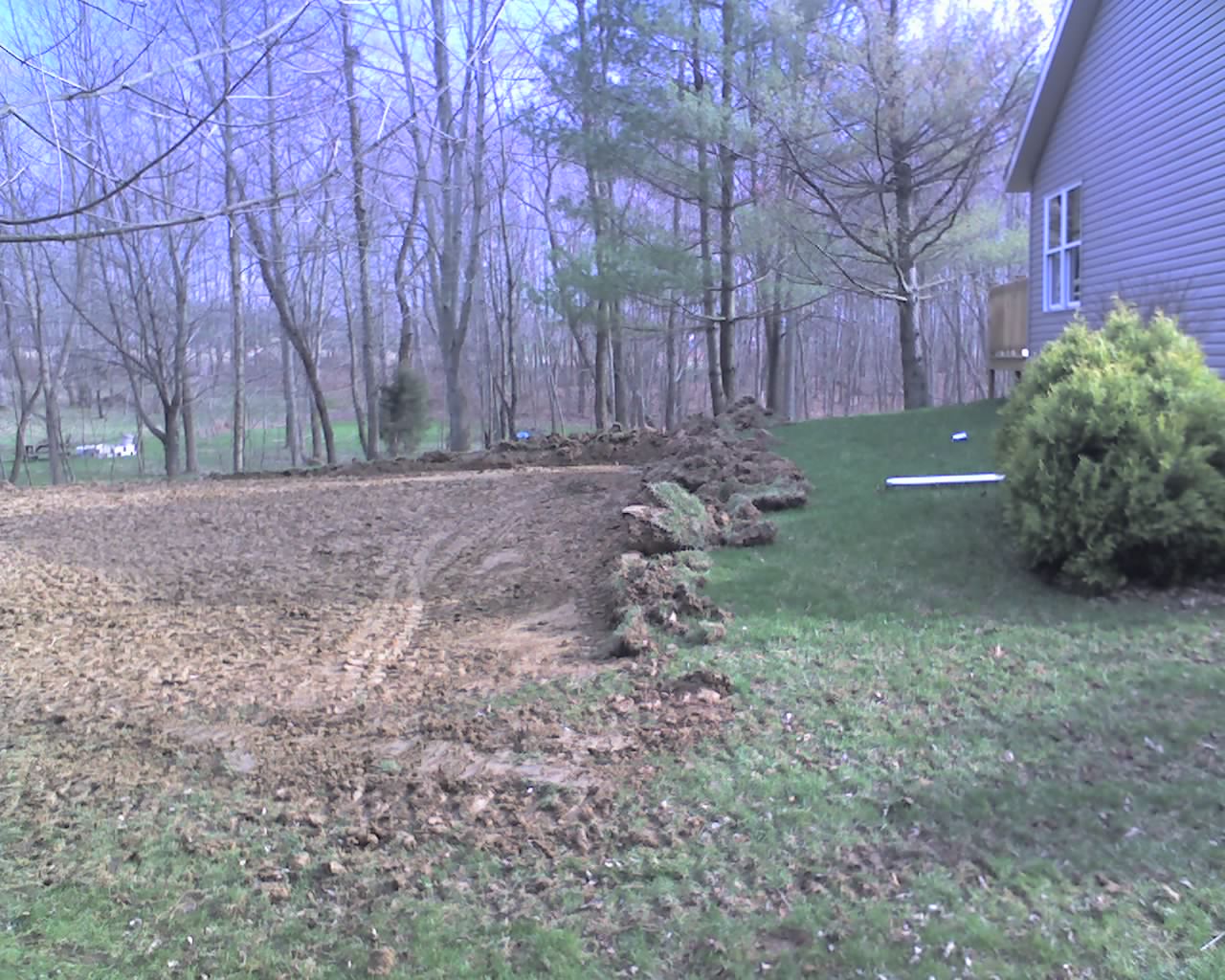

I need to level a site for a new pole barn. I need to cut 40" and fill 40" over a 50' run.
Can this be done with a 33 HP compact tractor? What would be the best attachment?
Cutting will be into clay. I'm considering a box blade. Thanks.
