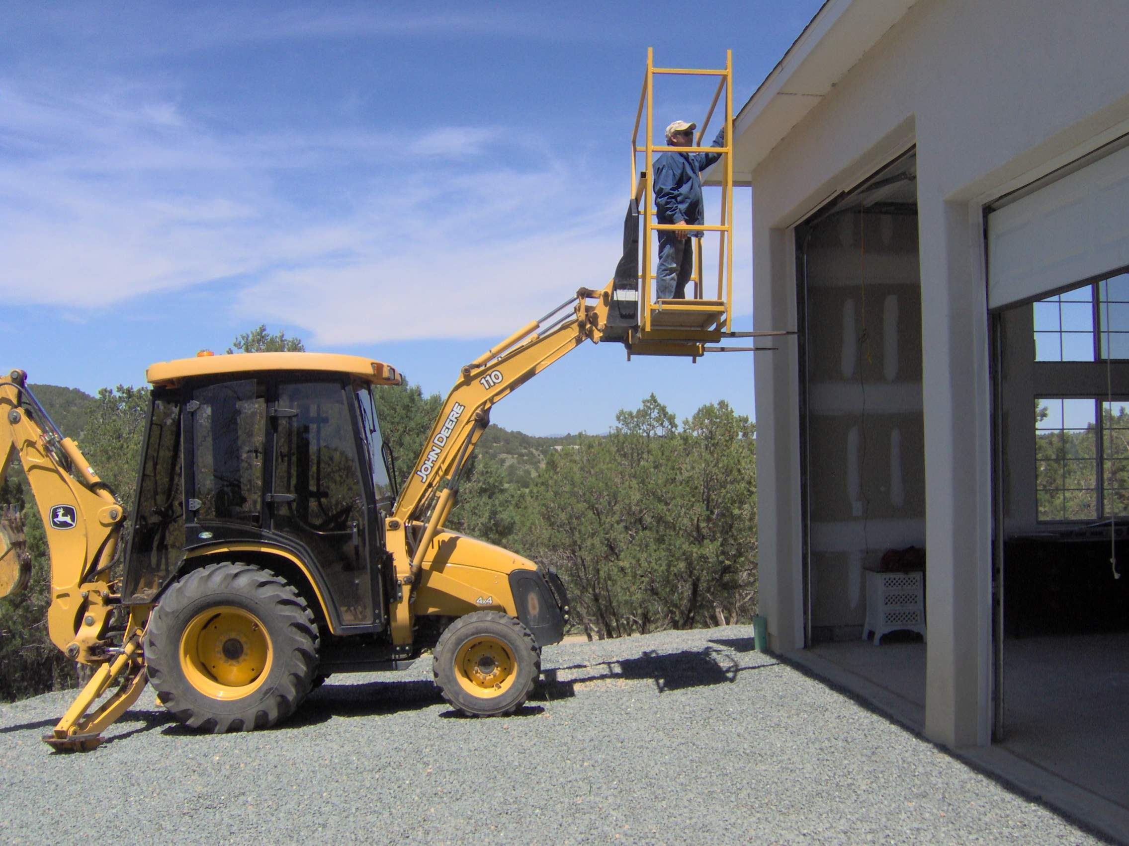

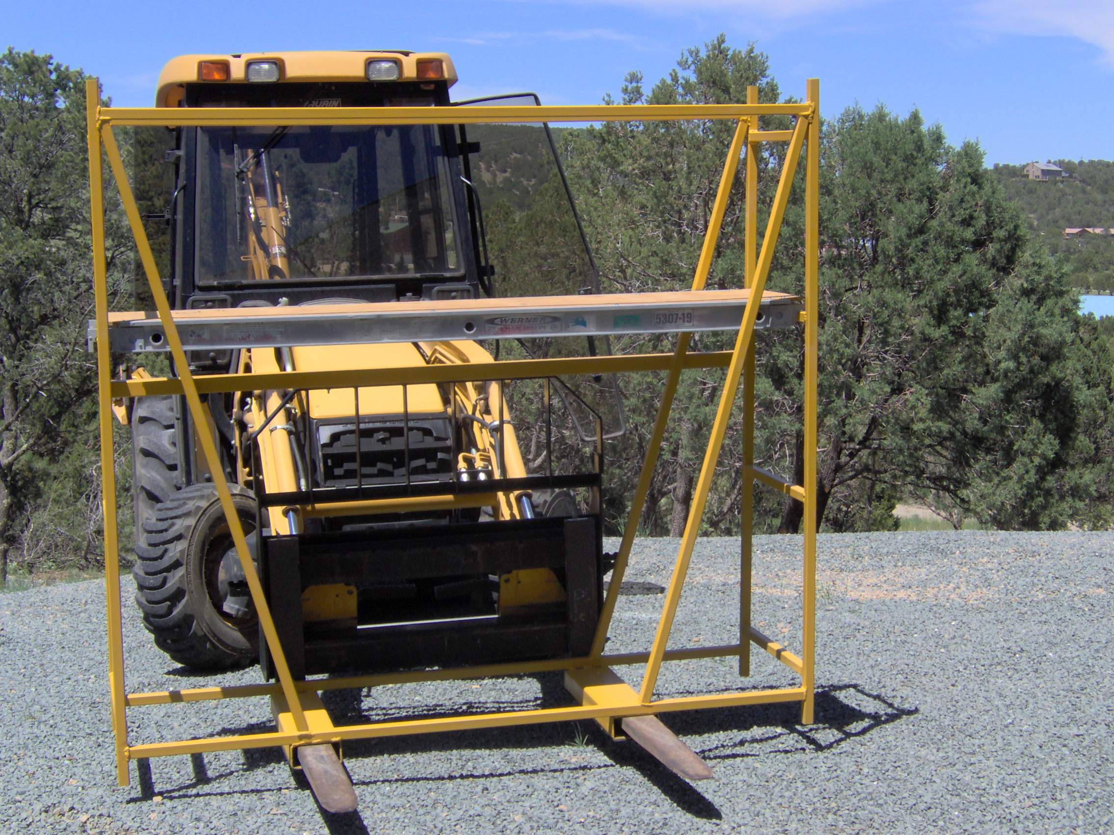

Do you have a lift of some sort to get the top cross member in place? I built this simple man lift that sockets to my forks and has several heights to set aluminum scaffold boards. Just some ideas to get this project done.
