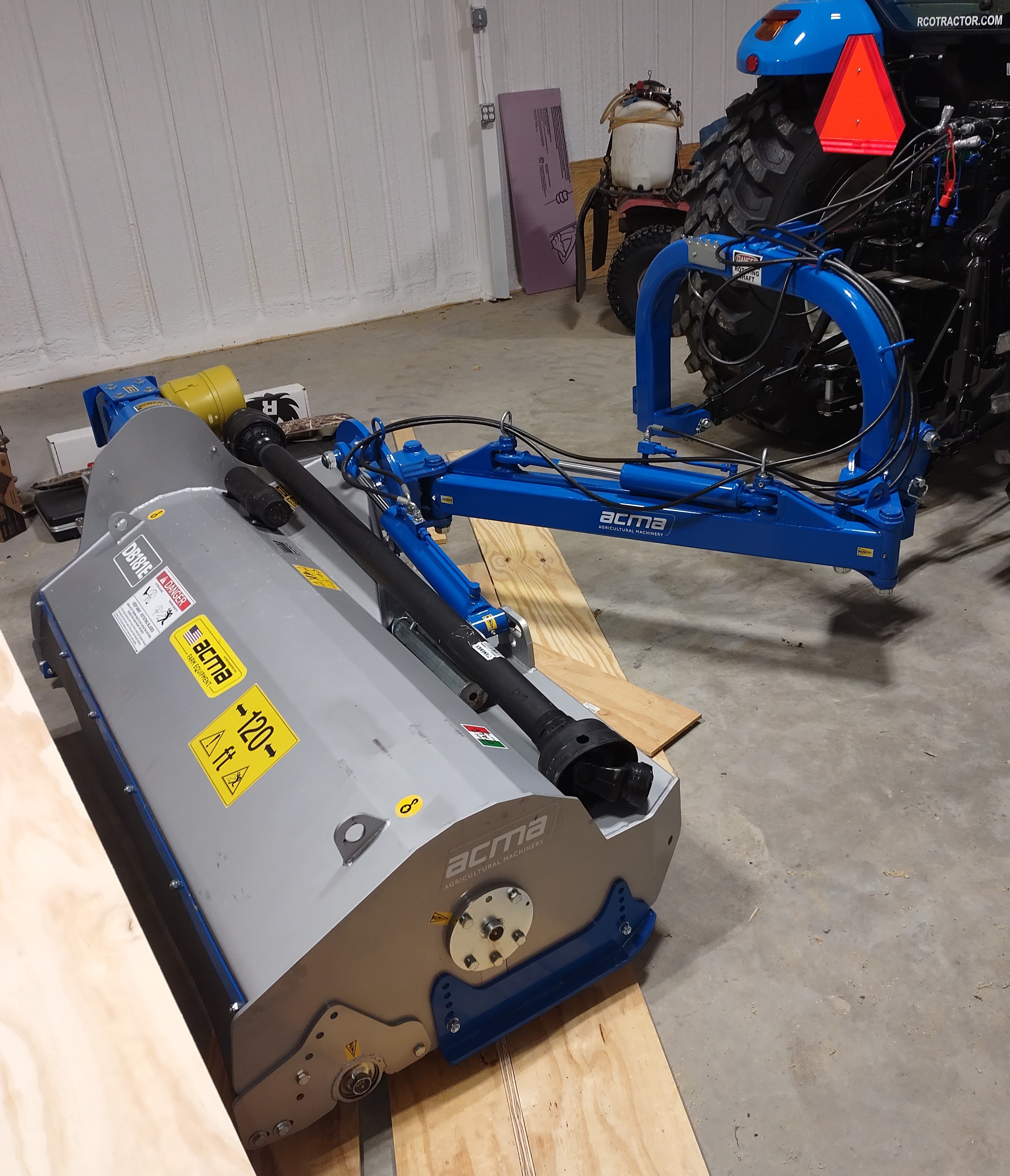

Yes, I own a Acma flail. Bought it from Iowa Farm Equipment. (during Covid) It's made in Italy.
You will be pleased with the build quality.
Yes. I paid for shipping to my farm, and the truck driver even helped with the unload etc.
After using it a couple of years I had a problem with the roller assembly. It was out of warranty.
However, the bottom line is, IFE contacted the manufacturer and got it all covered.
They could have given me the "song and dance" but they didn't. They returned my calls or texts
promptly. I believe they treated me fair.
After looking at some of the other, cheaper flails folks have purchased, I'm satisfied I bought
a unit that was suited for my needs. Btw, it comes greased, oil in gear box, and ready to use.
Pic of my unit when brand new.
