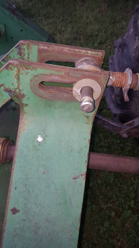

My 25A has a fore-aft sliding pin slot at the top link. Not directly QH compatible. Not sure of the S/N, but it has the later model 6 bolt type rotor bearing housing; same as my 390. 390 is CAT2 and QH compatible, but 2x the weight of the 25A.
Edit: With the top link all the way forward, looks like it may work with a QH. But you won't have the slider capability. S/N is 642971

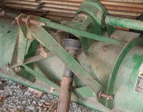

Here's the one I'm looking at

doesn't look like your top hook will slide under the top pin but the yoke adapter mentioned above would work. doesn't look like it would be too hard to extend the pin hole out a little so the top hook clears that bracket under the pin hole, If you can weld.

This pic looks like the top pin has already been modified once with a blue wrench. And the rear stays appear to be tubes. Definitely different than my 25A.

Heres a pic of mine. The front uprights on your pic are made from angle, mine are a wide flat plate. On mine, the QH top hook can get under the pin if it is all the way forward
