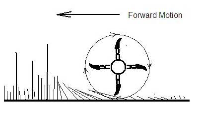

Well, I can't see the knives from here so it's hard to tell which way they're suppose to rotate. :confused2: You also didn't say which way it's rotating now. :cool:
Mine uses the "folded spoon" style knives. When the knives are hanging down, the cutting edges face the front. This is because mine rotates back to front.
Both my JD25A and JD390 rotate in same direction as tractor motion. (Opposite of image)
