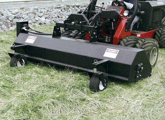

The red machine with the gray hyd flail is what I have. It has the Y type blades and will cut up to 1/2 in. The blades are thin and does a good job on grass., otherwise a finish cut

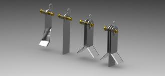

Here are some flail mowers blades. You can not interchange the heavy duty blades with small Y type as the larger blade rotor has fewer hangers. The heavy duty blades will probably do up to 2 in.
