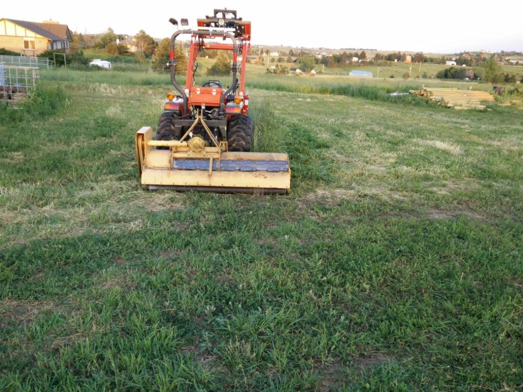

There have been about a dozen flails on Craigslist in the state of Colorado in the past 3-4 years. Most were crop choppers too. So depending on where you are, they've super uncommon. I've never seen one at a dealer & most dont know about them.
I paid $100 for my 917, but it was beat to ****. Made for a good learning project & gave me several years of good service before it got retired. $600 in total for the flail, new PTO shaft, new flails, belts & rotor bearing replacement. Not to mention a pile of welding on a cracked bent hood. I still keep it as a spare for the new Peruzzo or when I have to mow a trashy rocky field. Much less concern about destroying the $100 mower vs the $7k one.
And the mounting bar on the rotor isn't as crooked as it looks. It's actually a lot worse. It's not smooth, but it surprisingly not bad for as beat as it is.View attachment 619106 IMG_20150613_203410.jpgIMG_20150626_200320-1.jpg
