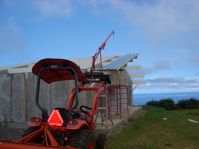

I did that as well. Mostly to mount the 3 point boom pole w/ extension when we were building the house. Hitch didn’t weather well so I’d like to remove from quick attach plate and remount a new hitch. Found the landscape rake quite useful mounted in place of FEL
David, is this the adapter you've got for your FEL?
Adapter To Convert Full Size Universal Quick Tach To Quick Hitch 3 Point Cat 1,2
I've also been looking at this one too.
3-Point Attachment Adapter for Universal Skid Steers, Quick-Attach Equipment

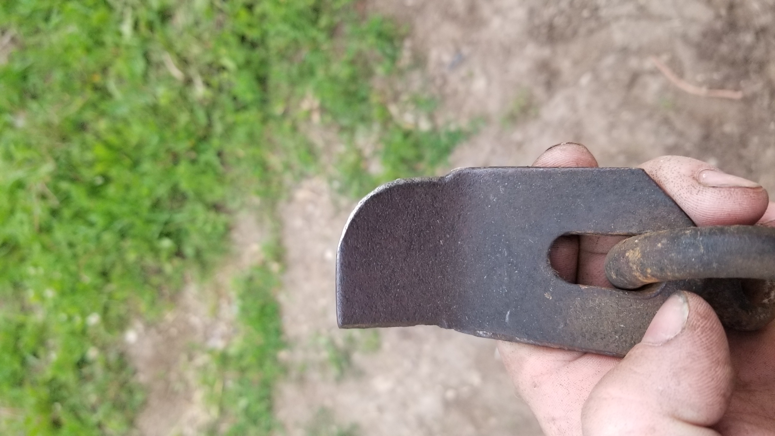

Apparently blade maintenance wasn't a priority for the Illinois Tollway mowers...
I think that's typical for any Government usage. I bought my Alamo SH88 at auction (Maine Turnpike Authority unit) and the blades look exactly the same as yours. Which new blades did you go with from Flailmaster? I'm trying to decide between the "Extreme duty" and the "heavy forged". I've got lots of ledge and boulders I zing over. Also thinking about getting rid of the clevis and cotter pin and going with the bolt and nut: just seems like it'd be a lot quicker.
