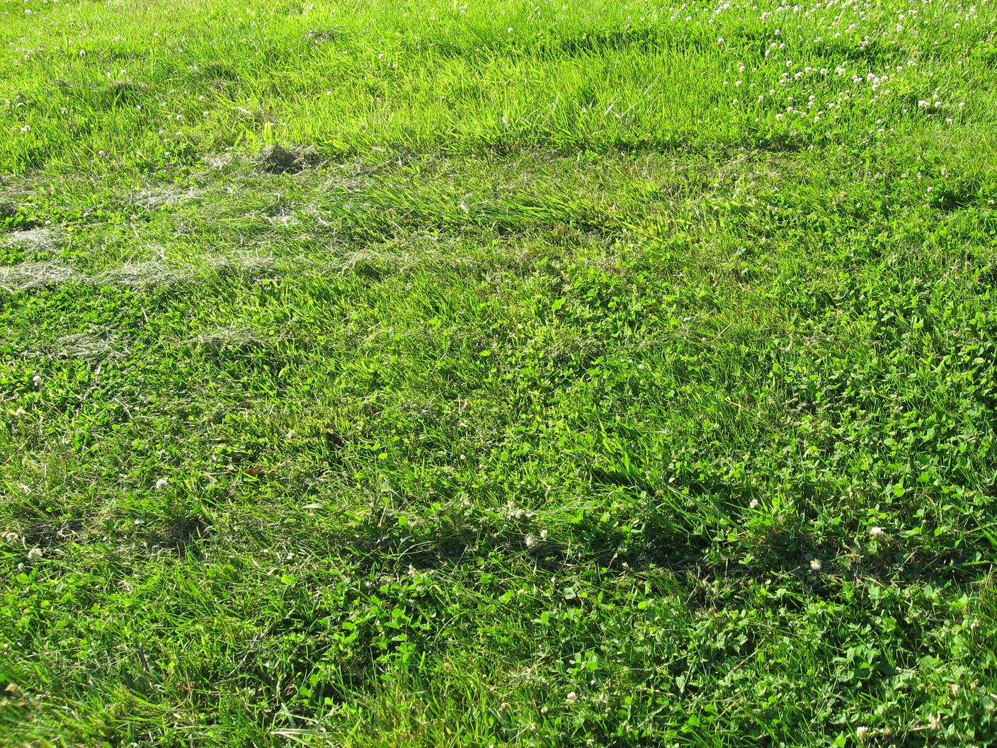

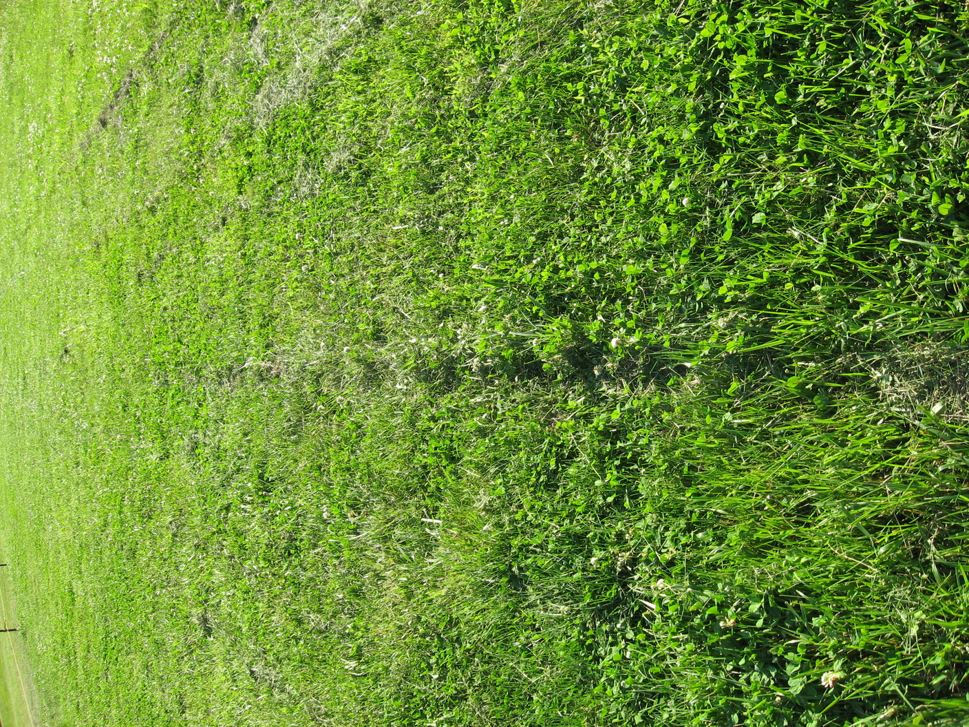

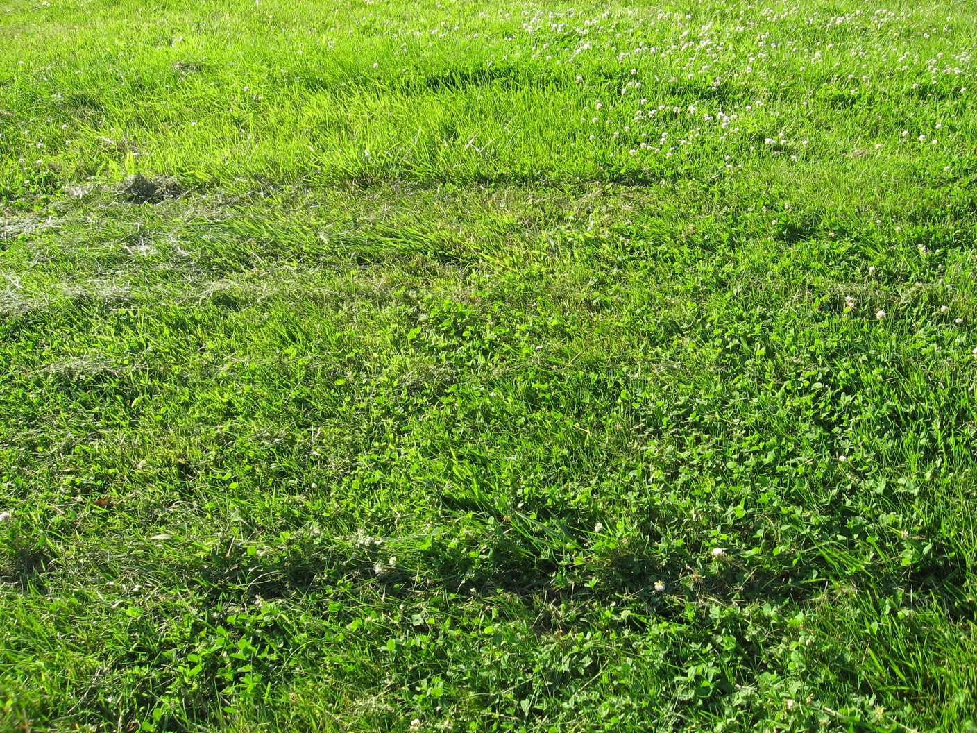

Finally got to see if sharpening the slicers helped the 918H and I am sad to report it made no difference at all. I went though all 96 slicers and turned the best side toward the direction of cut and sharp enough to shave with. If I make two cuts, one going each direction it will cleanup the tire track but what good is a mower you have to cut the same patch of grass twice to get it to look right. Here are a few pics showing what it is doing, grass was cut one week ago, well 8 days because of rain and as can be seen not deep. Iwant to like this type of mower but right now the disappointment factor is nearing the end of the scale.

Since lawn is what you are cutting, you probably should get scoop knives. Side slicer are decent enough for both rough and grass, but not great at either. They also don't move much air. Scoop knives have a flat face, and cause a lot more turbulence under the mower, which helps to stand the grass up to be cut. What time of day did you mow? Looks like a nice flat piece of land. Must not be near me.
