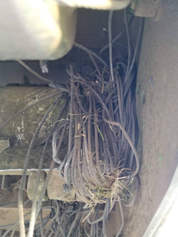

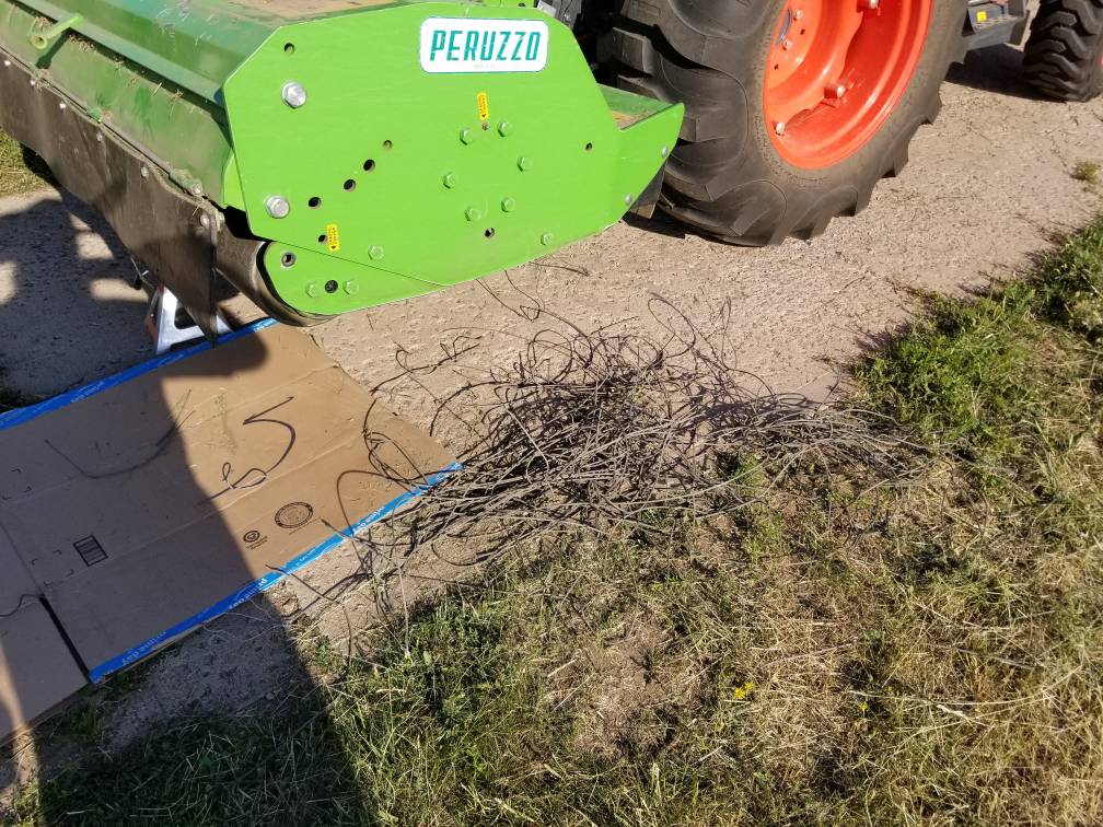

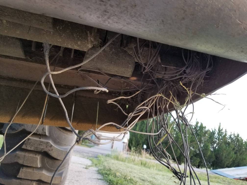

I picked up probably 2 feet of high tensile steel wire. Thought I got it all out last fall. Came to get the mower ready to go this spring and it wouldn't do a **** thing. Ended up tearing it all the way down to the the point I could take the main rotor out, sure enough, somehow ended up with wire inside the rotor, wedged up against next to the bearing. Much fun was that cleanout.
I raise you maybe 100' of high tensile strength wire rope. My bolt cutters couldn't cut it as it squished a bit. That was not fun to get out. Thankfully there was no damage to the mower beyond paint. 20180718_192936.jpg20180718_191806.jpg20180719_175911.jpg
