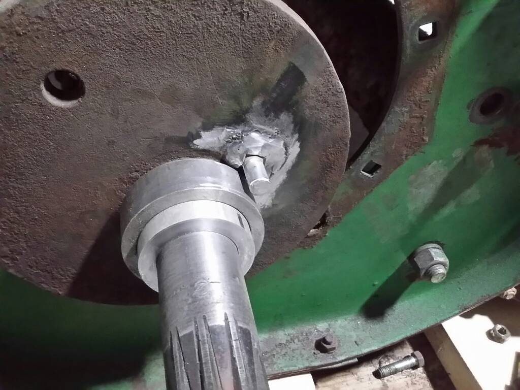

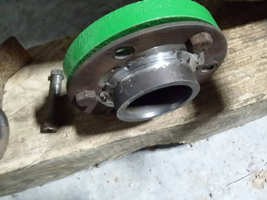

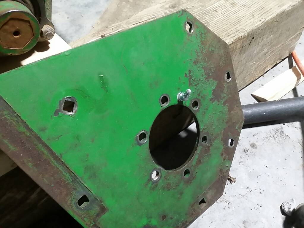

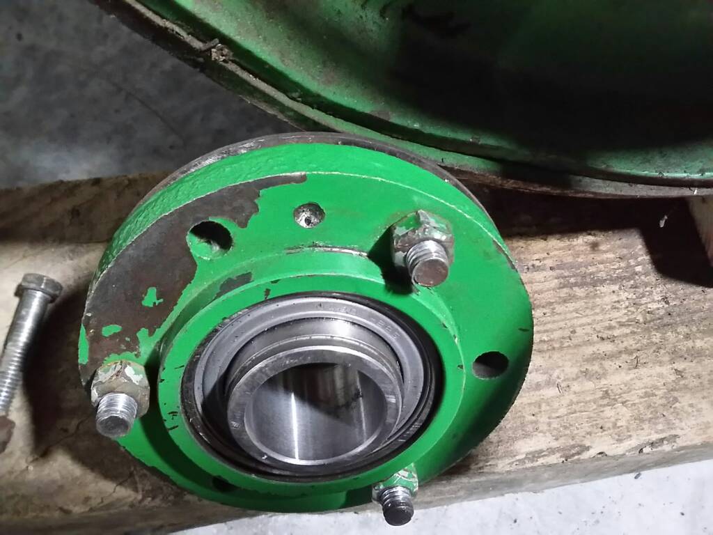

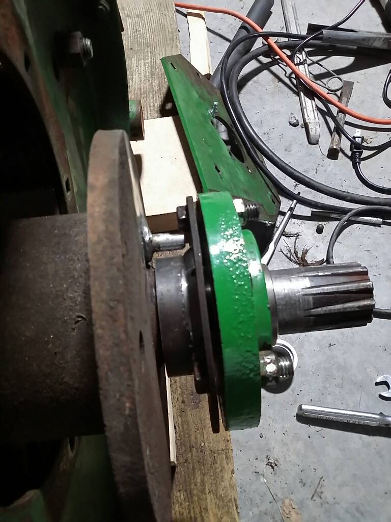

Here are the pics. Worked tonight. 20190127_180506.jpeg20190127_181725.jpeg20190127_181828.jpeg20190127_181817.jpeg20190127_181756.jpeg
   / Let's talk flail mowers #5,674
Aluminum sleeve is used to center the collar to the shaft to set clearance to the stub. Collar is welded to the original 6 bolt flange plate. I used thick washer spacers to ensure the collar assembly doesn't allow water into the bearing. Clearance between collar and stub is about 3/32". I wound up welding the bolt heads to the 6 bolt flange as well. I also had to grind the stub a little for clearance to the bolt head.
Can't see it in the pics, but I fabricated a couple jack stands that have iron swivel casters. The rotor is on the stands so I can move it around to weld or pull out from housing. I used similar casters to make a set of tractor jacks for splitting my JD 4300 to repair a broken HST control rod.

Thanks for those photos. I had thought of doing the same for both the rotor and roller on my Chinese fail. I have tangled with fence wire hiding in the field on several occasions. It takes some doing to free wire from a flail mower.
Your Zerk location looks a bit hazardous without a guard of some sort.

That zerk is inside the belt cover in the drive end. The other end is set directly into the thick side of the cast housing.
