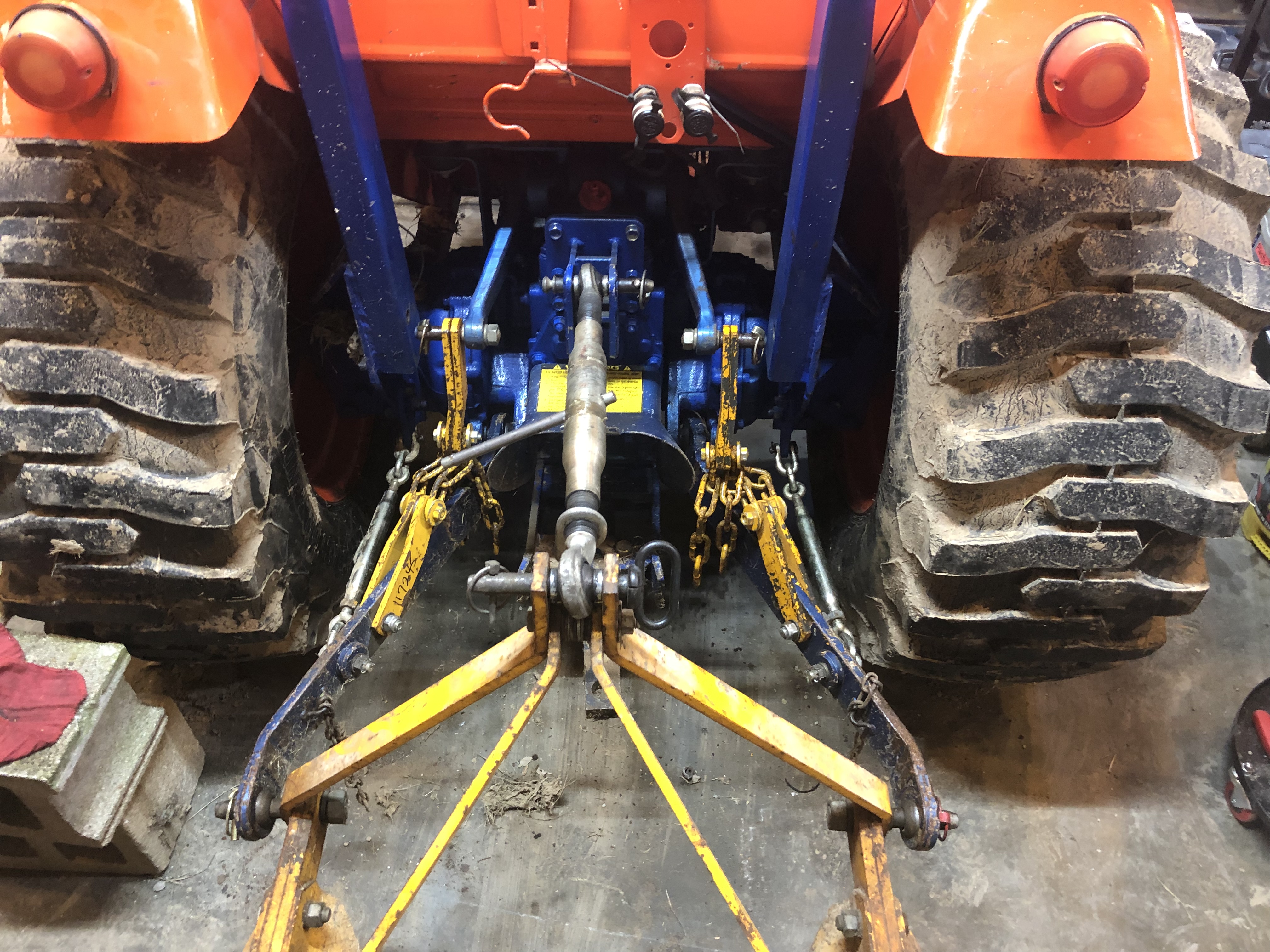

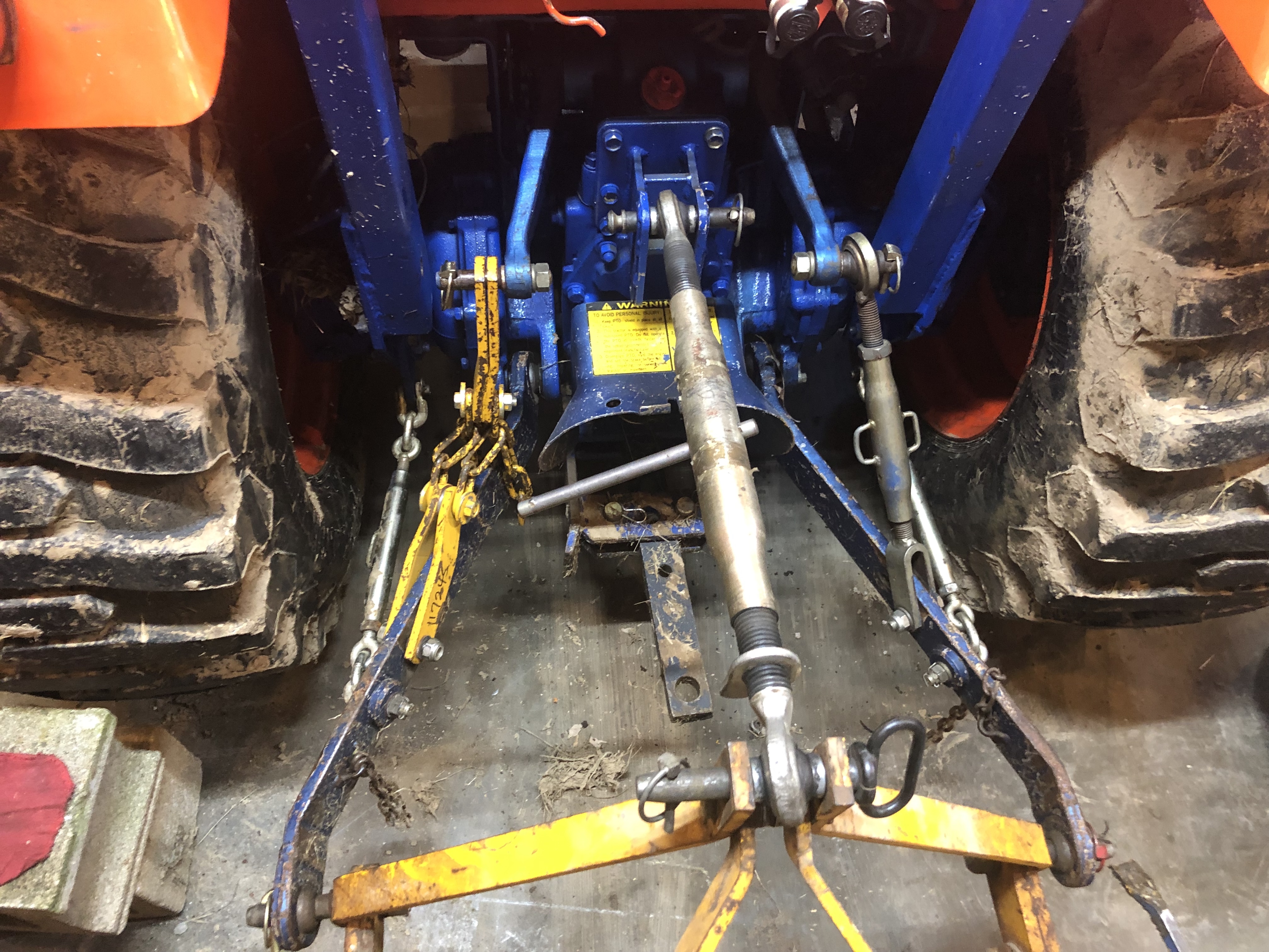

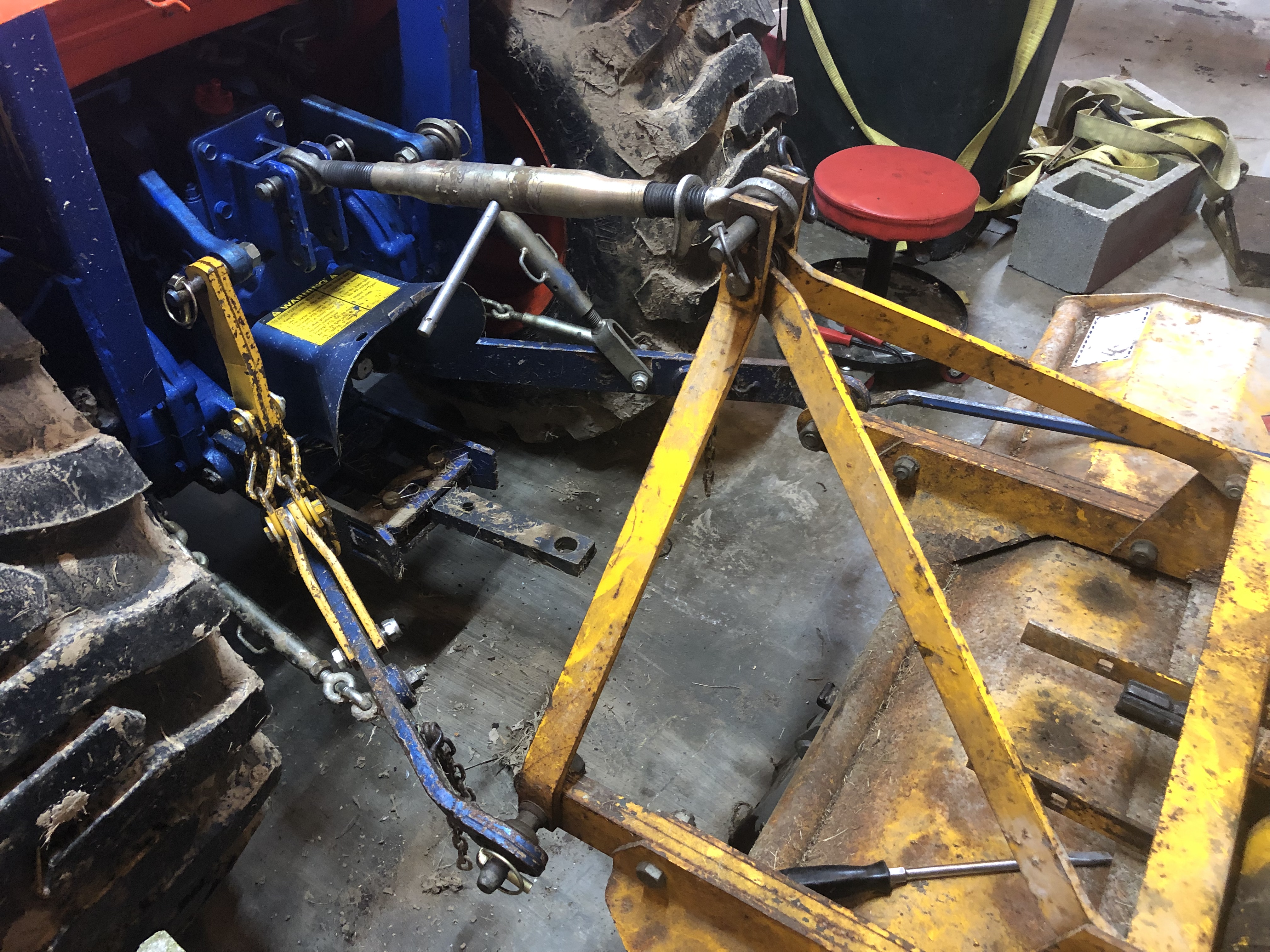

It is more that the one arm can float independent of the other so the mower can twist sort of independent of what the tractor rear wheels are doing.
Here is a picture of a pair on ebay.
A little modding to fit this tractor.
7AC0AD9E-C48E-4F8A-B03A-B8AE032A0DC4.jpegC7456234-A278-4AA4-B89D-B9156CF79B95.jpegE1AF19C4-37D5-464C-BE9A-F352B5770AD9.jpeg

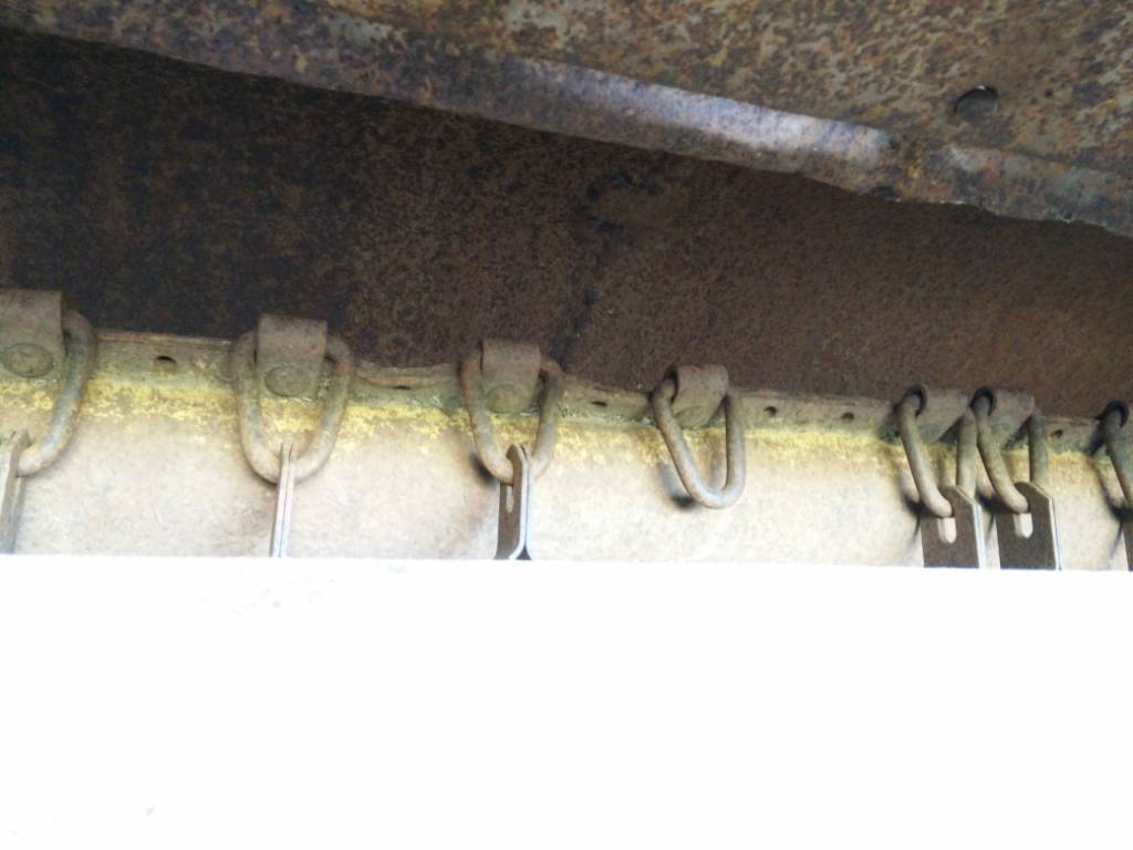

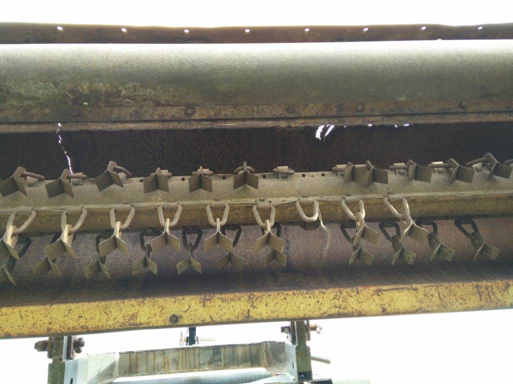

My old 917 hood looks like popcorn almost. Probably helps you figure out how I only paid $100 for it. But it worked just fine. I'll agree & disagree on the rotor. Ya, walk away from a bent rotor. I'll let you figure out how straight the mounting bars on the rotor are... There was a little vibration with a proper set of knives installed, but not enough for it to run fine for about 4 years. More noise & vibration came from that crack in the hook (no that's not bad pixies on the photo) I never bothered to weld up.
My new Peruzzo Brush Bull has a way thicker hood. I assume the Alamo would be similar while the Woodmaxx, Chinese & cheap Italians would be similar to the Ford's hood thickness. While lighter duty the Ford is still hanging in there after being well used for 20-30 years. A few dents wouldn't phase me at all. A lot wouldn't either if the price were right.IMG_20150529_181633-1.jpegIMG_20150527_183158.jpeg
