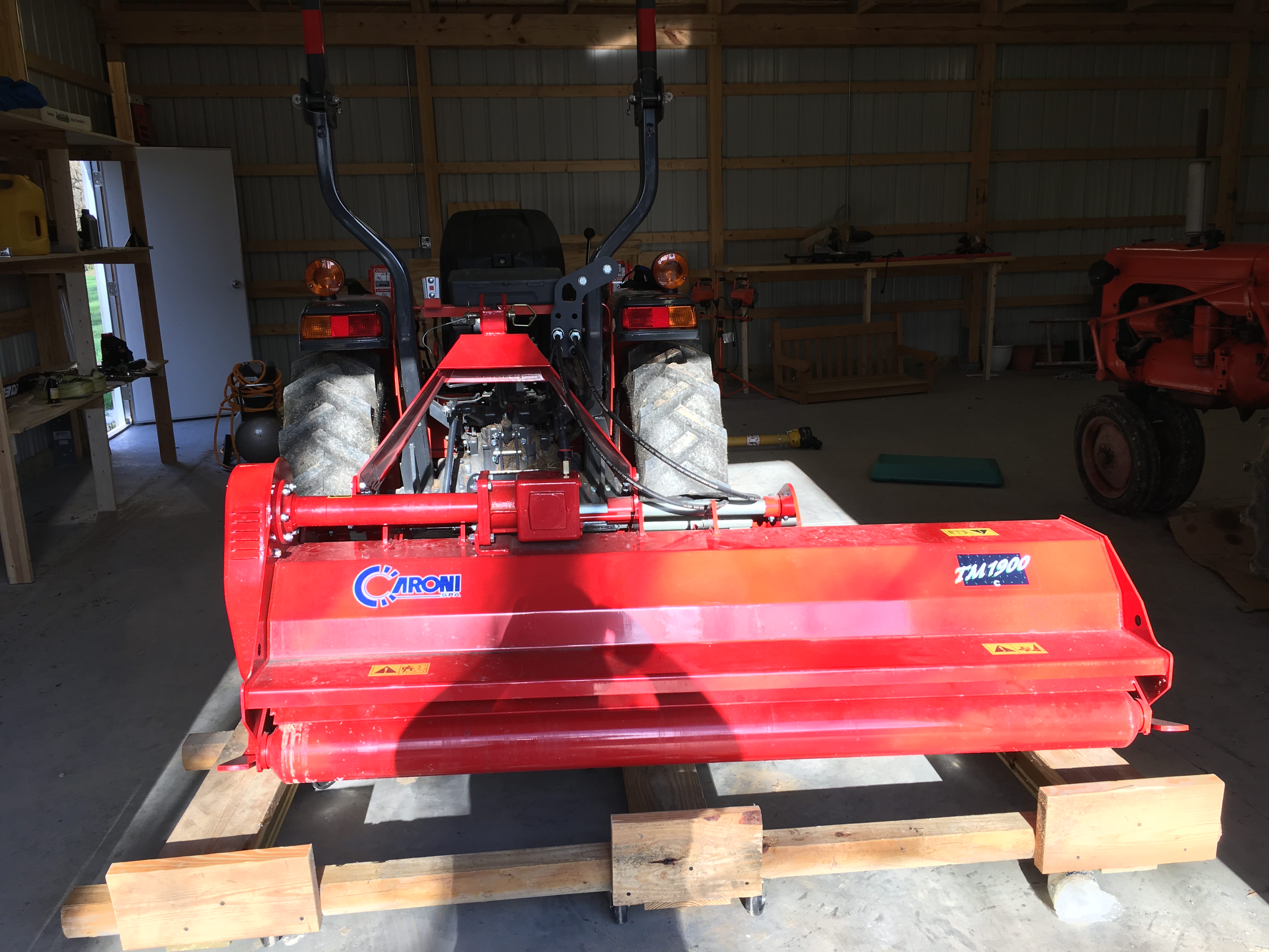

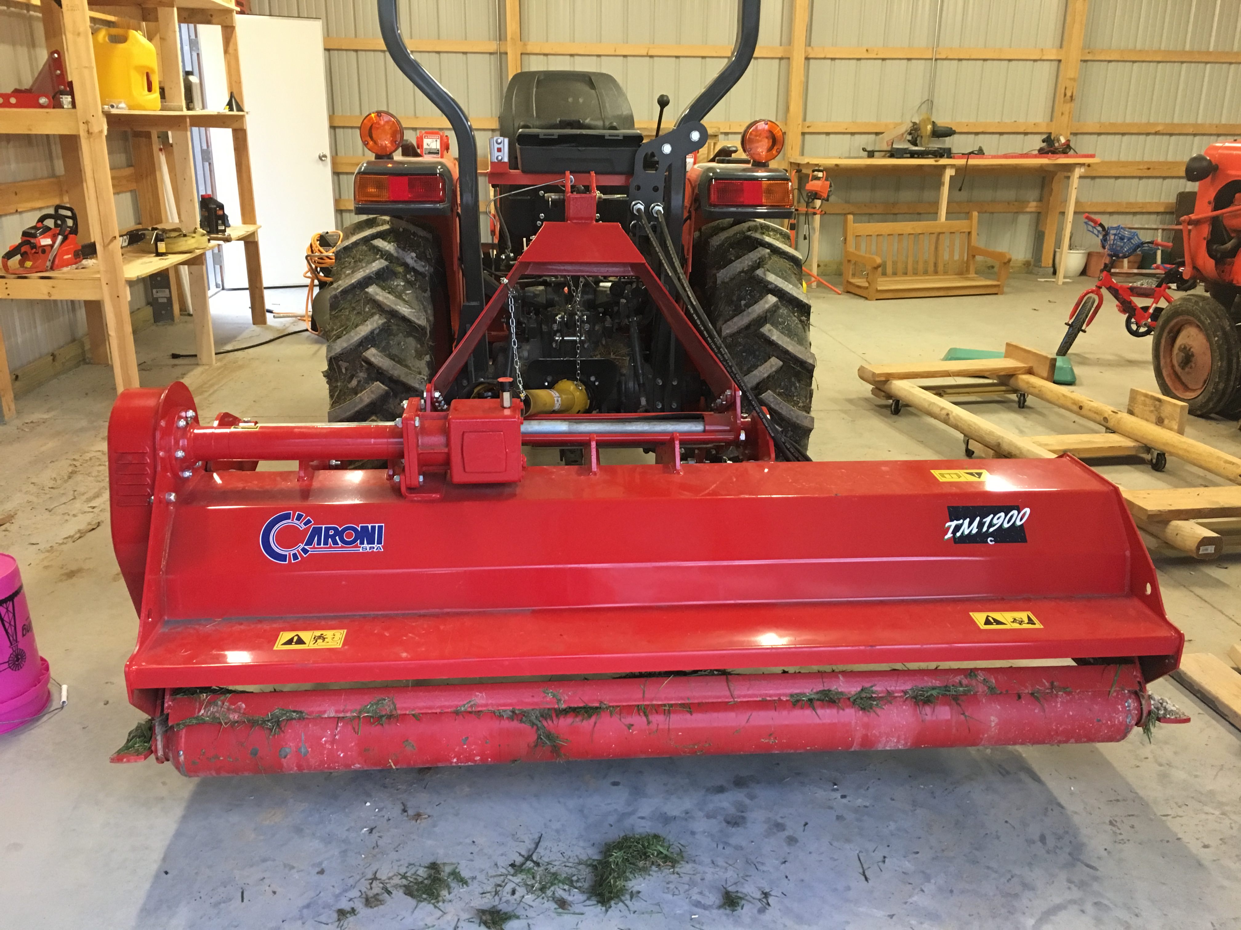

Well I had my first mow with the Caroni and it did great. My toplink was just barely long enough, so I had it pulled in a bit to make sure it didn't break. I picked up a longer toplink today, so my next mow should be even better.
This is the position of the mower fully extended out.
Here's the position fully drawn in. With the side shift kit the mower is almost centered, although the cut is still offset to the right (due to the gear box on the left).
Other than putting the PTO guard on (oops), she's all done and ready for the season. My test mow went well, everything went fine.
A few notes to anyone looking into this setup:
1. Because of the positioning of the shift kit and my PTO, I CANNOT raise the mower all the way up without bending the PTO shaft. That's fine for me, but could be a problem for some. To fully raise the mower I'll need to unhook the PTO shaft.
2. Because of the extra length added by the shift kit, I did NOT need to shorten my PTO shaft.
I'm not used to having that much weight behind me, it'll take some getting used to. I have a 55 gallon drum of wiper fluid ready to fill the tires with, as soon as my buddy has time.
One question: For those with side shift mowers, do you grease the rails at all? There is a light amount of grease or film on them currently, but the manual doesn't say anything about keeping the rails lubricated.

Nice job!

Hello Lagreex1,
I want to welcome you as the newest member of the Flail Mower Nations from the great state of Indiana.
If both of your lower links can be extended I would definitely extend them as you will have a better balanced mower and mule.
Take your time when you begin mowing as you have a short implement mounted on the rear of the mule.
You have to remember that quick turns while driving at transport speeds are not a thing to do with a raised flail mower.
When you get to do a lot of mowing your going to have a lot of fine dust from mowing and the heat drying up the grass that sticks to the mower shroud and the rest of the parts.
The fine dust screen in front of the radiator(if it has one) may plug more often too so plan on using hot water to help wash the radiator out and flush the chaff and dust screen if it has one.
I always tell everyone that the tattle tale vacuum indicators on the air filters are not to be trusted as they can and will be affected by fine dust. I do not like dry paper air filters as I found that oil bath air cleaners are much more reliable as they have pre cleaner dust cups that remove the heavy dust from the air stream and that cannot plug.
Best thing to do is just wash it off with really hot water in a hand held lawn sprayer with filled with some Dawn Dish Soap when the dust gets to be noticeable as it will get into everything and the guide tubes for the rails. Washing under the mower shroud occasionally will help to dissolve the grass dust that will accumulate on everything and the bolt threads on the knife hangers.

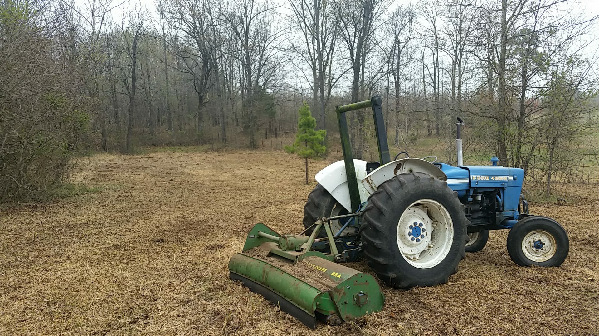

Got the flail out Friday and worked it a couple hours. Our spring green up is running late in southeast Missouri this year.
Anyone else have pics of their John Deere 25A or other green flail mowers?

We have a big herd of 25A pictures and the mules pulling them on the forum.

Leonz thanks for the warm welcome, and the tips.
Hello Lagreex1,
My lower links don't extend out (I don't think so anyway...). I am about to extend my wheels out, which will be nice.
