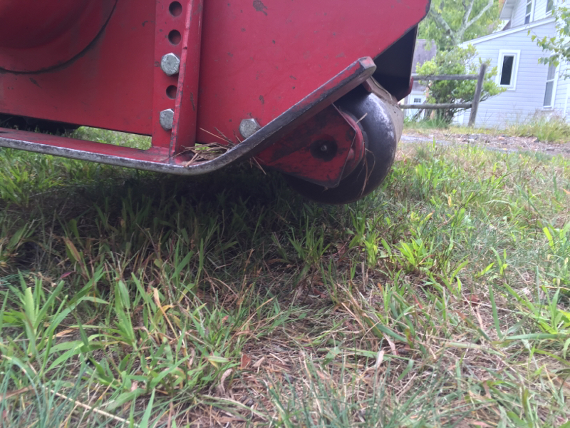

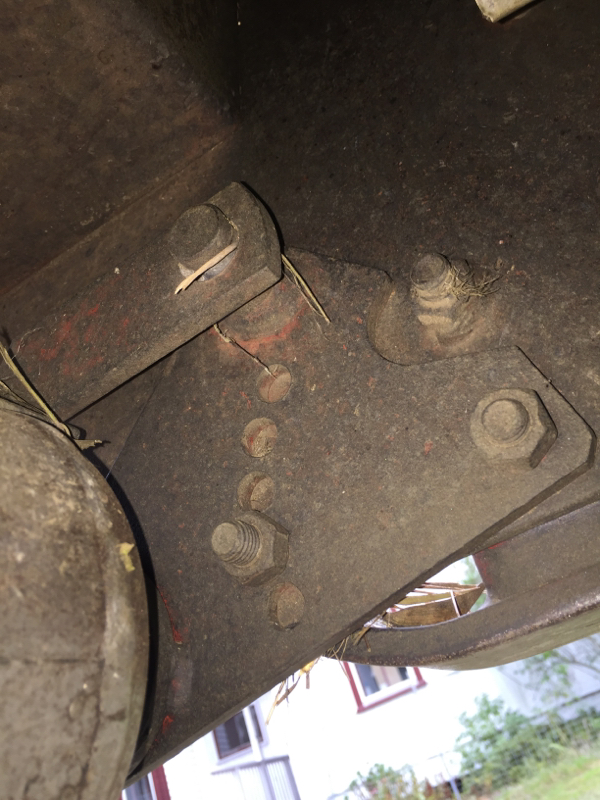

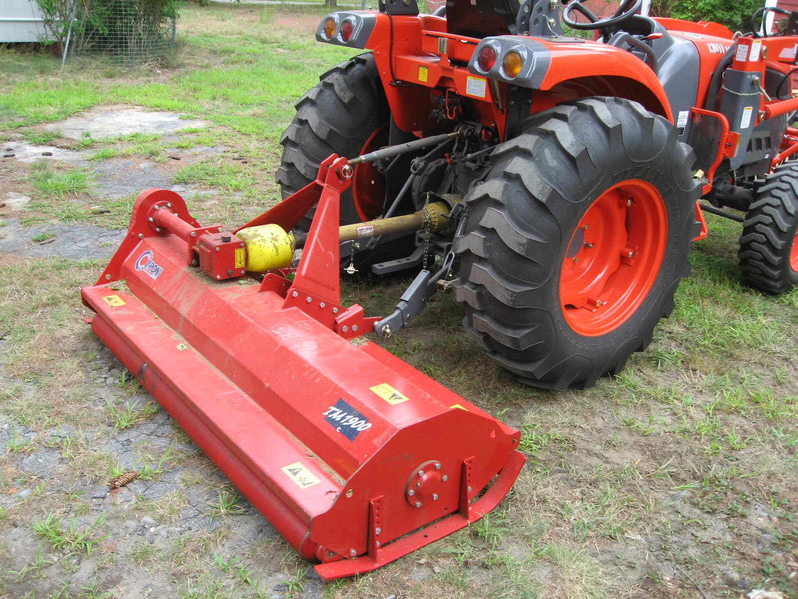

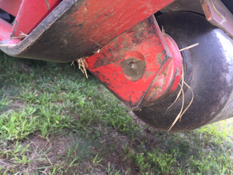

How easy is it and how long does it take to adjust the roller height? I usually mow the pasture and a horse riding area right after one another and I try to keep the riding area mowed short.
   / Let's talk flail mowers #4,530
Remove two bolts, swing roller, reinstall bolts. The last photo from inside under mower shows a curved plate with holes that pivots on the rear of the mower housing and is attached to the roller. One on each side. There are five possible holes to put the bolts through depending on desired height.
