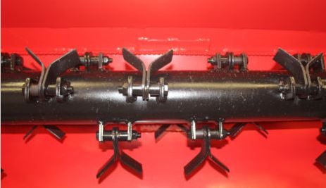

So is the upper picture considered the hammers?

The upper pic looks like it could be one version of hammers OR they could be duck foot blades. Someone with better eyes might be able to tell the difference. Hammers are heftier than duck foot knives. Smaller hammers weigh close to 1/2#, the larger ones can weigh 3 times that.

Actually they are what are referred to as scoop knives. They are sometimes described as duck foot knives.
Traditional flail hammer knives for orchard and Vineyard use are cast iron with a wet ground cutting edge(if they were made the right way).

Yes it is their type of flail hammer knife for their flail mowers:
