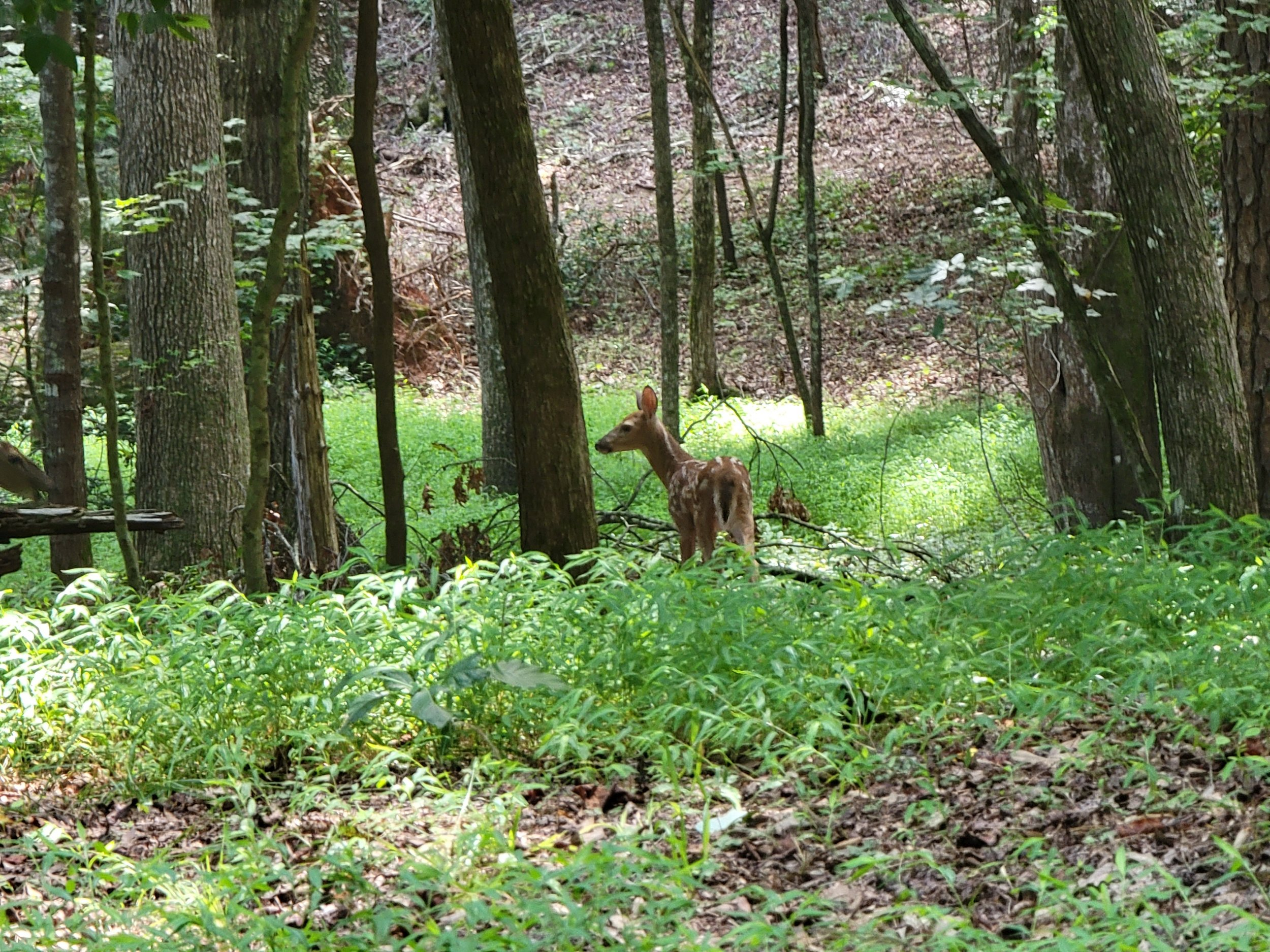

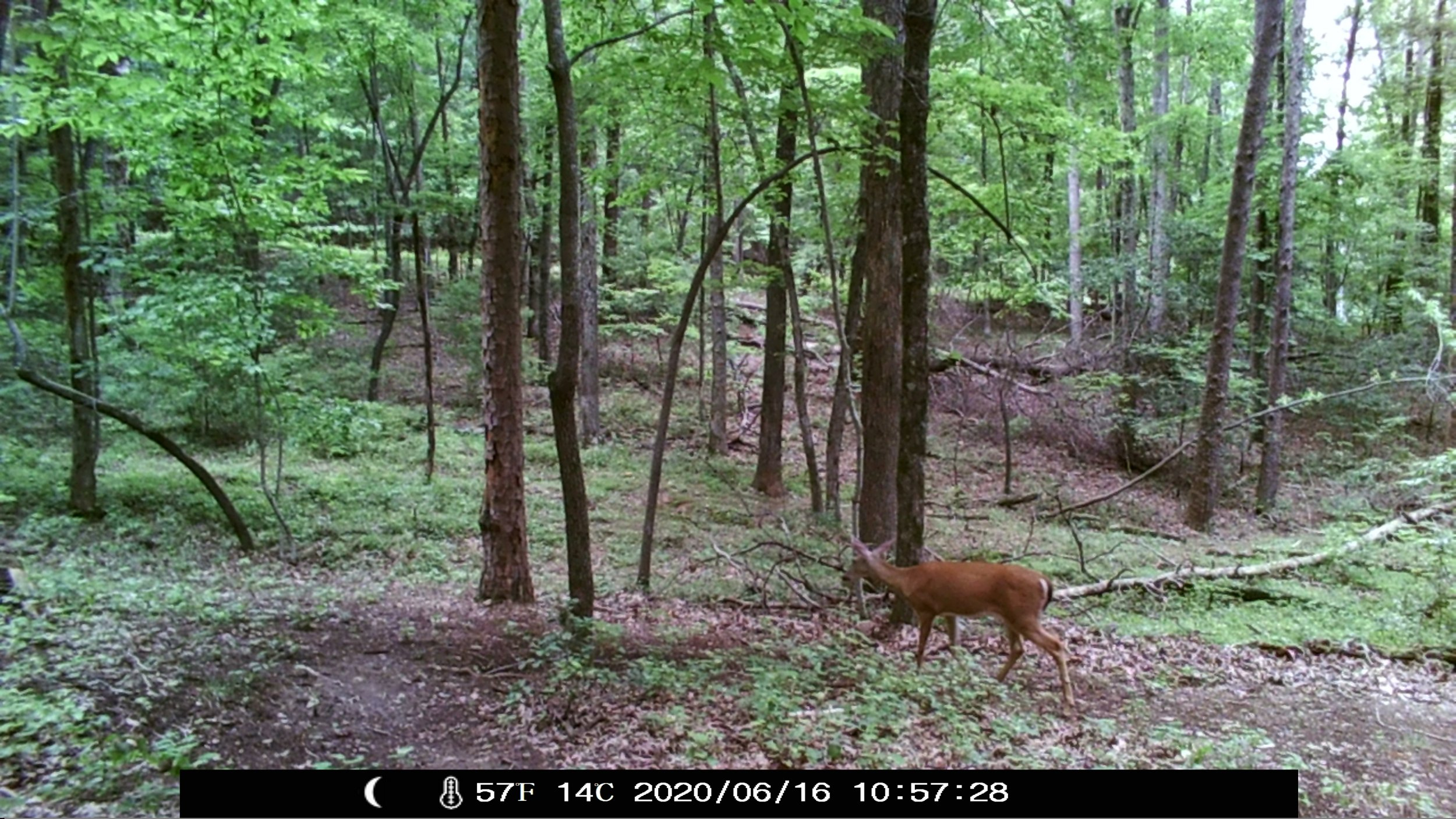

I have been interested in a flail mower for about a year and have been going through a LOT of posts. There is a lot of great info here... (y)
Now I'm looking for some help before buying. Sorry for the length of the post, just trying to provide a good overview...
We have 12 acres, mostly wooded and a number of fallen trees to clean up. I want to use the flail mower to clean up what is left, small branches, small saplings and some brush. (I've been collecting all of the bigger rocks and getting them out of the way.) Also to maintain these areas once things are cleaned up.
Originally I wanted a 60" mower, however the paths in my wife's garden (it's a big garden) between the 15 raised beds are only 65"-66" wide and even though my tractor (Kioti CK5310) will just fit down the aisle the overall width of a 60" mower is too wide. ( I have an old Ingersoll 4018 with a 60" deck that takes care of the grassy areas, but that is also too wide for the garden.) I also thought that having a flail mower narrower than the tractor would make it easier to maneuver in the woods. I also like the idea of a 53" cut rather than a 48". The flail will also be great for the times when the grass gets too tall in the open areas for the Ingersoll to manage. During the spring and summer in Georgia, the grass grows VERY fast.
Here are a couple that look promising:
Betstco FH-FMC135 53" The "Commercial" level unit 53" wide. ( Side shift is +$500 )
Nova MFZ135 53" 53" unit with side shift
If I do not get a side-shift model, will I regret that later? (I wanted to stay somewhere in the $2700-$2800 area.)
With the tight woods, uneven ground and some elevation to deal with, I want a unit that is as heavy duty as possible. While I have collected a lot of rocks, the flail might find one or 2 that I missed... Also, the tractor has ~30 hp at the PTO, so 60" or less should not be a problem.
From comments and issues that I have read, it seems that no matter what I buy, putting Loctite on most of the fasteners might be worth the time up front.
The availability of spare parts and a reputable company is also important.
I am open to other options/suggestions. Thank you for taking a look.
Craig

Hey Craig,
I run a Betstco FH-EFG-175 with my CK3510. Thats the 68" model, it more like 75" total. No problem with PTO hp. It sits somewhat offset with the left side being right about the tire width and the right side hanging out 8-10 inches. It can be offset even more by shifting the top link bracing over to another set of mounting holes. I would suggest getting something at least as wide as the tires, but that might not work for you and the raised beds. I haven't found I would need the side shift, but that is just my applications.
It is a little wide in the woods and close quarters, but I use mine more for maintaining the openings, not clearing them. Thats what the grapple and landscape rake are for. It does take out up to 2" size brush no problem. I haven't tried anything larger.
I have hit some rocks, and it doesn't like them. Will break the hammers pretty quick. But it is a well built mower. I haven't bent or damaged anything besides hammers. Getting parts from Betstco has been pretty easy once they answer the phone.
One thing with the Betstco is the rear panel is welded on, so no way to remove for maintenance. Makes it more difficult to replace hammers, etc. Another manufacturer to consider is WoodMaxx. You can remove the rear panel on theirs.

Just a sprinkling of comment on parts of your selection process: 1) The cast metal hammer type you are looking at will stand 1" to 2" scattered not clumped brush and light limbs here and there. The"Y" cutters you apparently already know will NOT stand that. I can tell you first hand that with pretty "heavy duty" Y type knives (described that way by the industry) they are very vulnerable to unseen small limbs and hidden pieces of wood. You spend more time replacing knives than makes sense. 2) You will be pleasantly surprised in terms of maneuverability. The flail mowers hug close enough the rear of your tractor (compared to a bush hog of the same cutting width) that they are VERY maneuverable. 3) In your shoes I would get one as wide as your rear tire spacing and you won't be hurting maneuverability. 4) Cleaning up after fallen tree removal is not the forte of flail cutter in my opinion. I think an HD bush his the better tool for that unless you have been pretty meticulous with your grapple ahead of time. Good luck with it. Both flails you are looking at look good to me.

Rent a FECON forestry mulcher for a couple of days to clear the saplings
and dead wood out and you will have much less work.

My property looks similar to yours in some places. I went with Novatractor because it had the meanest looking hammers I found. I was telling my wife we need to take better pics and video of what we're doing with it because so far all I find online is people just cutting grass lol. This thing eats twigs, small branches, saplings and pine cones like nothing. This was 15 minutes and was easy stuff compared to some.
Also, the sideshift has been great! I have the MFZ155, my tractor is 66 inches wide. So it's 60" cut doesn't quite cover the tires but I didn't want to go wider because it can be tricky to maneuver between the trees. The sideshift lets me reach a little as well as letting me get it out of the way when turning or up against the fence line. I am glad I went with a slide model.
I was a bit leary about getting one that seems almost nobody has heard of, but they've been on the market for at least a few years so hope they will be around when I need something. I do have a few spare hammers. And as I saw someone else mentioned, the back panel on the Novatractor opens up for inspection and maintenance and makes it much easier to deal with.

I'm only semi qualified to answer this since I'm still slowly getting my flail put back together... So this is from lots of other mowing experience...
If you're struggling to get your Ingersoll through the rows, I would suggest you might try to convince your wife to go a bit wider on that next year... I hated trying to work between tight rows my father used to put in. Even if it was ok early in the season, later in the season, I had to give up with the tractor, and just resort to a walk behind machine. (we usually just tilled between rows, rather than mowing)
For any other kind of mowing, I would either want tread width at a minimum, or a side shifter. My family went from a 5' rotary behind an 8N set at 5' to a 4' finish mower behind the same tractor over 20 years ago. As a result, the edges of the fields have been creeping in for years. We don't need the field space, but what crept in was briar and rhododendron. I'm in the slow process of putting a flail back together, 6' behind a 6' MF 135. But before I finish that, I'll get the rotary back in service, and between that, and a loader, push back, and chop up that bloody briar. I'd have preferred a wider, offset, or side shift flail, but the price was right on what I got for a test case... (needed more work than anticipated unfortunately)
