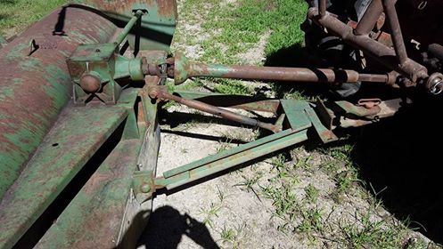

I have a question about my Ditch Bank Flail. There is a pin that goes under the main bolt that supports the swing arms. There is also a set of holes that looks like a place for a pin. This pin rides on the front of the 3pt assembly.
My question is, does removing this pin allow the swing arms float up and down? Looks like that was the intent, however there is only about 1/8 clearance on the back side. I could see where this would help on rough and uneven ground but don't see it floating very much at all.
Pin and holes.
