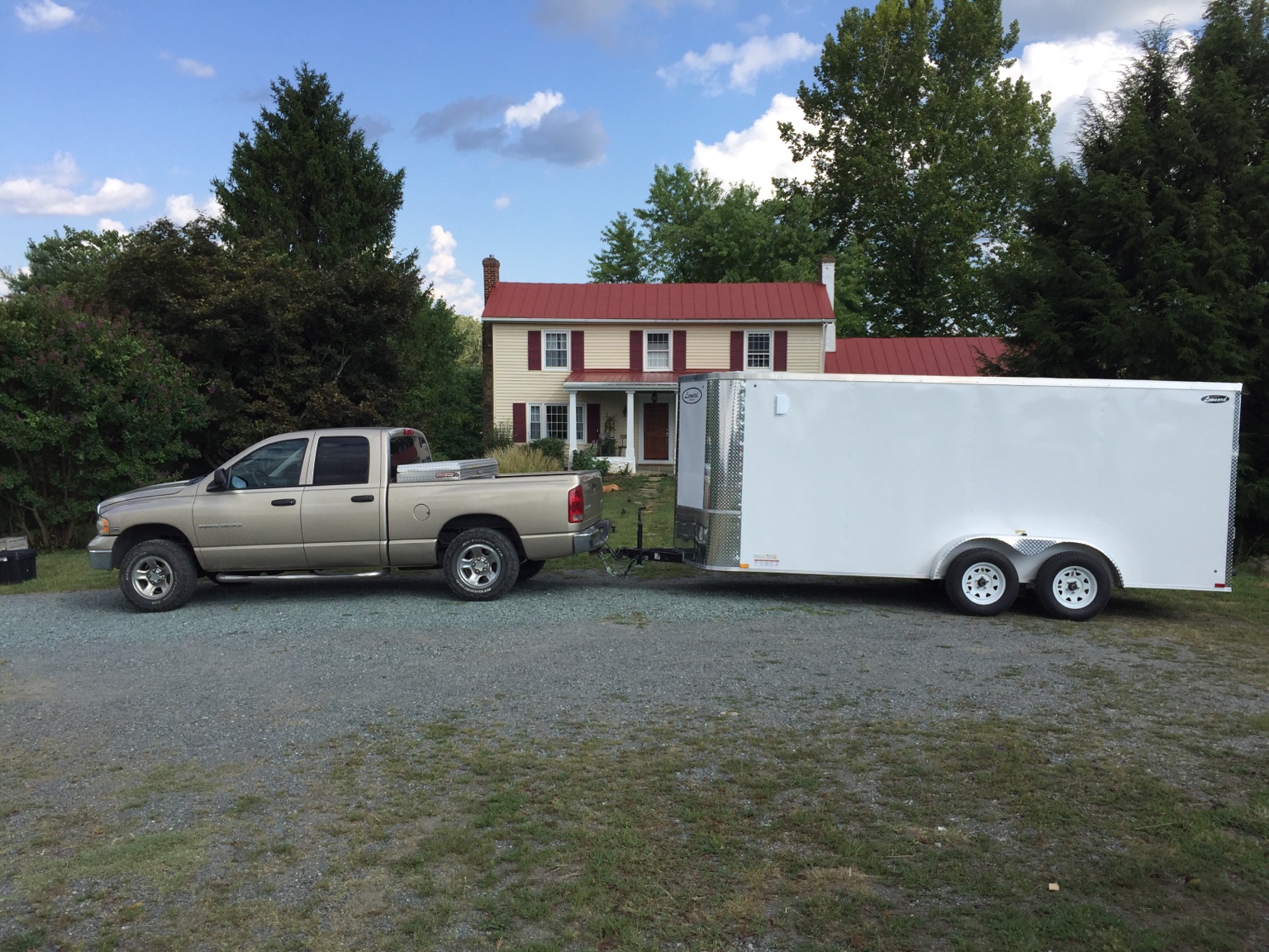

After considering all the information that was shared here, I pulled the trigger this morning on a 7x16. V-nose from Leonards. Manufactured by Arising Industries. It will do the trick and with some rearranging of things we are going clear out a storage unit that we are currently paying $290 a month for (mostly tools I need for the farm and some stuff that is for the build. Will probably keep it 1-2 years for tool storage until the house and barn are built and then sell it. i think I will actually come out ahead and I will have my tools handy. I had them put an additional hasp bar on the side door since it only had an RV style lock. I bought four masterlock Magnum locks for it for all three door locks and the tow hasp And I am going to call my insurance guy Monday and adjust my policy so that all the tools and the trailer don’t wipe me out if some dirtbag breaks in and steals me blind. My bride is delighted. I told her to organize me and she has been busy putting shelves together for the trailer and pulling tools out of the basement to go in there to make room, for the last 4 hours.

Nice trailer, but realize that you will never sell it. A trailer is just too handy to have around. Your pickup, and the next couple pickups, will be long in the junkyard and the trailer will still be in great shape.
Running gear failures on a trailer are user error.
You HAVE to keep tandem tires equally inflated. Never let one go flat. At best it would ruin the tire, at worst the trailer will catch on fire.
Other than that, pack the bearings every 5 years/50,000 miles. All it costs is new seals and a tub of axle grease. Wash the bearings and hub, work the grease into the bearing until there is no air in there, put it back together with new seals, and it will run forever. I have a utility trailer I inherited from my dad, and know it's at least 70 years old. It's too handy to ever think if selling it.
