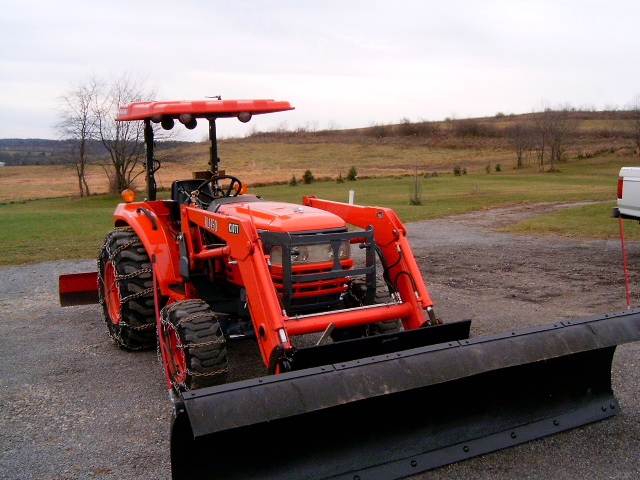

Kioti DK 35 with a 9' power angle front blade and 7' rear blade.

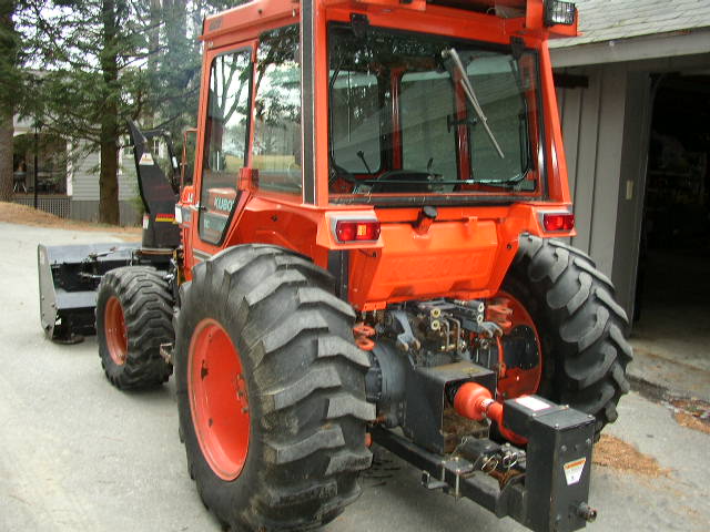

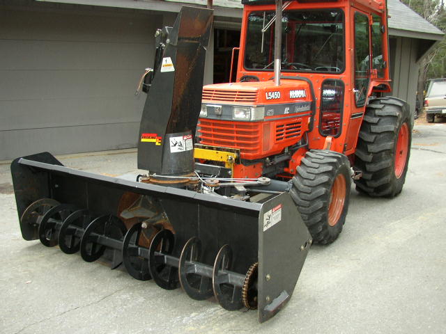

The blower itself is nearly the same, but the big cost adder for front-mount is the drive shaft and mounting arrangement. The standard 3-point hitch works great for rear mounts but front mounts are a different game. Unless a tractor has a front facing pto, the drive comes from the back. (shaft or hydraulic pump)

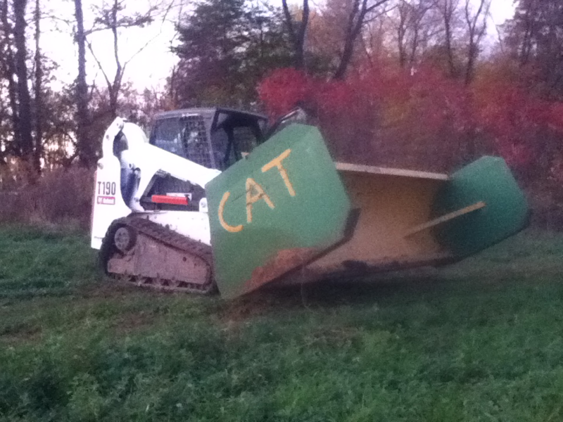

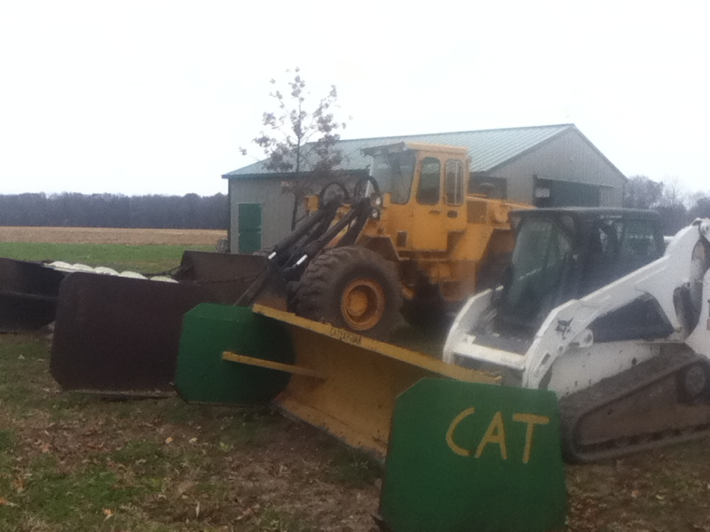

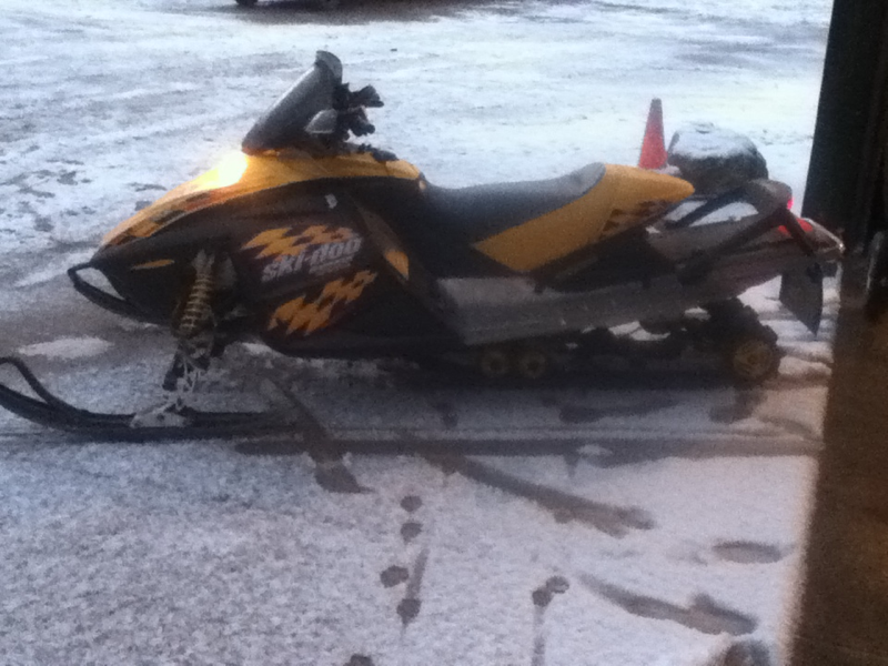

My most used snow removal equipment, also got a duramax with a boss 9.2 VXT, never can beat a nice cozy warm cab!!

Is that the Erskine PTO adapter kit for the front mount blower? How's that working for you? Kinda pricey?

Yes it's the Erskine front mount that includes the frame, lift cylinders, chain drive box for the rear pto, belly shaft, and reverse-rotation snowblower. I lucked into this one for short money on Craigslist. It had a 6 foot blower but now it's 7 feet wide. It works great - better than any other setup I've had (rear 6' blade, draw-forward 6' single-stage, rear 6' back-up 2 stage, rear 7' back-up 2 stage with drag blade, front 6') I need to get a life.:eek:
