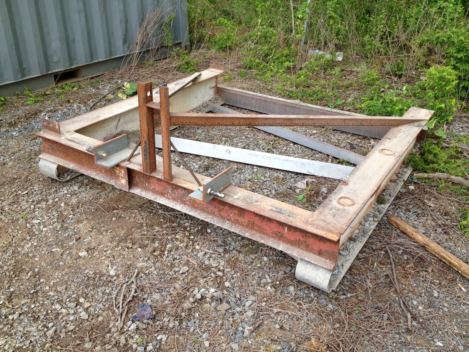

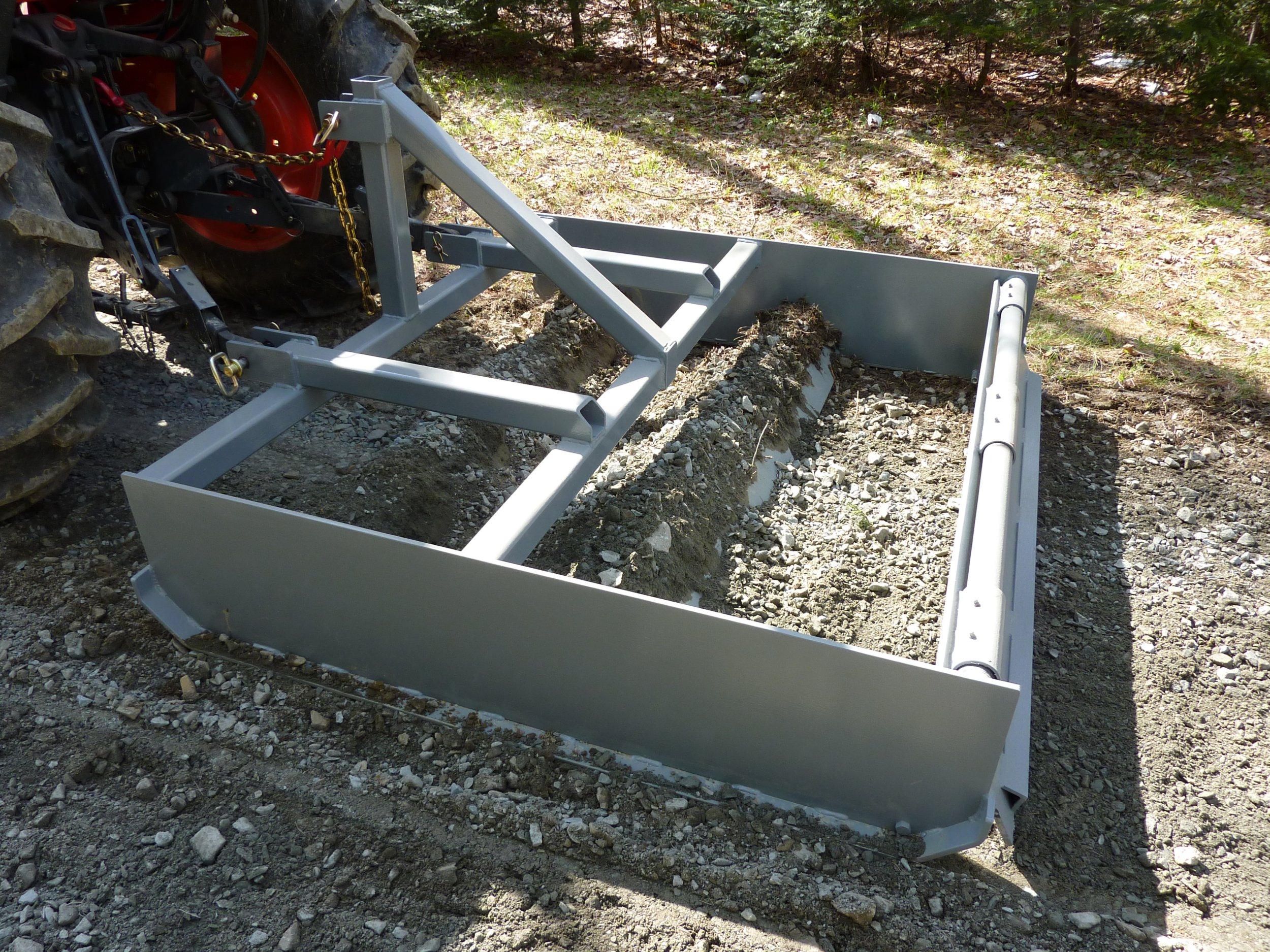

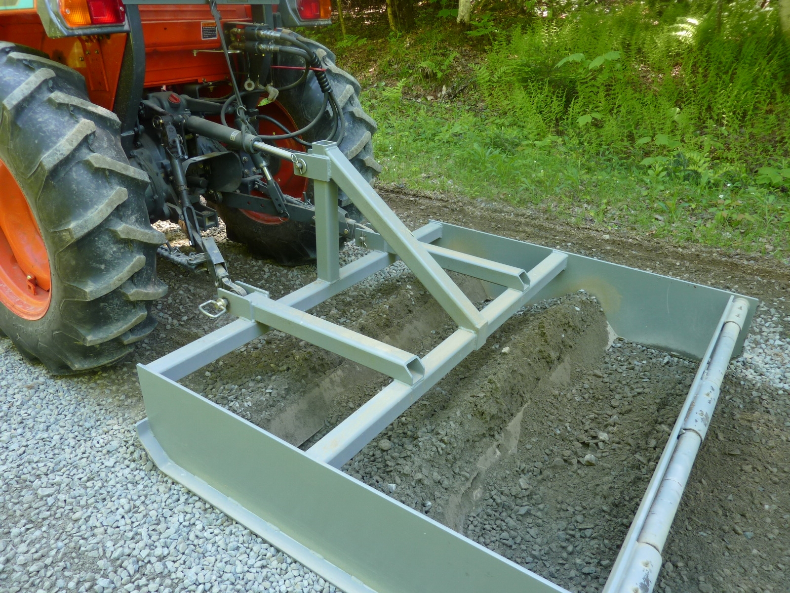

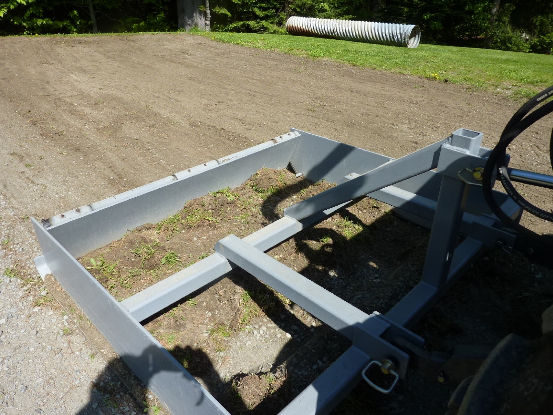

I built mine from galvanised stock and added the ability to pick up the plane with the FEL, which is very helpful - from moving it about the yard, transporting it while the box blade is already attached to the 3PL, to doing a quick job without having to change implements.
I also made it longer than store-bought units to help achieve a flatter finish.
Could you please share the dimensions?
   / Lets See Your DIY Tow Behind Landplane #46
Sorry, I only saw your request a couple of days ago and hadn't had time to measure it up.
The overall length is 1,980mm, 'cut' width 1,475mm, overall width 1,625mm.
The frame uses 180x75mm PFC and 50x4mm SHS. The blades are 75x6mm.

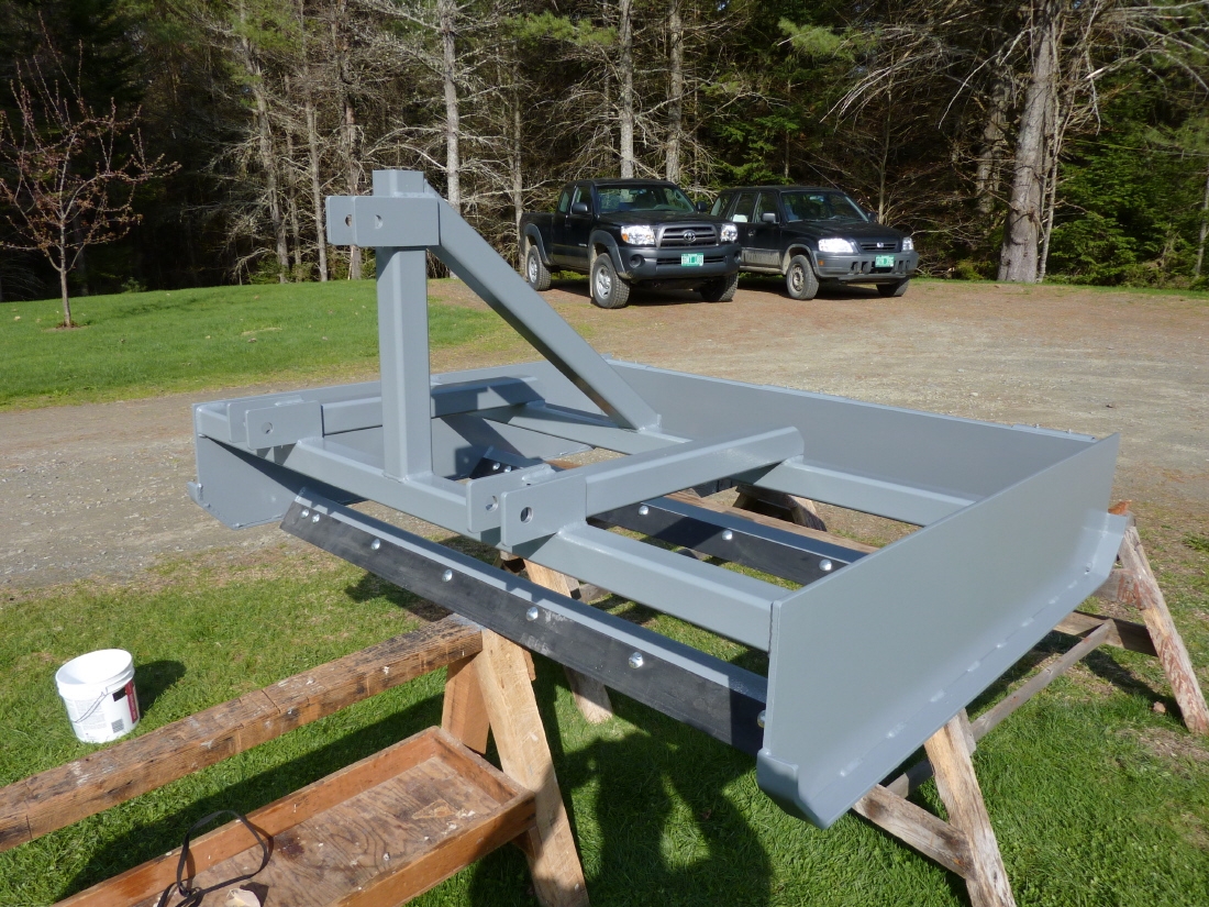

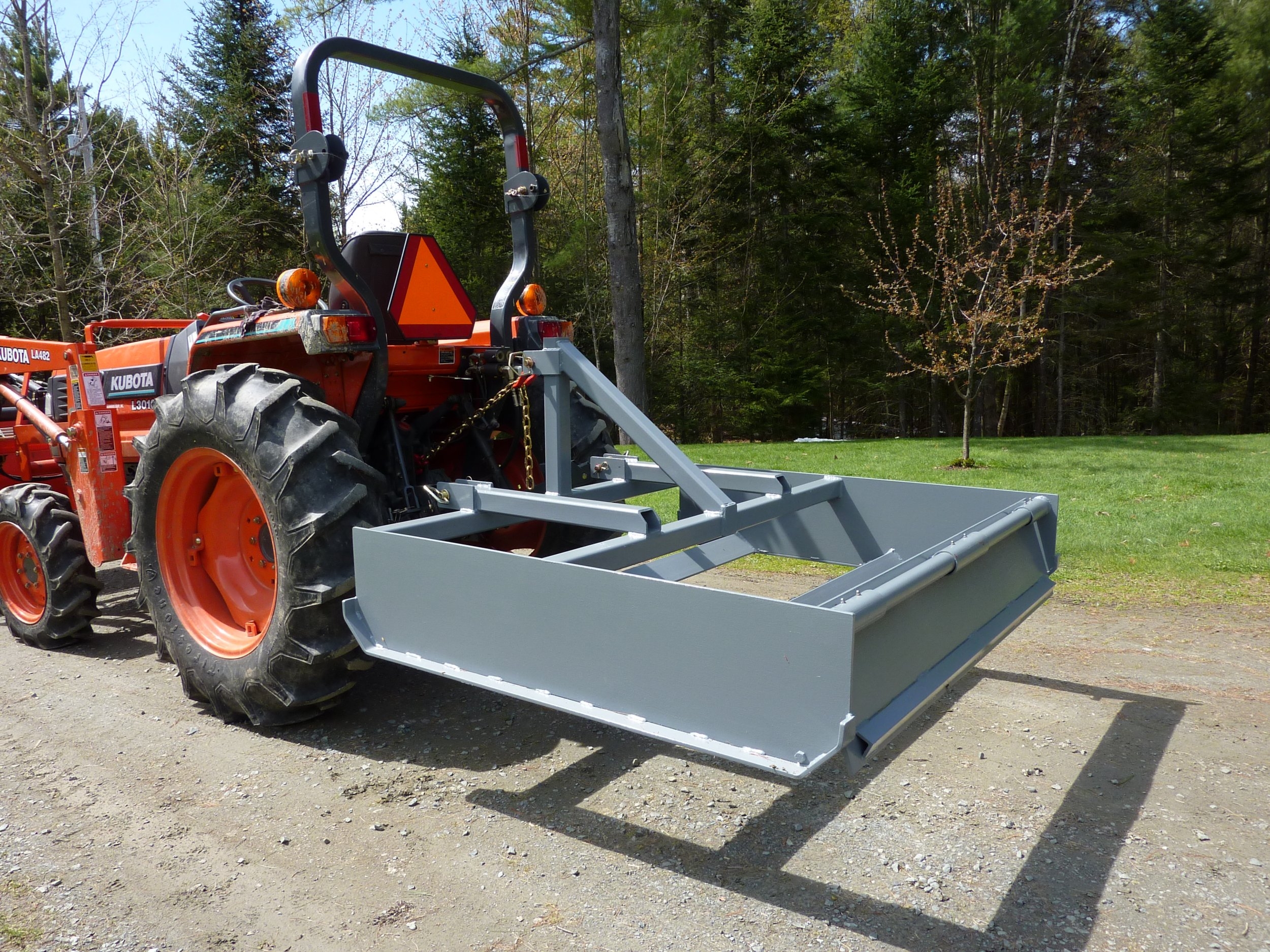

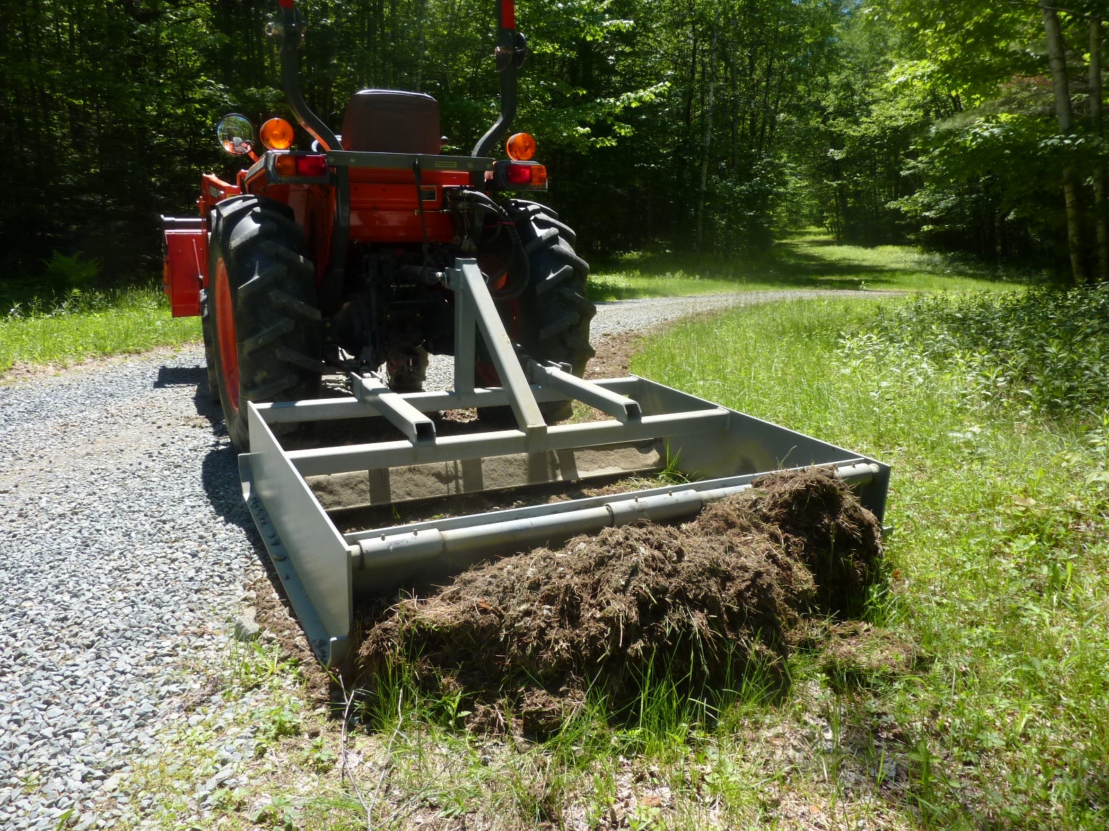

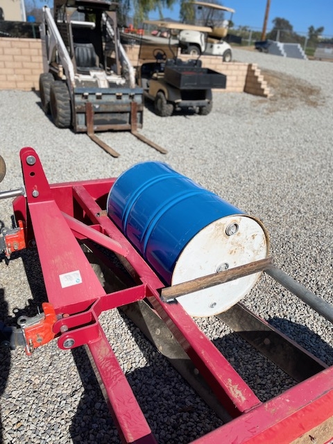

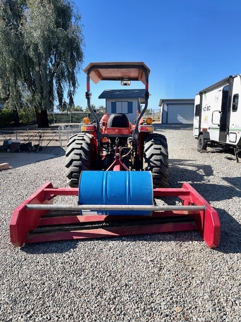

The one I built.
