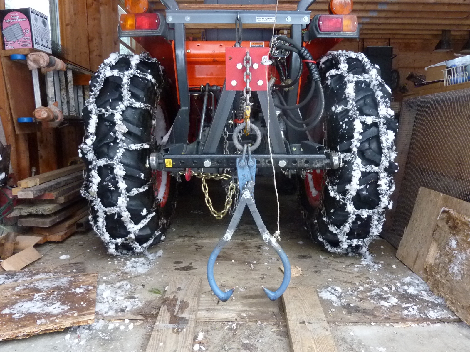

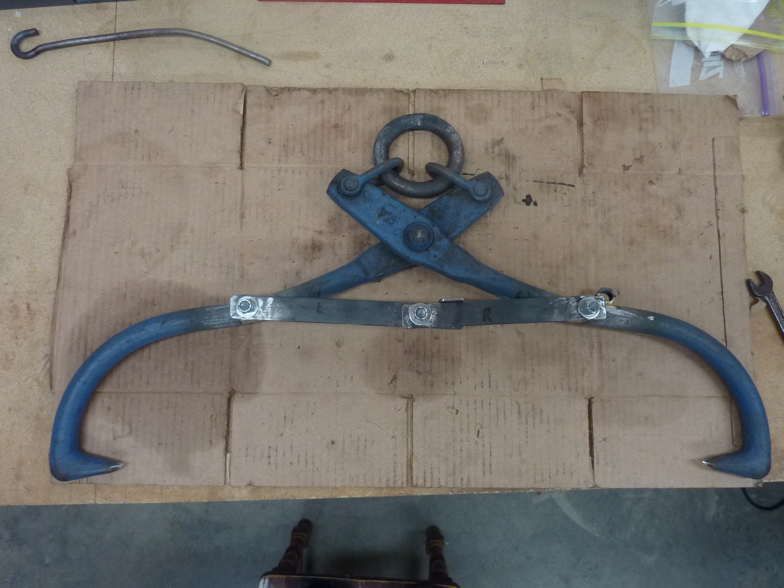

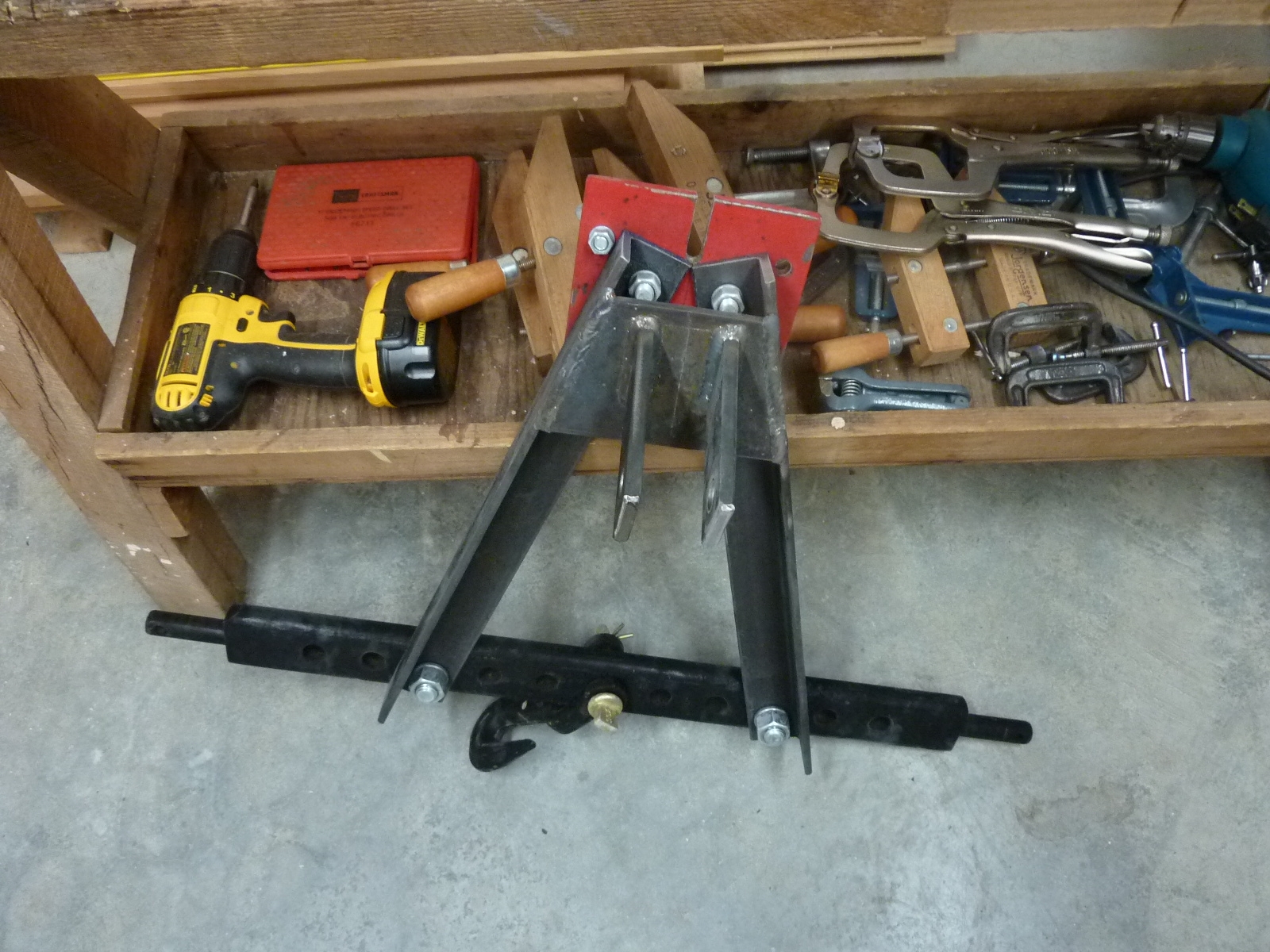

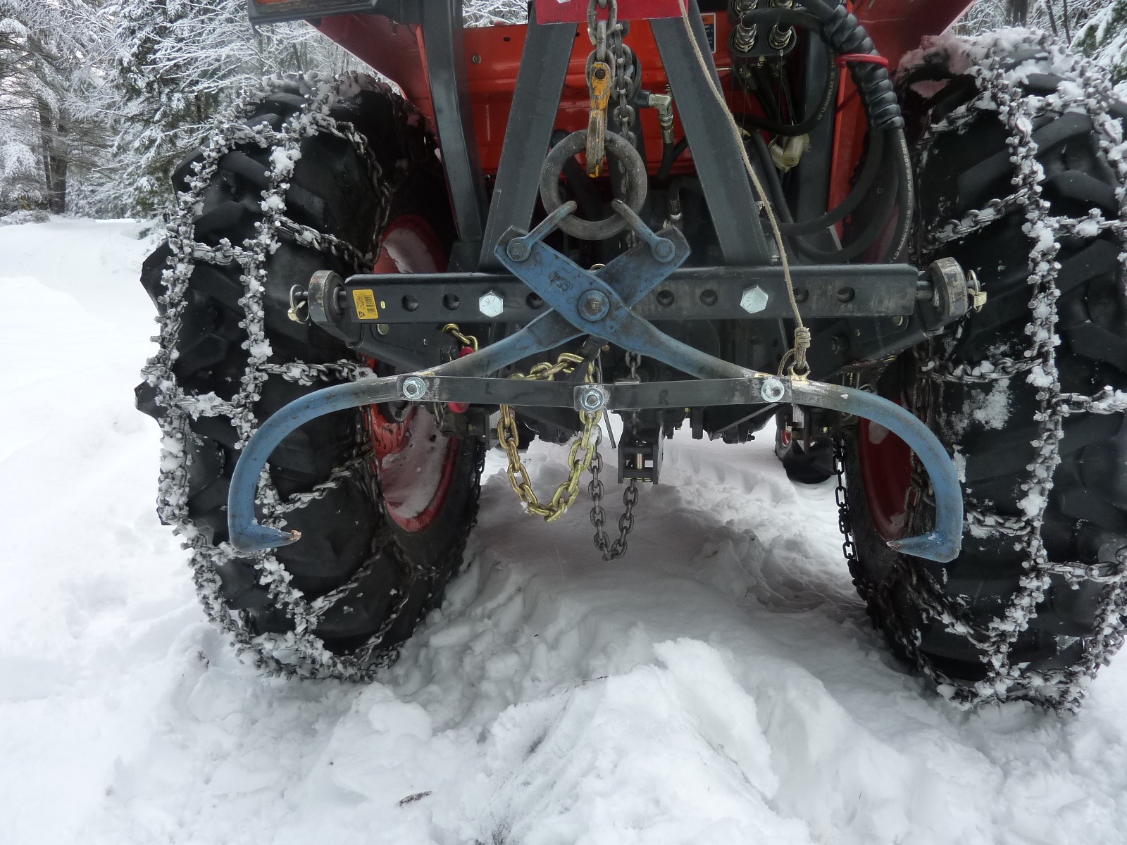

I made this 10 years ago. Not a boom but moves logs and may give you some ideas. Used a tractor draw bar from TSC and some angle etc.
Put an over the center type latch on my tongs to hold them open.
And a rope pull to latch open the tongs.
I made this short video the very first time I tried it.

This is another way to do it. Pretty poor pic. Put a hinge on the draw bar at the base of the boom and a slide on the tractor draw bar. Gets you more lift. Always pulling from draw bar not top link.
gg
Something very similar to this is what I have in mind but I will probably weld mine out of 3" tubing...Thanks!
