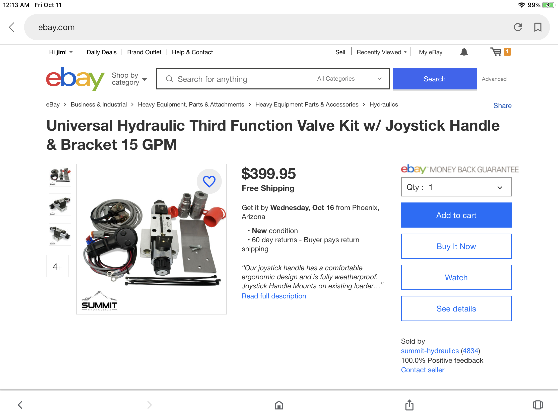

My dealer told me they can get a WR Long 12V electronic diverter valve that has to be plumbed off of the dump/curl or lift/lower circuit for about $750. I'm just mystified that it's $750 for just the kit. Been searching for alternative options since.

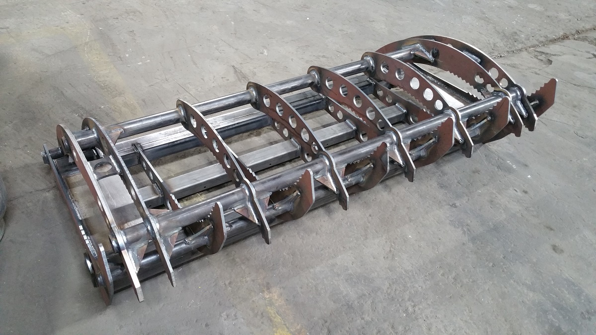

Another one, hope someone with more knowledge then me will say one of these would work.

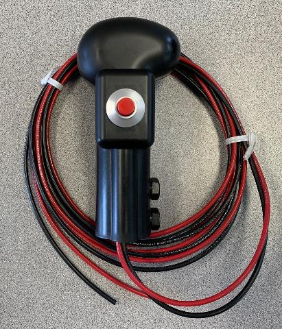

He has the WR Long Selector Valve Kit, which we offer for $787 shipped. It has the proper fittings and hose lengths for the loader along with a recently updated handle, which you can barely see on the tractor pic I posted. Here's a closeup of the knob.

That is the one amazon has listed, summit has a better price.
Just got to make sure it's an electric diverter to be plumbed off of a port on your joystick. The downside is it's an either/or function once you push the button. Hydraulic 3rd function units off of a power beyond port aren't available to us.

I am assuming that the electric summit diverter can be mounted up on the FEL and then just run the wires and new control back to the joystick and have two hoses made up for the grapple, again I am new to all this, my next tractor will have the front and back all set up, it痴 just a good learning experience, a bit costly though.
