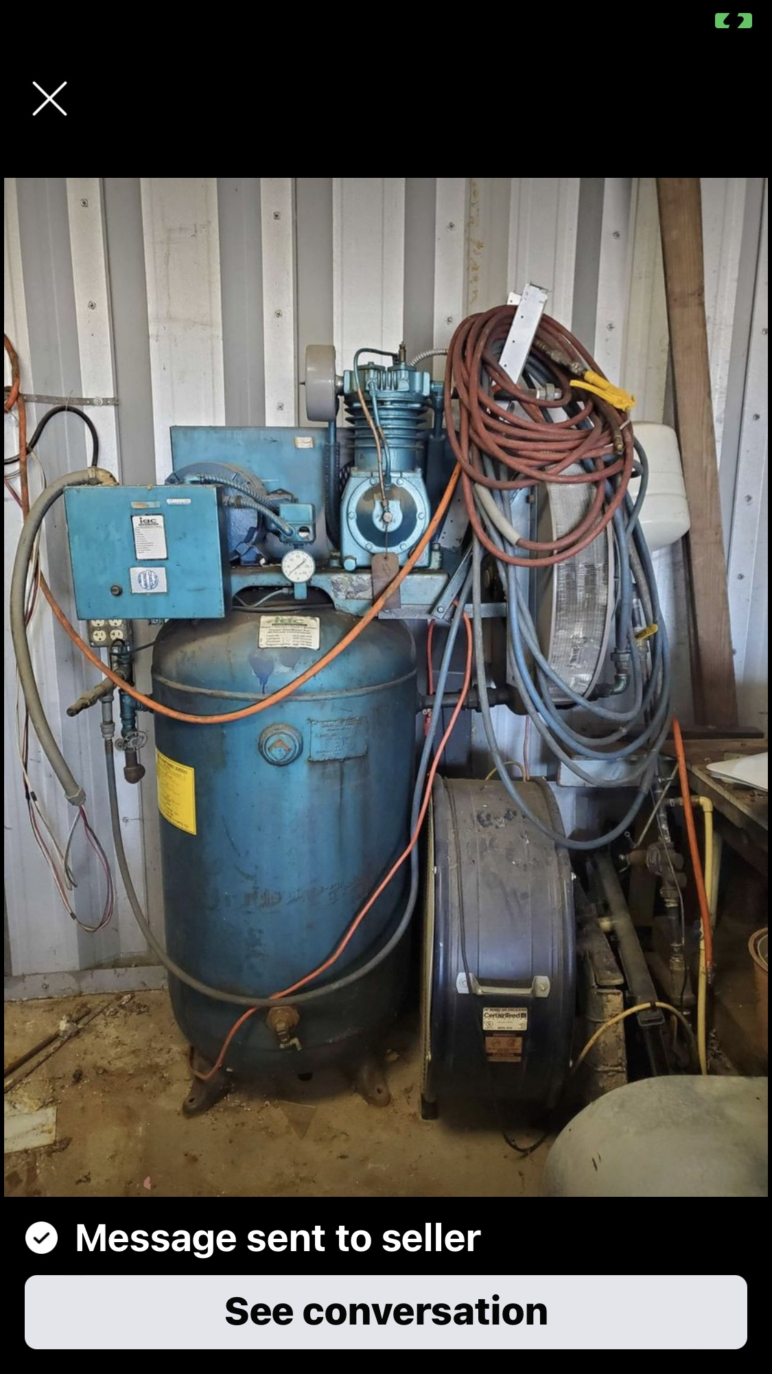

I have an old Kellogg American compressor 5 hp 3phase but with an inverter. I got it from a lady’s who’s dad passed.
I did get a newer tank for it 80 gallons I’m thinking

Never mind this post.... I showed something local for sale, was asking if it was worth looking at and the listing has been terminated.
Apologies for dragging you to this post.
