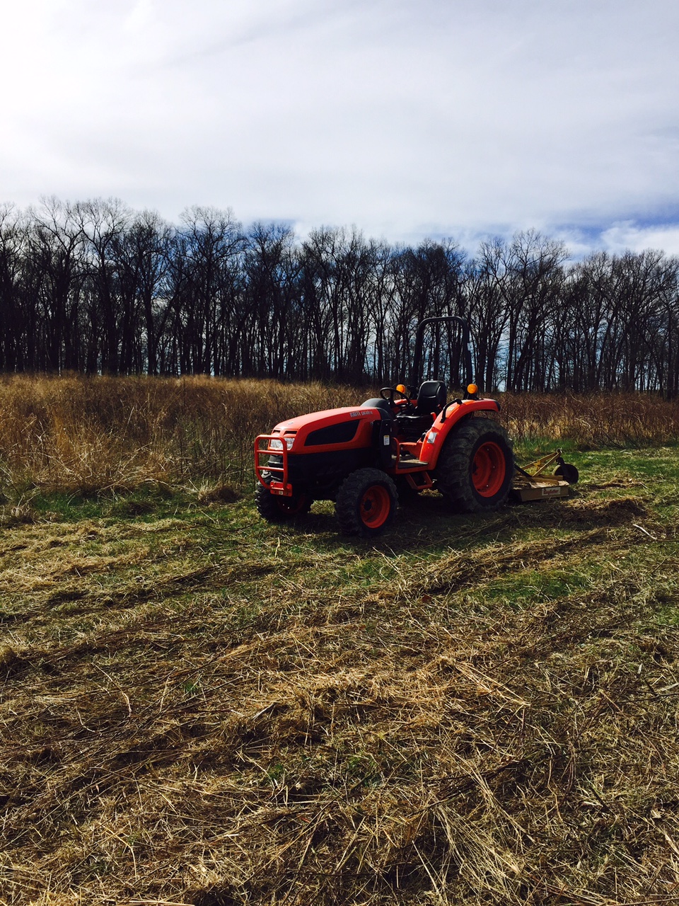

Well I was brush hogging my neighbors field (he lets us hunt his property so I cut about 30 acres for him each year) and there was a patch of briers that he wanted taken out so I left that until last. Got that patch cut by backing over it several times raising and lowering the brush hog, all went well. At least I thought it did.
I get done and head back to the house and as I am pulling into the driveway to back the tractor down and into my back garage I notice water or hydraulic fluid running out the bottom of the tractor. Stop real quick and find out the rear tire is going flat (I have filled rear tires). Upon further inspection I find a bent metal valve stem. Hmmmm....no way that brush caused that, nope. I lost a pin on that side where the adjustable sway arm connects up by the rear axle. Looks like once the arm came free it swung over and clipped the valve core on the inside of the tire. I had turned those pins around after reading about them being put in from the bottom with the clips at top. But the one thing I didn't do was replace those keeper clips with cotter pins. Looks like some of that brush caught the clip and pulled it right out and then the pin got pushed out.
Looks like I will be going through and replacing the keeper clips with cotter pins bent over on those pins I don't need to be pulling regularly.
Quick pic of the tractor at work, been 4 years and still love this tractor
