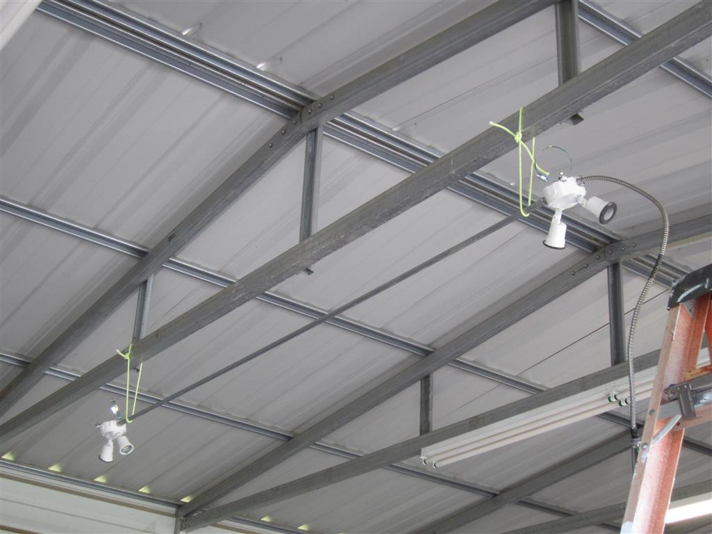

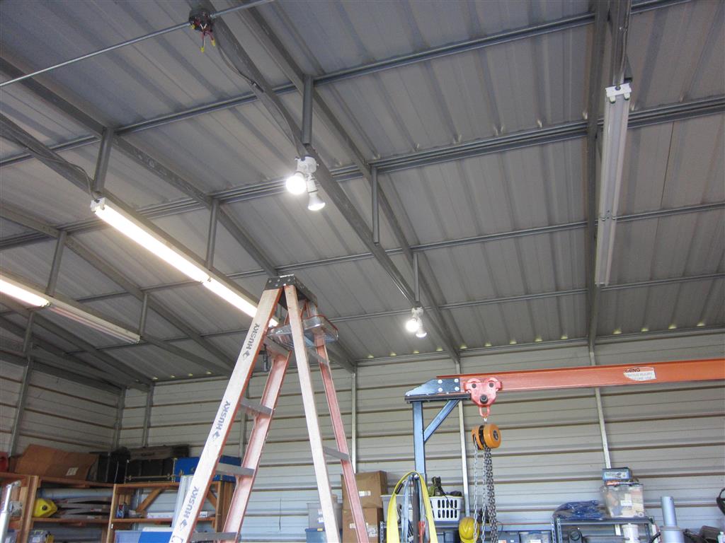

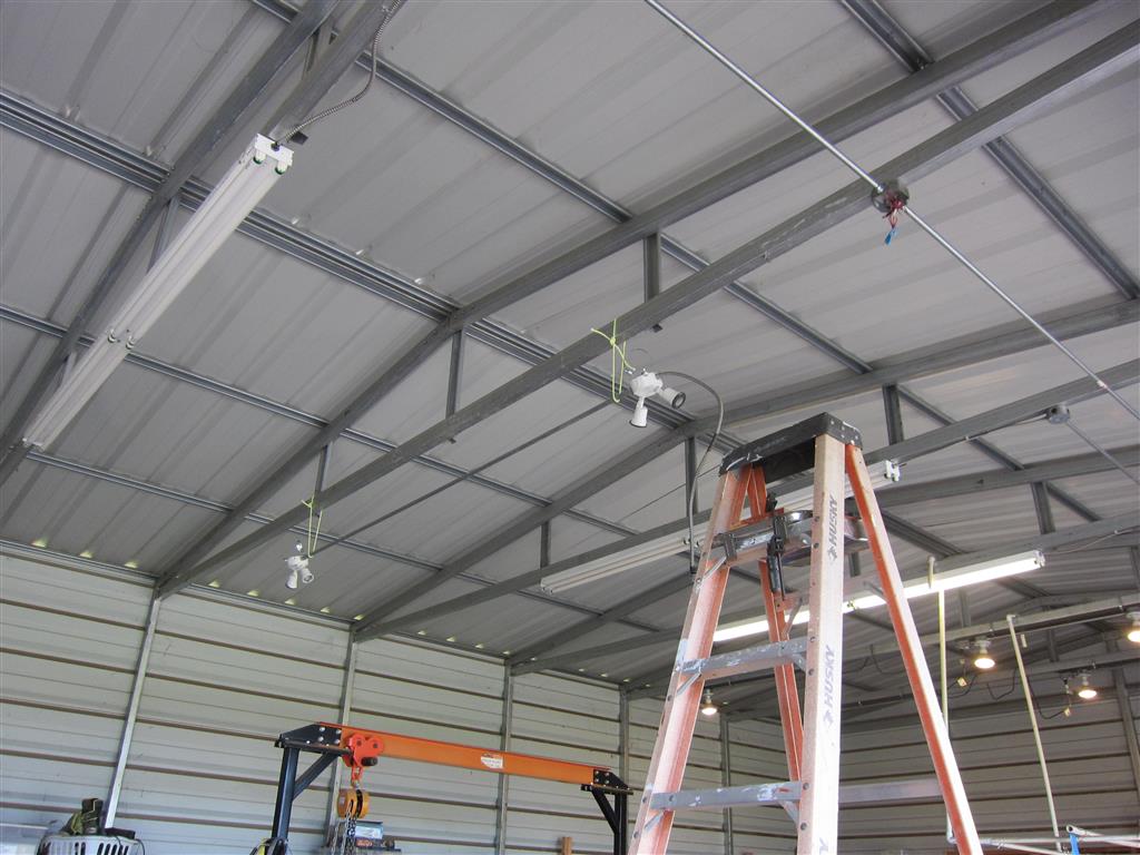

When I decided to get rid of the tubular fluorescents in my 24x42 ft shop (12 ft walls), those LED replacements were way too expensive. So I used the screwbase fluorescent outdoor spotlights with the integral ballast as replacements. Sockets are the weatherproof outdoor type, readily available at HD. Relatively inexpensive solution at the time. Used 24 of these spotlights. Plenty of light on the workspaces in the shop.
IMG_3611 (Medium).JPGIMG_3612 (Medium).JPGIMG_3613 (Medium).JPGIMG_3614 (Medium).JPG
