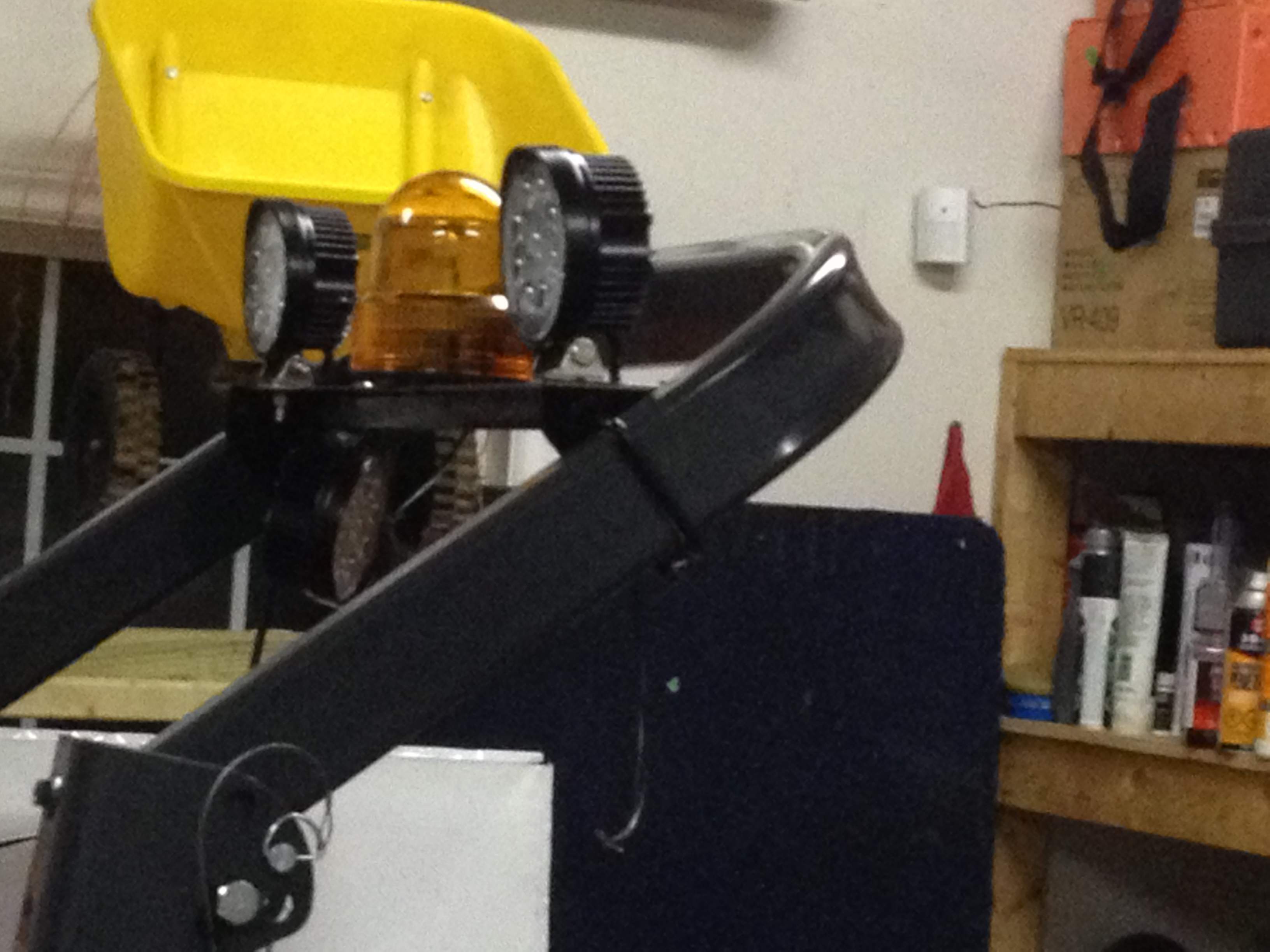

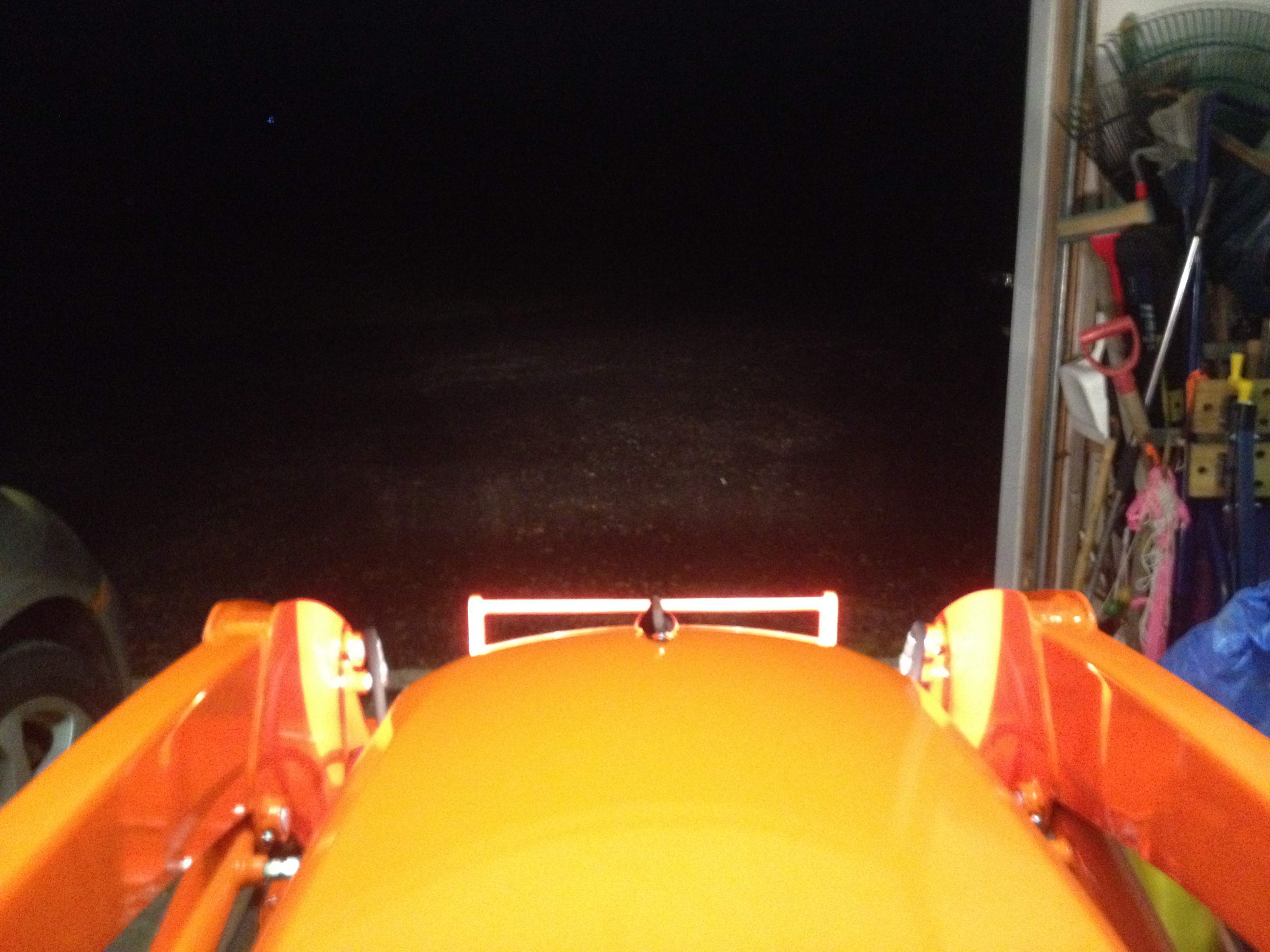

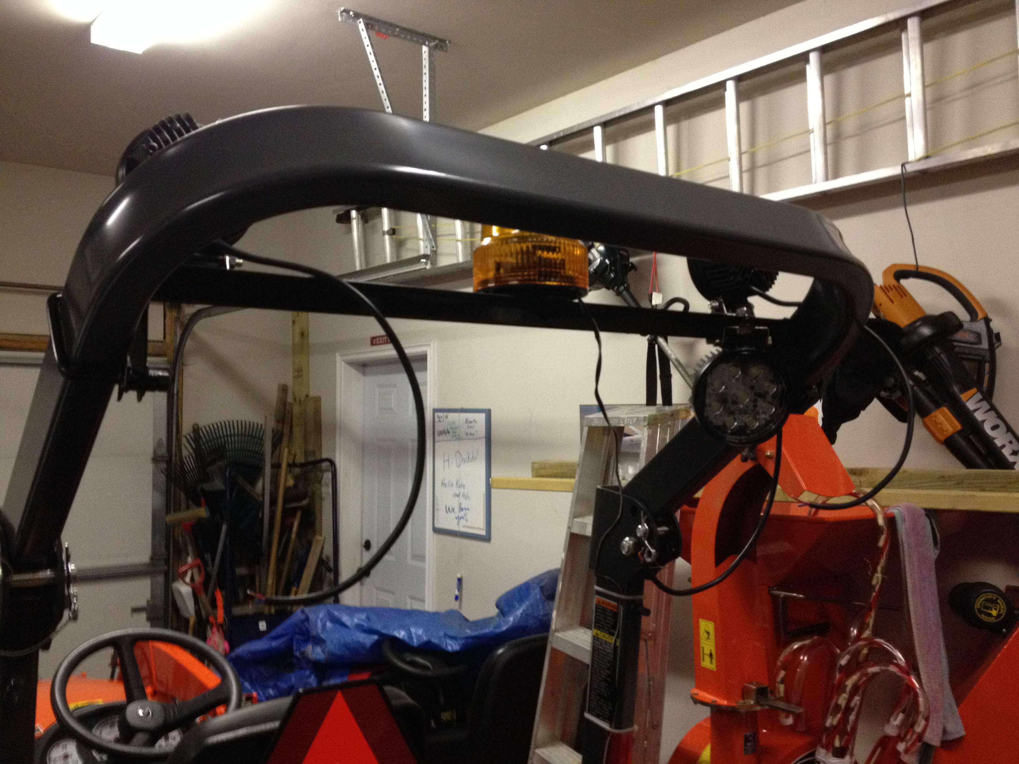

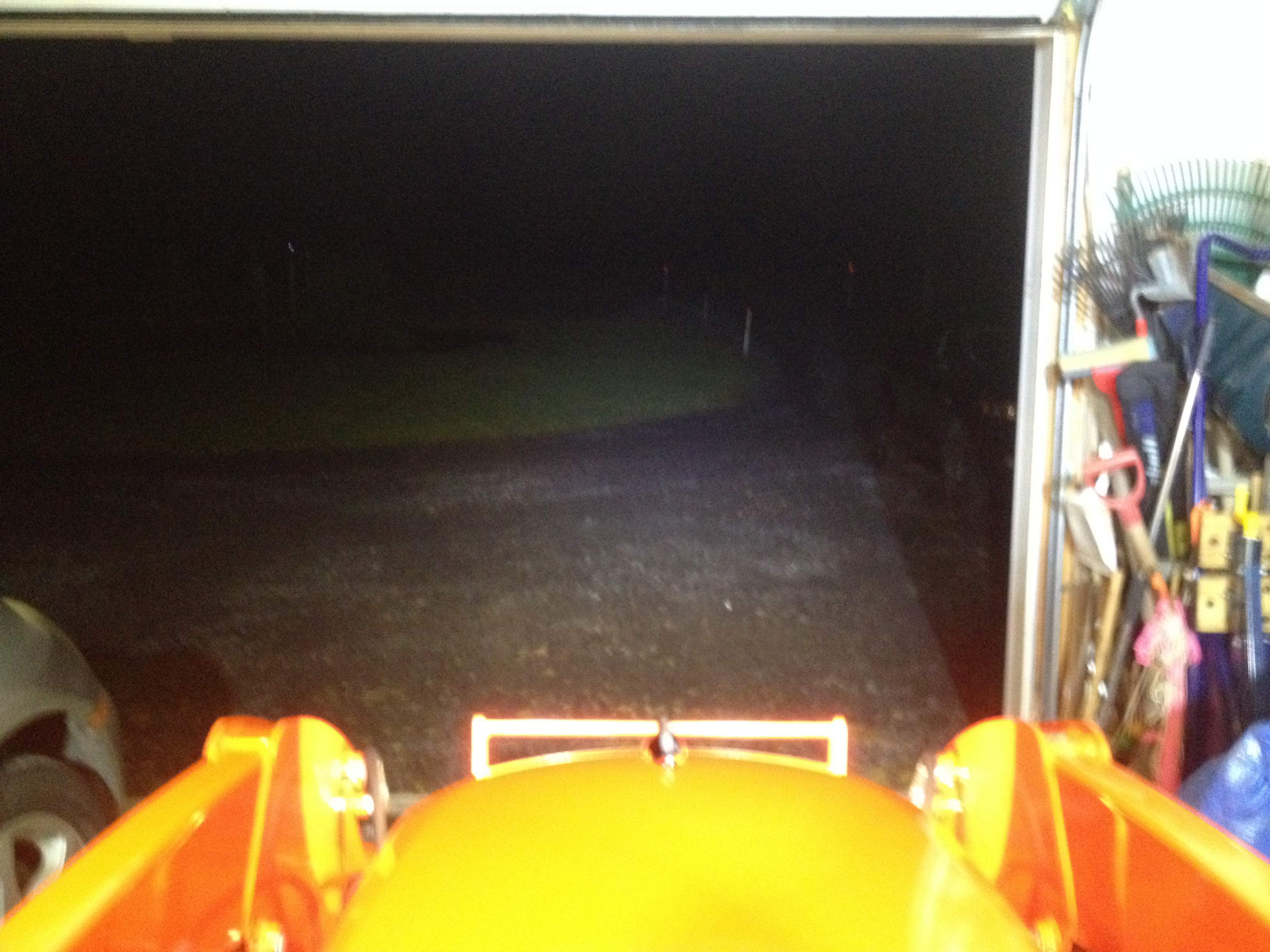

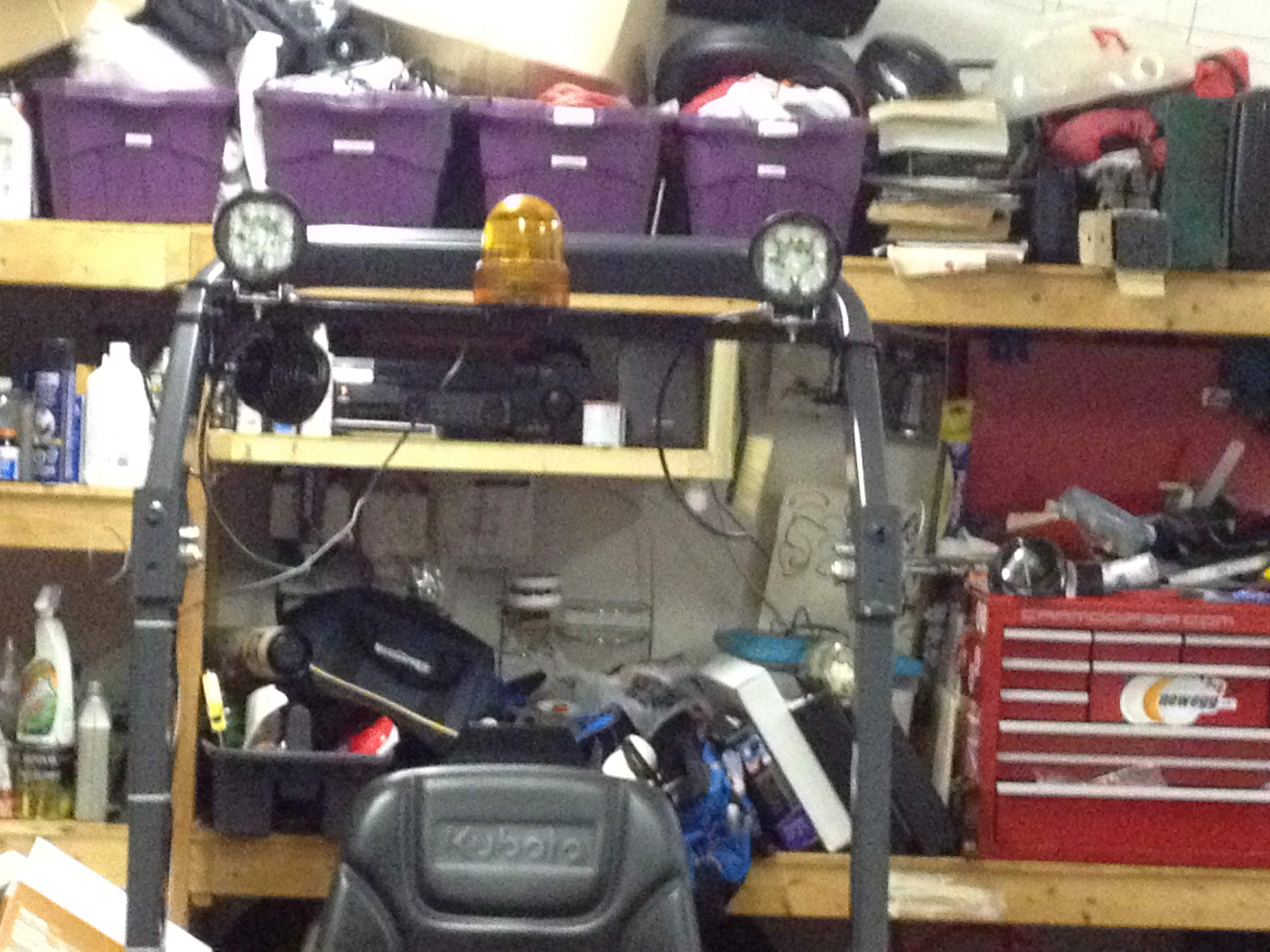

OK here is my first post, I purchased this B2320 last summer. While ploughing snow this winter I noticed the factory headlight were not that great, if you raise the bucket to do anything. It is lights out. So I did a bit of research on this site and got some great ideas. Thanks to all those that posted about this subject. I purchased the LED lights locally, they are 27 watts, add said flood lights, box said spot. I was a bit worried, until i got it all wired up. They seem quite bright to me. If you have any questions please just post the questions and I will help where I can.
Shot from the rear of the tractor, wiring to be finished off.
From the front, I have to have the ROPS angled to get it through the garage door.
Side View,

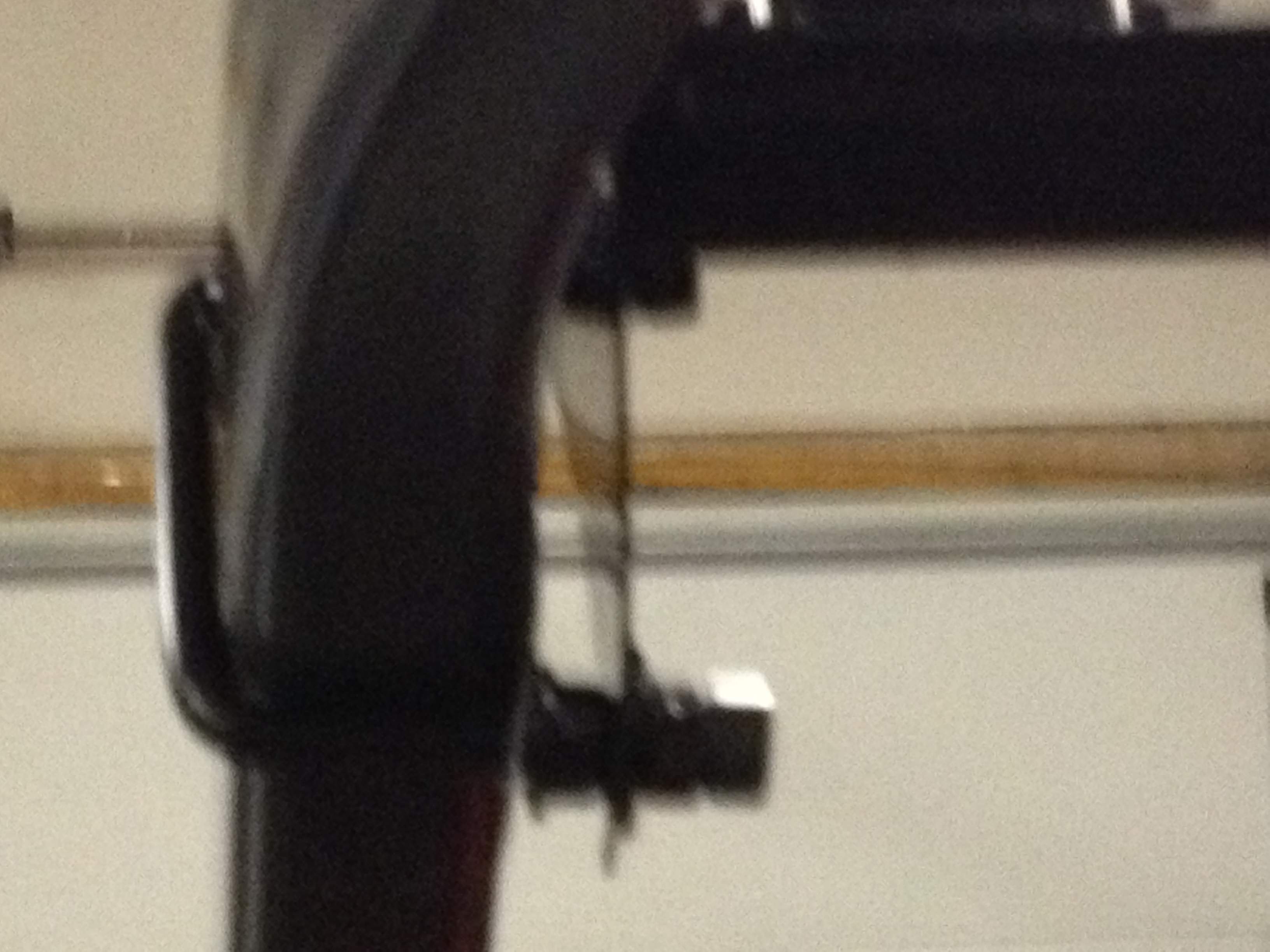

Blurry shot of one of the brackets. :D

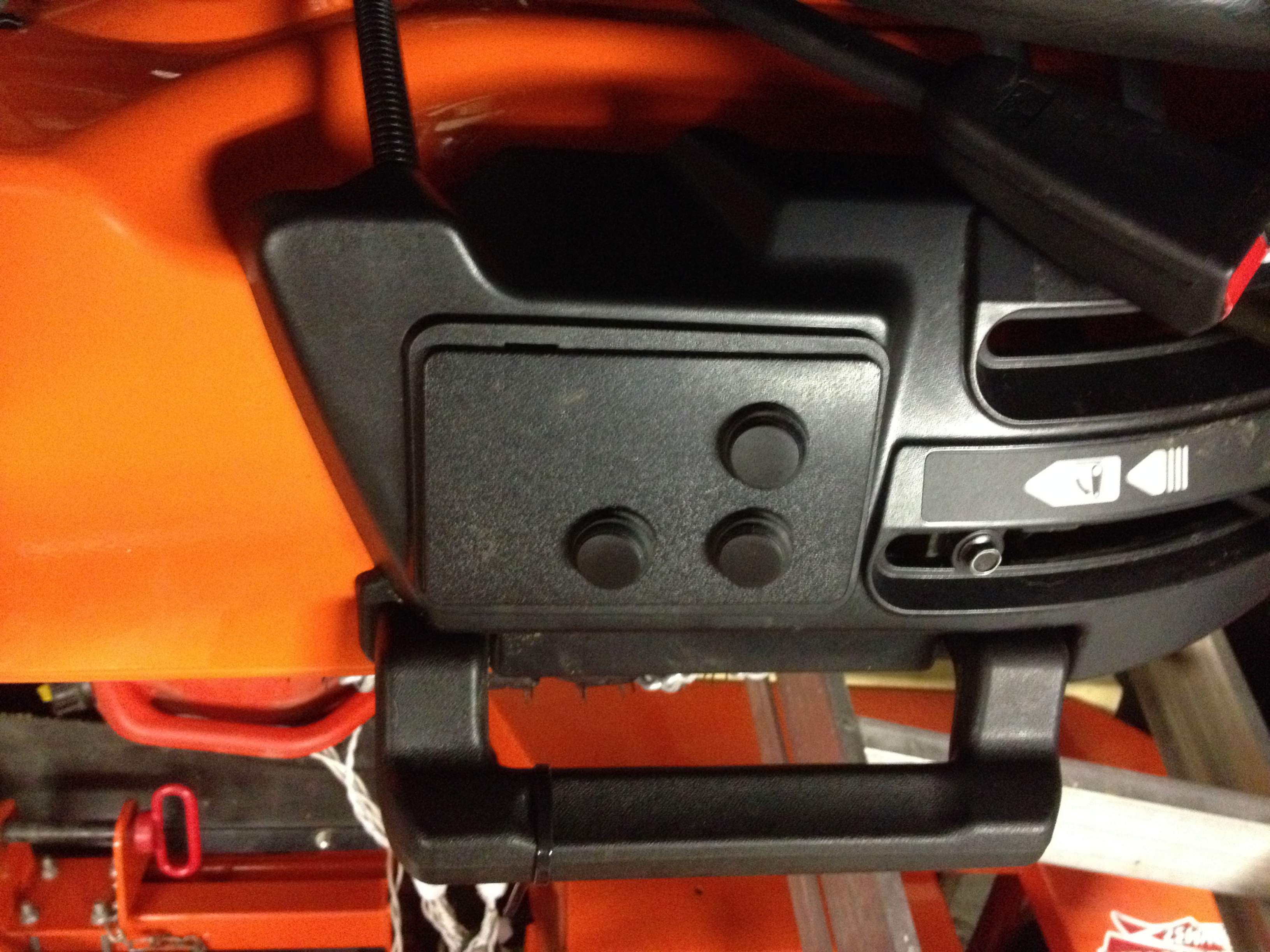

Waterproof rocker switches, one for beacon, one for front lights, and one for the back light. Sorry for the orientation.

Added lights, I would guess they lights at least 3 times farther.:shocked:
Just a shot of the forward lights and factory lights.

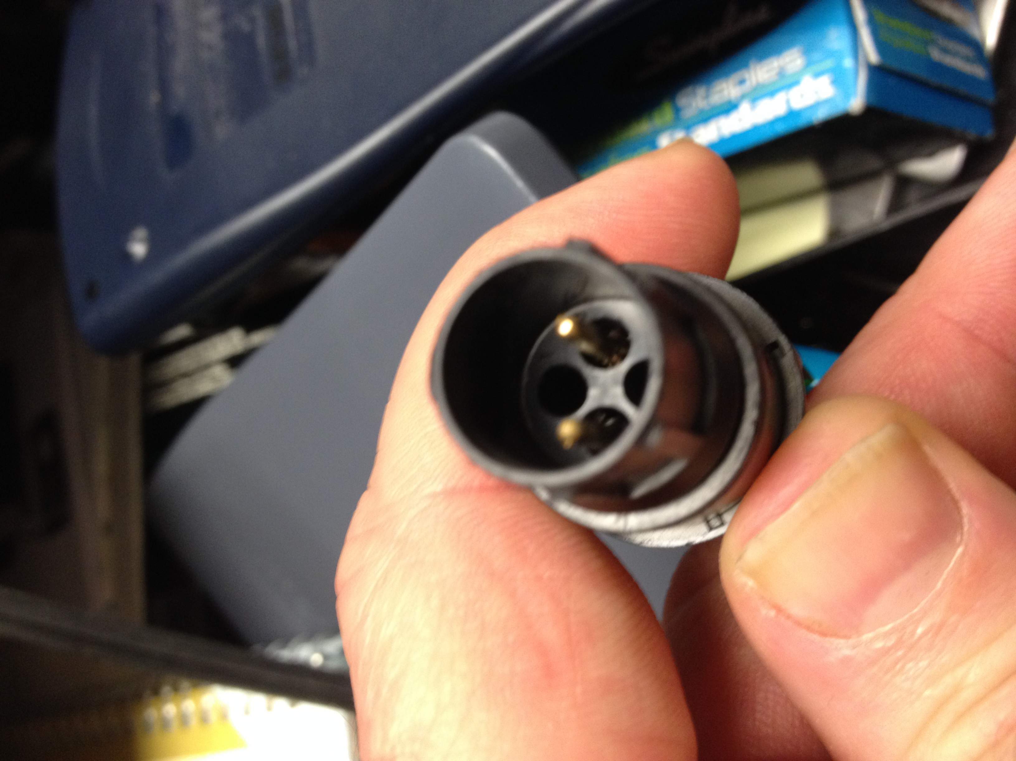

Nice job! I like the switches and good use of a mounting location! I added mine last year and love them! I also bought some 60 led light bulbs to replace the factory lamps but they didn't last. whatis the last pic of? Is that the plug you sue to power everything?
   / LED Work Lights Kubota B2320
The last picture was from a connector from work. New the forums did not know how to make it go away.
Do you have a manufacturer and part number for the switches?

MikePA the switches are made by Cherry PN KCA2ANA1BBB. I wanted to get Amber 12 v illuminated but Newark did not have any in stock. Hope that helps.

Generic marine rocker switches are a good choice -- they will have a rubber boot to prevent water from getting in the works, and should have tin-plated contacts/etc. Places like West Marine will charge $20, but they can be found for $5-8 if you look around.

S219 I looked at marine switches, but around here 3-4 times the cost of the Cherry ones. I liked the size and price think they were about 4 bucks each plus shipping. I also liked the round hole, only a small notch on the side to help prevent rotation. I bought a spare so if one fails, I can replace it.
