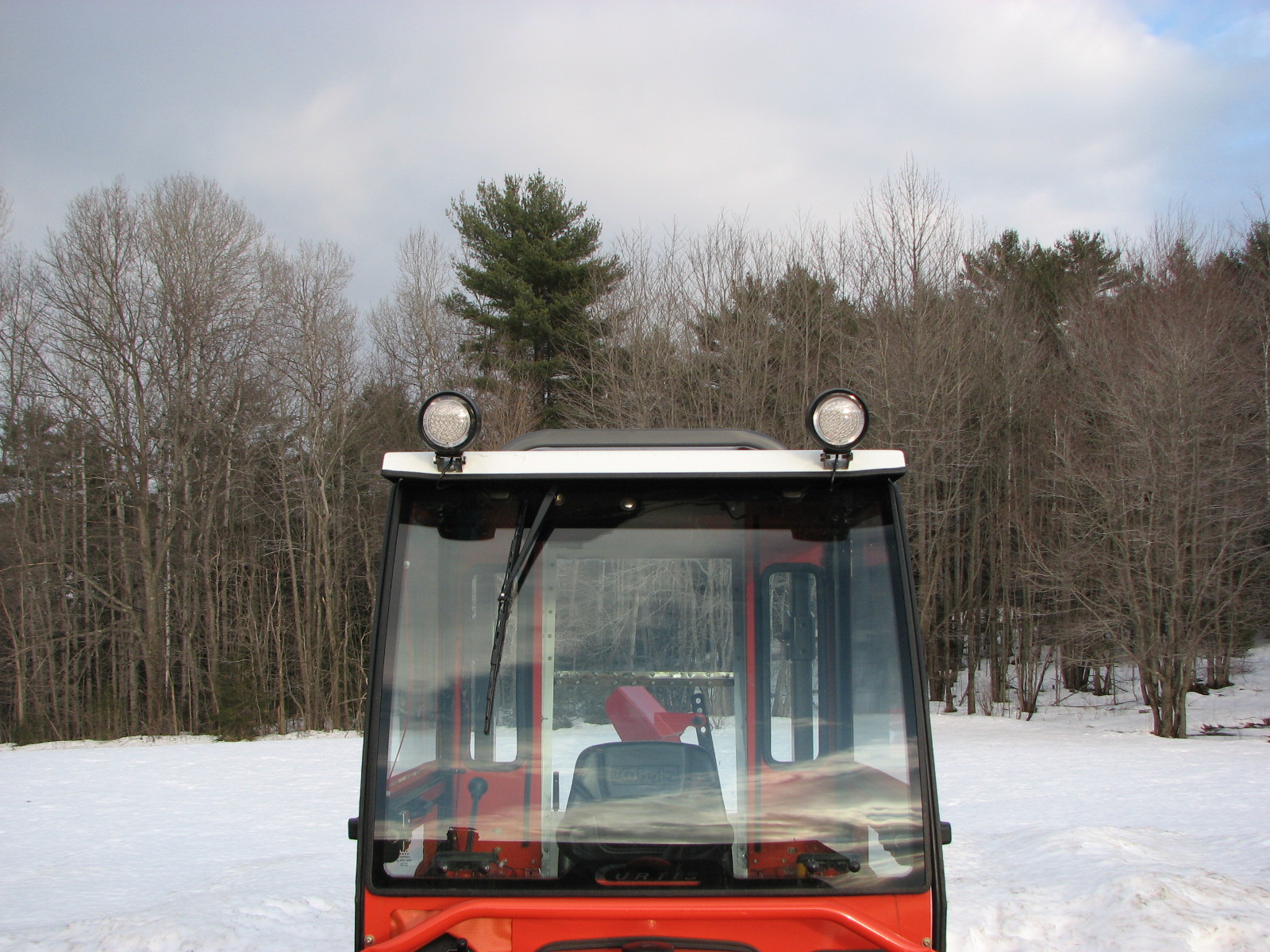

I agree LEDs are the way to go - I used what i had on my last tractor so i used them and although not LED "work lights" I did install a couple of LEDs on my ROPS turning signal bracket so when I vernture out on the street when I plowed snow the on coming traffic will see me. Man are these things bright!

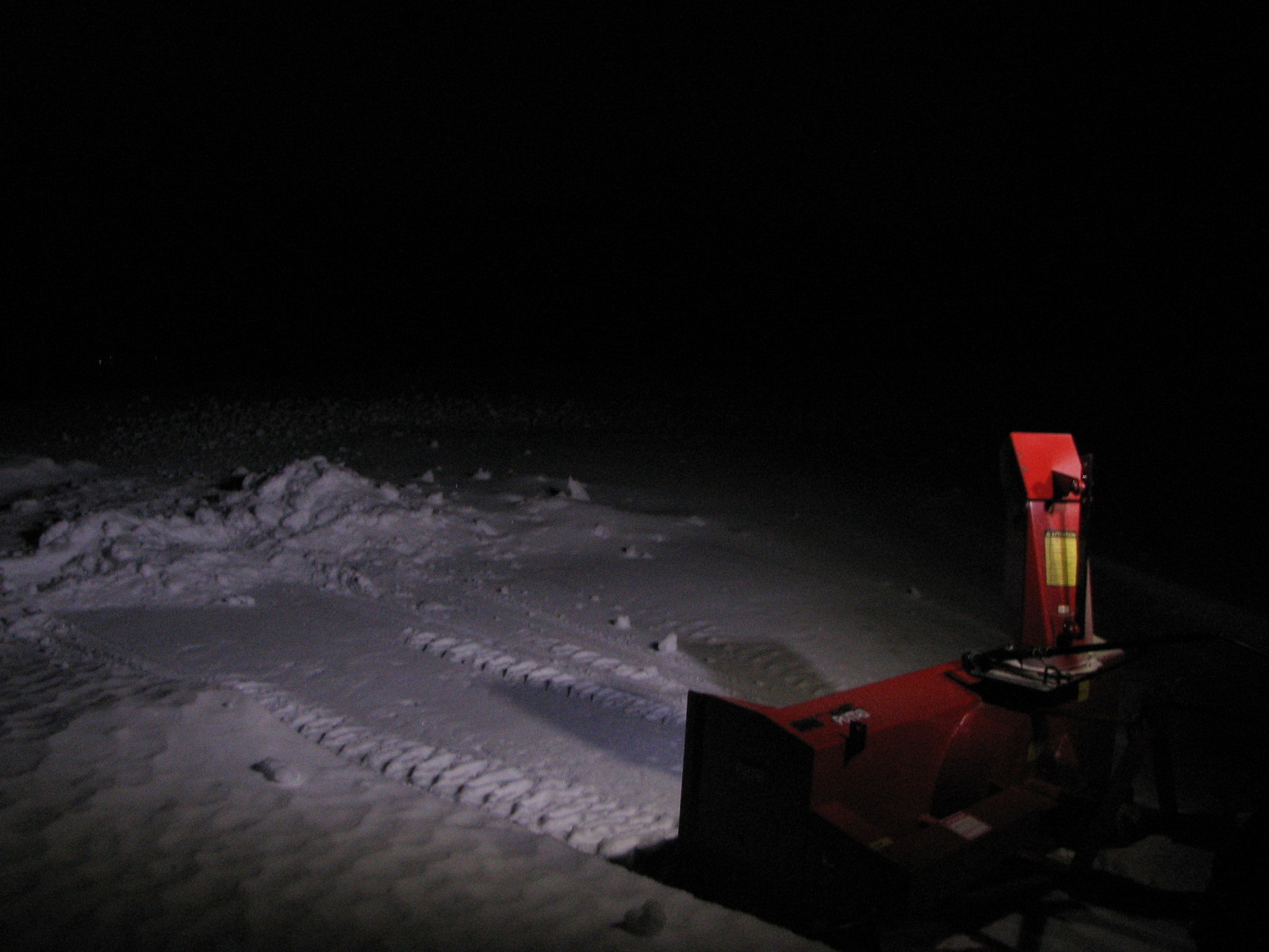

Sorry this took me so long. Couch potato and all. Here are some night shots to give you a better idea of the LED's performance. Very white and bright light. Me like. I turned off all the shop and outside lights except one garage light visible in one pic.

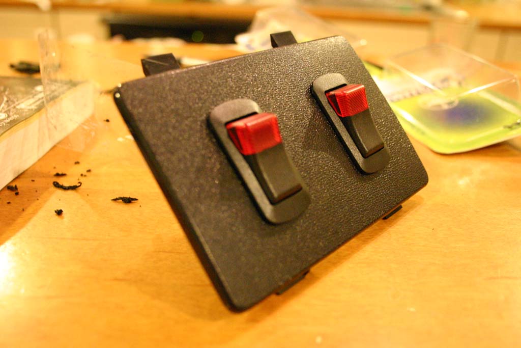

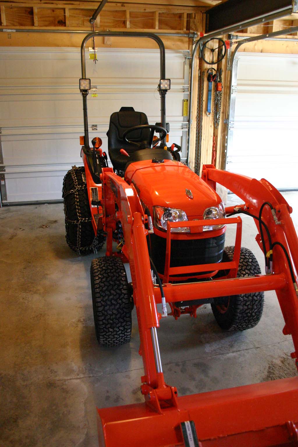

Well, I ordered LED lights from the same company as Just Bob, but opted for the square 18w. I spent a lot of time trying to figure out the best mounting point - thinking originally that the threaded nut welded to the ROPS would work best. But, the problem with that location is that it leaves the lights vulnerable if the ROPS is folded (too high up) - and the design of the base wouldn't allow me to hang them upside-down, as the ROPS is angled backward, which would have resulted in the lights pointing toward the sky. So, I decided to mount the bases to the hole just underneath the threaded nut - man was that a hassle! If you look closely, the hole has the lower ROPS edge just behind it, so you can't stick a bolt through from the backside and you can't get a nut in either since it has very little depth. I finally found an M6 bolt with a hex head that I could tap into place from above using a punch (stainless, which was soft enough to knick the edge and force in from the back).
Wired them with a fused relay, even though they draw very little and bought a waterproof, lighted rocker switch from VETCO. I put the switches in the plastic plate to the right of the seat, just behind the 3pt. lever. Overall, I'm very pleased with the installation - I'll just have to see how bright they are tonight. The bumemr is that one of the LED units has 2 of 4 lights blown, so I'm going to have to exchange. Naturally, this requires resoldering and rerunnig the zip ties. Oh well.

Well, I'm very happy! These lights are unbelievably bright. They make the stock lights look like a nightlight in comparison. In fact, there's no real need to turn on the headlights. And, unlike my John Deere, the positioning of them on the ROPS doesn't blind me in the corner of my eyes. On my old tractor, I had to take a pair of old trailer license plates and zip-tie them to the ROPS:
http://www.tractorbynet.com/forums/...-2320-work-lights-december-31-2007-january-22
Anyone with $150 burning a hole in their pocket should consider them. And if your budget's more like $75 (as mine should have been), I can tell you one lamp assembly's enough!

skywaterbanjo -
The lights came from the website that Just Bob listed on page 1 of this thread (second posting down). Autolumination.com. They're the 18 watt square ones.
The switches came from vetco.net and are part number NTE-54-231W (red 20A 12v waterproof rocker switch) at $8.30 each.
The fused relays are Hella, available from any local shop that sells Hella lights. I'm sure any autoparts store has an equivalent, but over the last 20 years of installing auxiliary lighting on my cars, trucks and tractors, I've only used Hella relays without fail to date.
