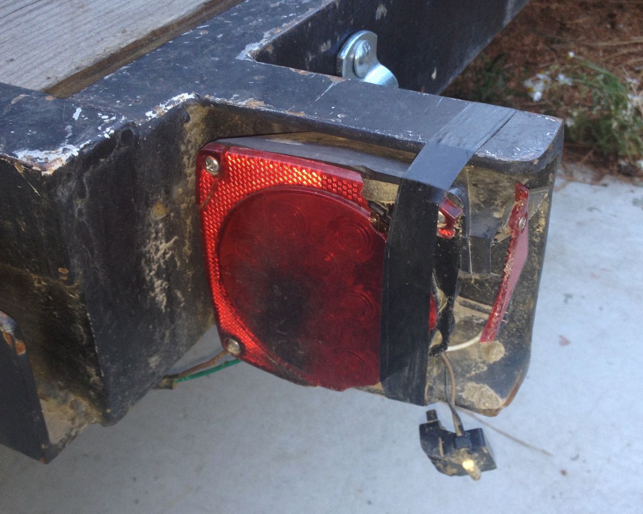

Original talillight, all busted up (as expected). (This is an LED taillight)

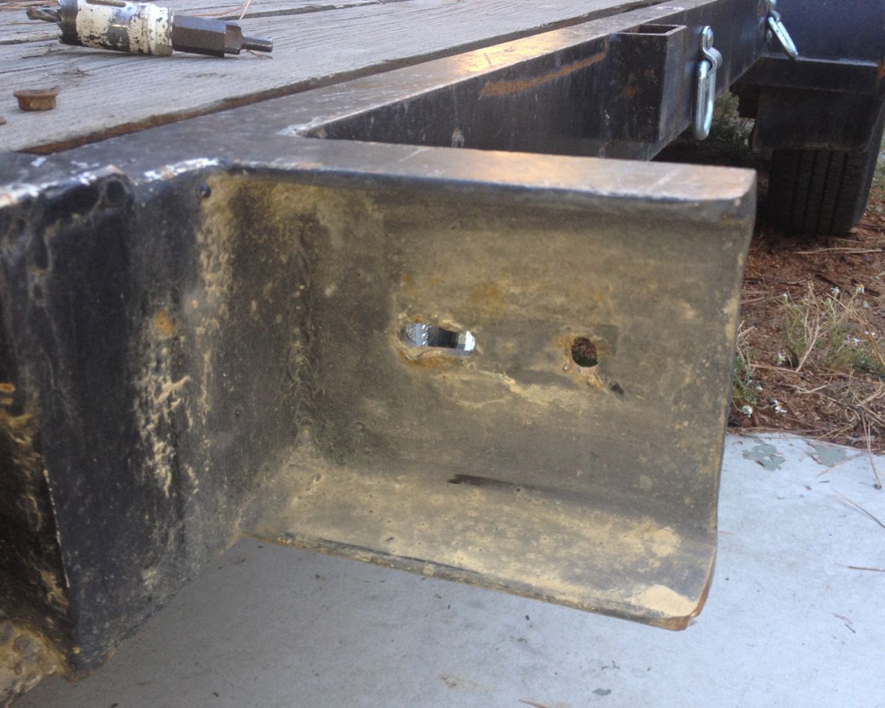

Taillight removed from 5" channel bracket.

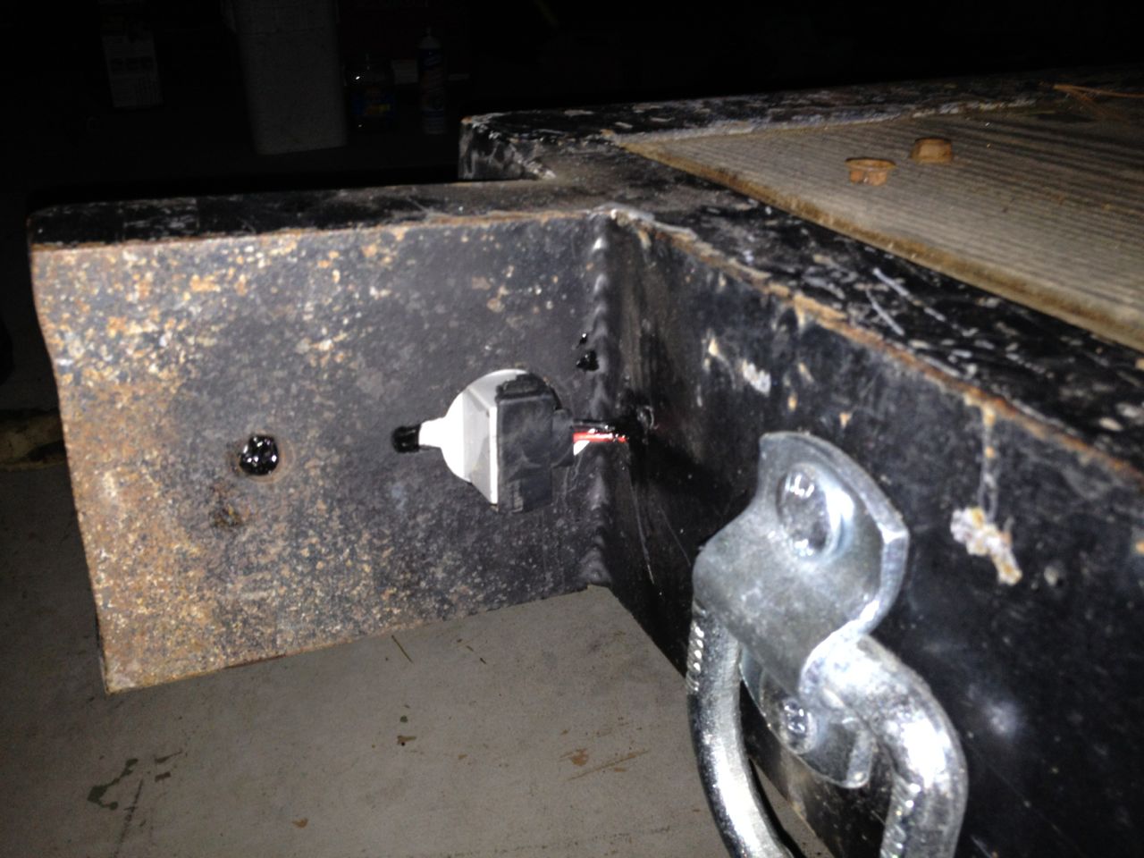

1 1/2" holesaw for new taillight plug.

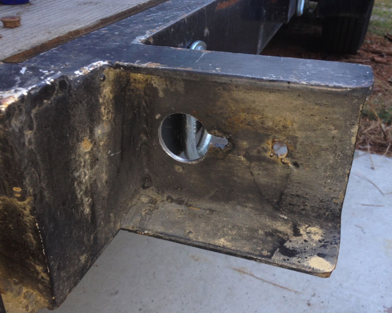

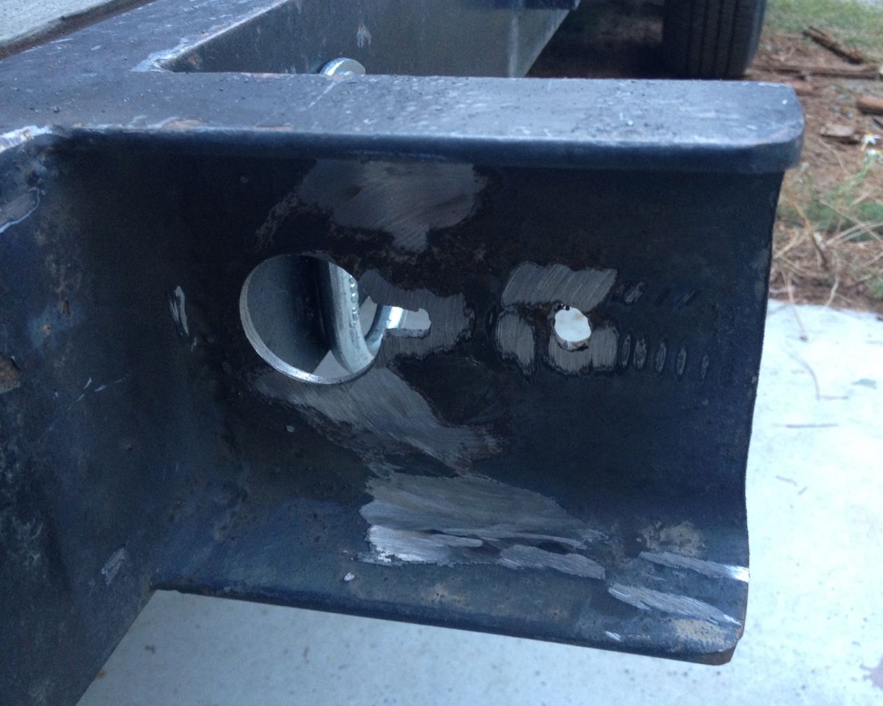

To set a 4 5/16" round taillight into the 5" channel I had to grind a "relief" in the draft of the channel.

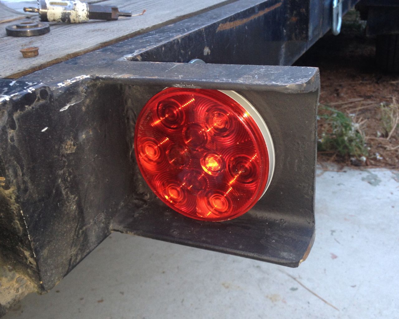

Taillight glued onto 5" channel bracket with silicone.
![30lightbackside.jpg 30lightbackside.jpg](https://www.tractorbynet.com/forums/data/attachments/361/361760-9380eae6409b9b666c3255dc2b64434f.jpg)
Here's the 'frontside' with the plug. I've siliconed everything, sealed it all up with the notion that I will never have to replace it or disassemble (to change a bulb) ----> Fingers crossed that this turns out!
Next project is to weld a grating over the taillight to protect it.
The HF taillights are BRIGHT! Hope this helps someone plan a trailer lighting upgrade.
