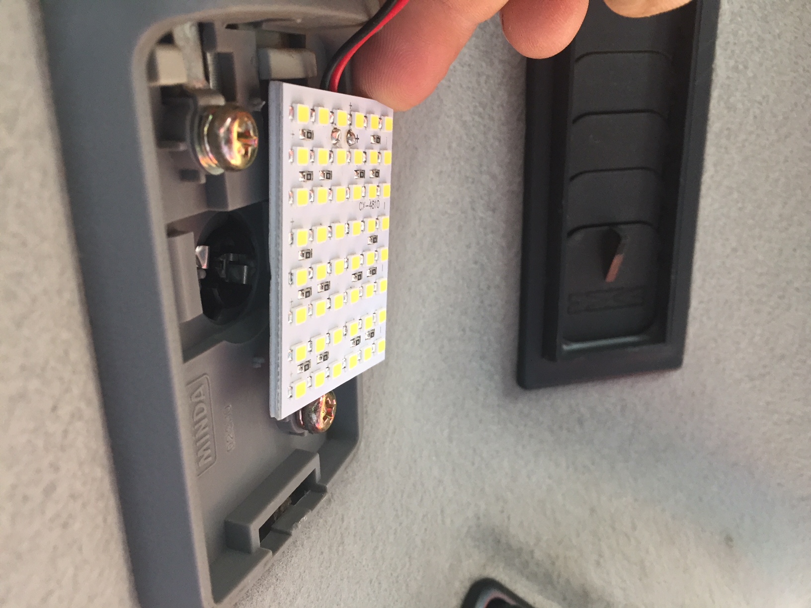

My explanation of which lights might have been off. I’m looking to replace th entire assembly of the two lights at the top. IMG_1105.JPG
