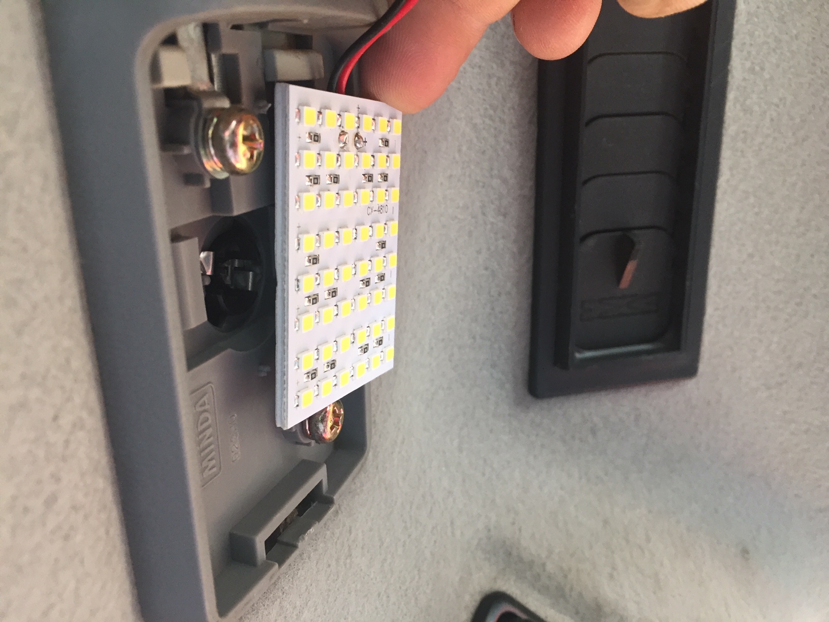

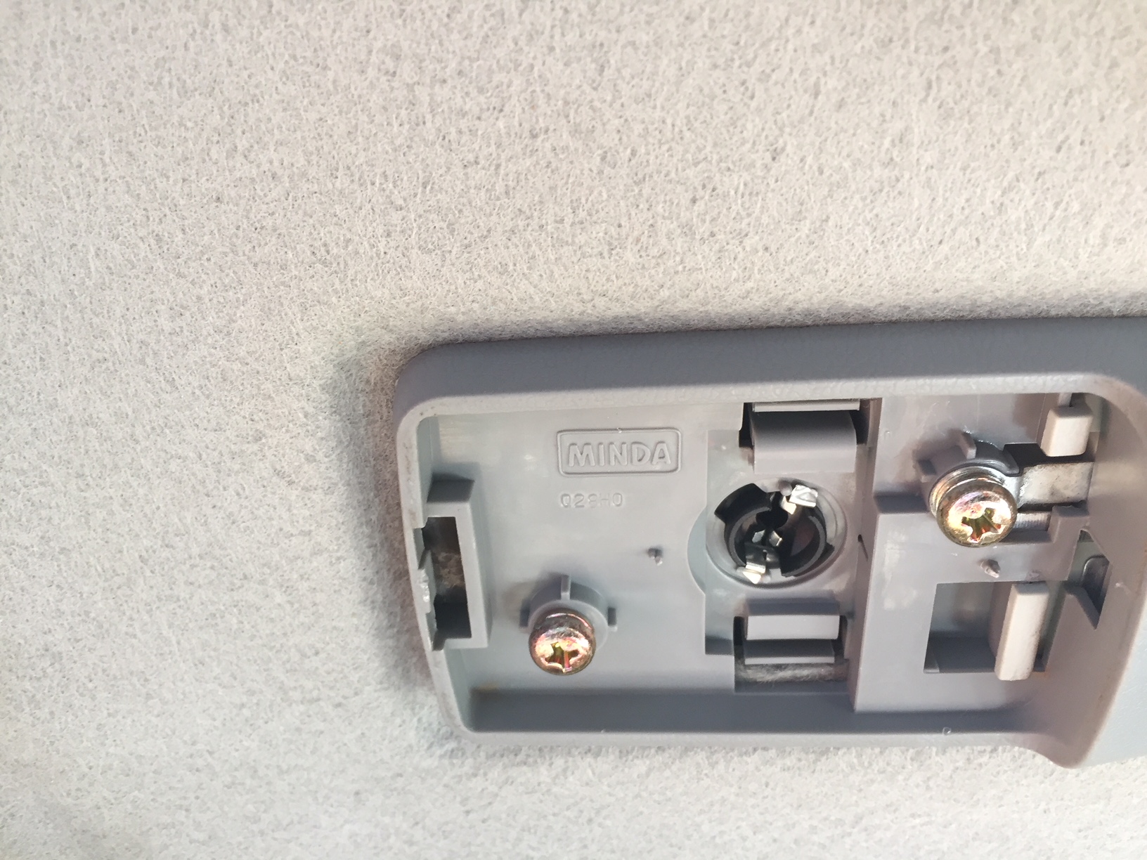

I bought the same LED for the dome and was wondering how you mounted the LED inside the housing? There isn't a flat spot to mount using the 2-Sided tape. Did you just lay it inside the dome cover?
Perhaps the photos will help describe the situation.
Sorry for the flipped picture below.
   / LED light replacement for cab M7040 of other
#15
It is the right size to just lay inside the dome cover. I知 not sure how hot it would get if I leave it on a long time, but I tested it for a few minutes before I put it together with no issue. It amazing how bright these LEDs are.

No heat problem with LED dome light. Mine just rests on the original lens.
I had tried various LED models on my car but was very happy when the conversion you and I both have in our tractors performs.
Some people have had flicker problems with larger LED lamps. I suspect there are many levels of quality.
Some early Kubota's and garden tractors used alternating current for their lamps and only rectified a portion of the charging system output to look after the battery.
Conversions to LED's in this situation is unsuccessful.

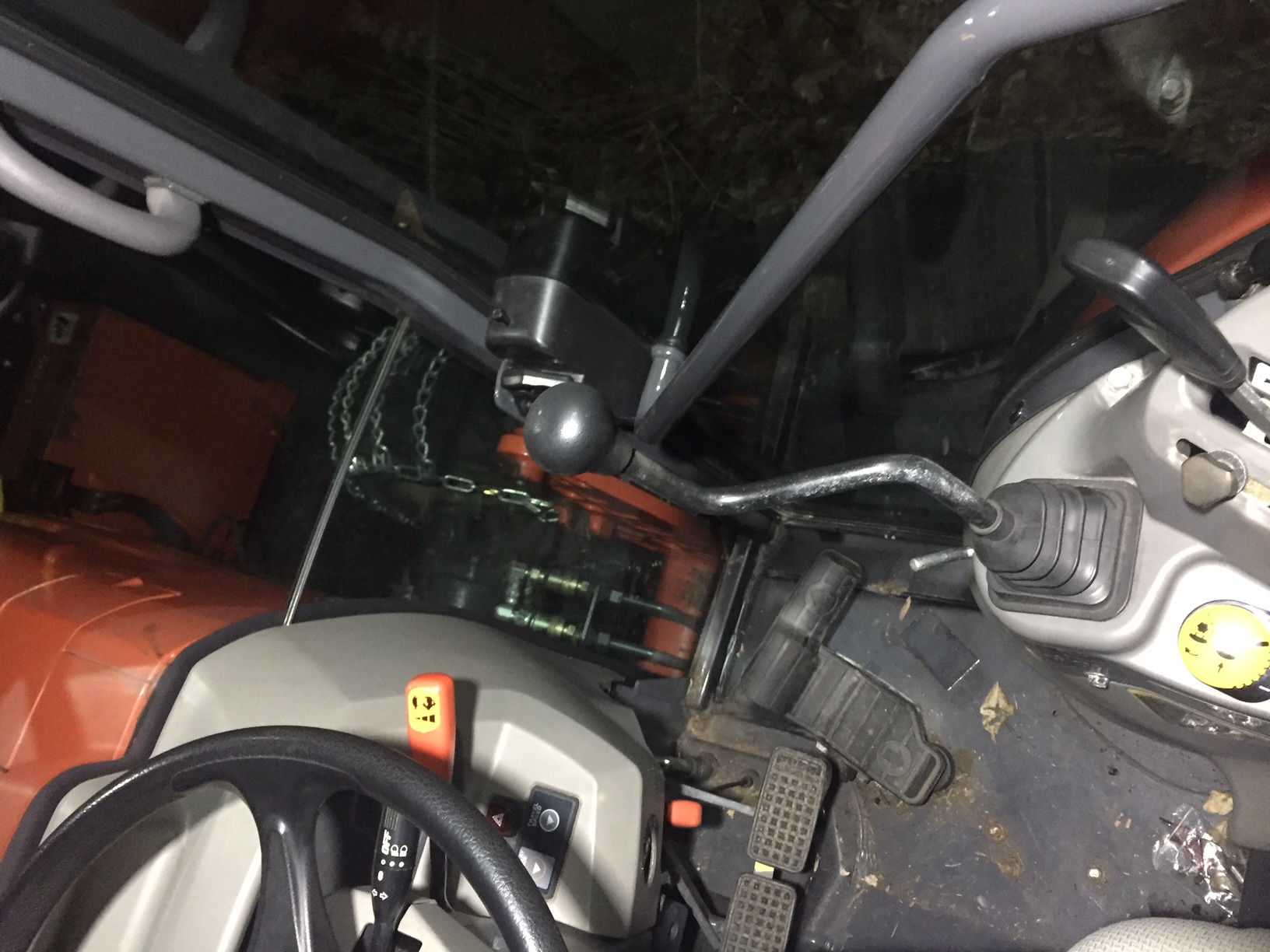

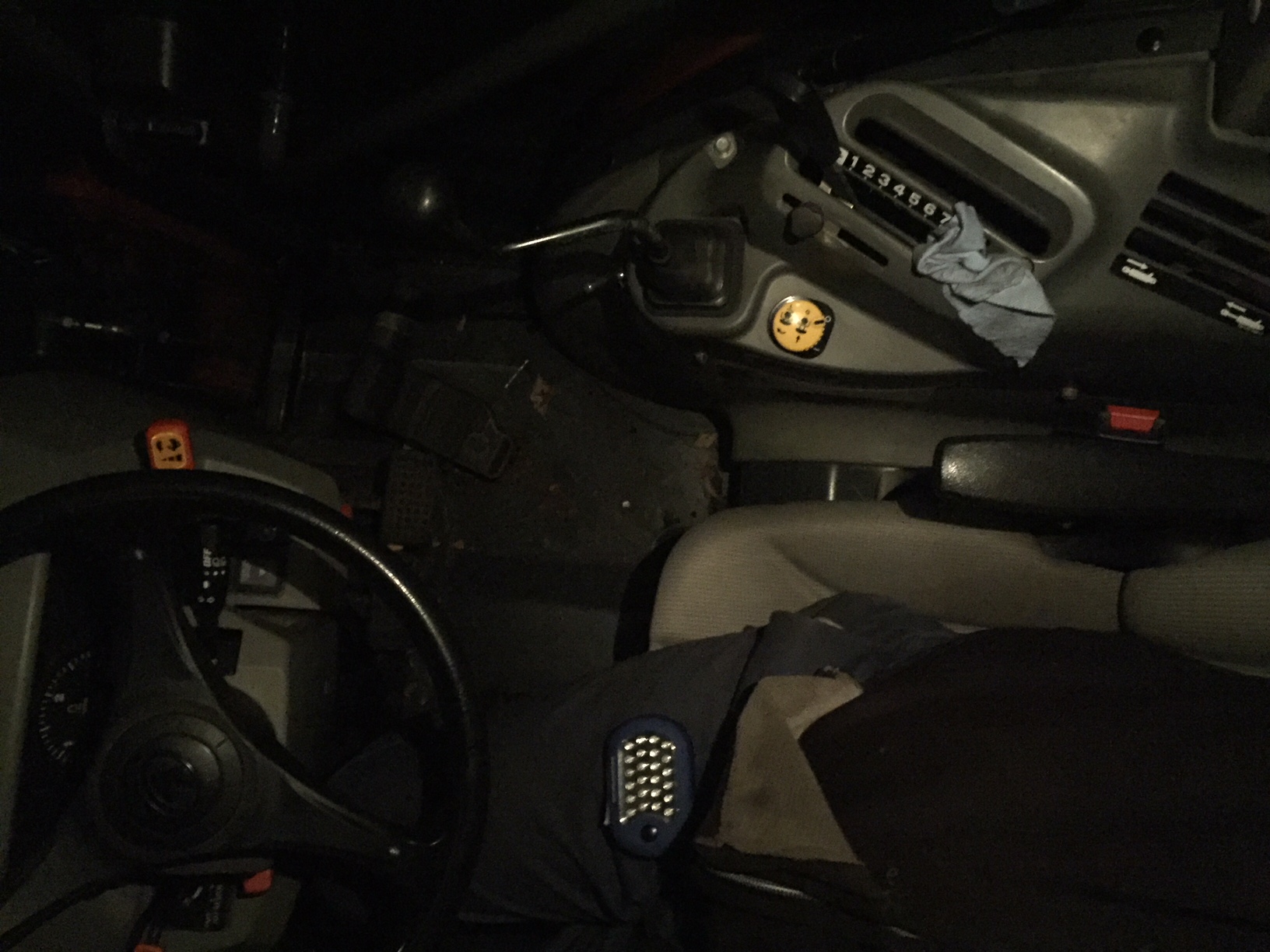

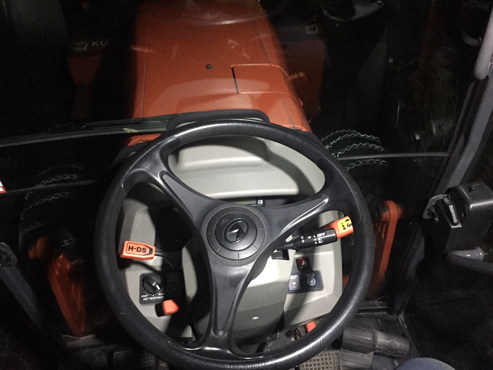

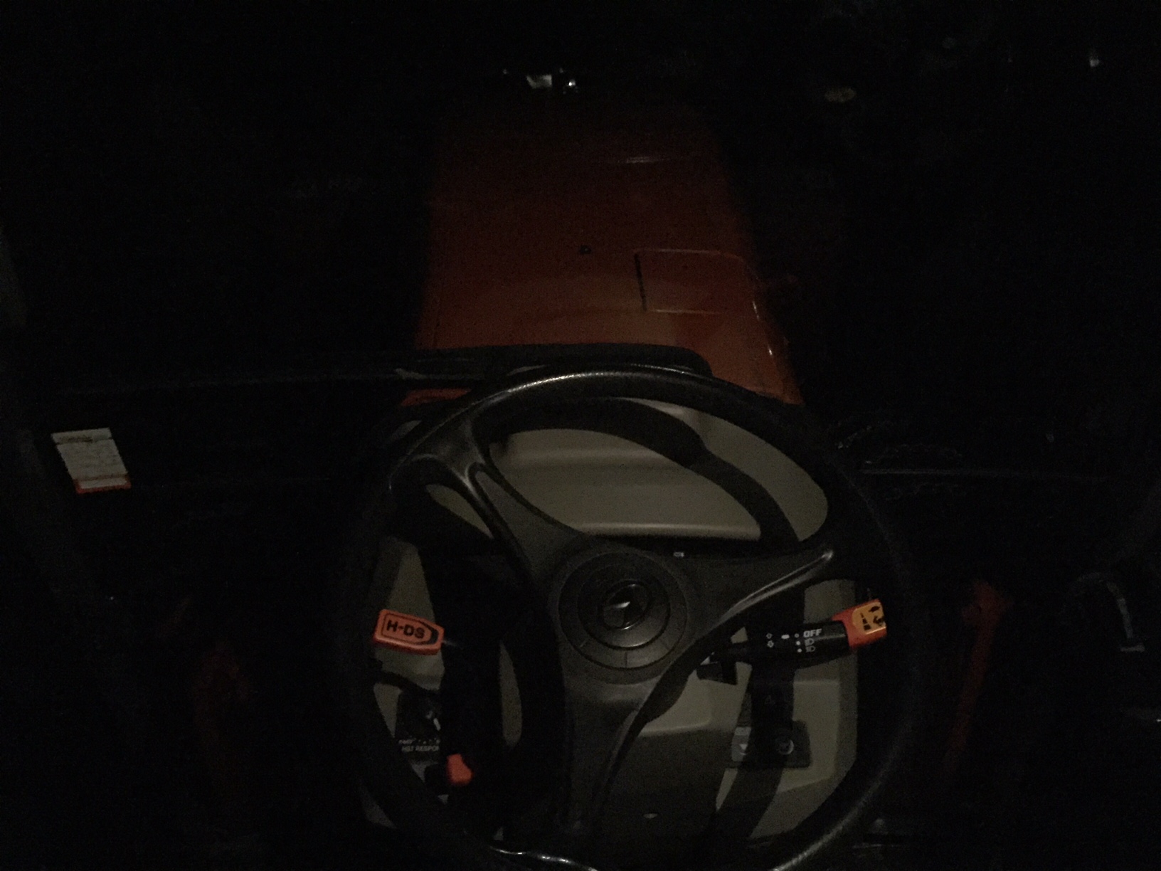

Here's a quick test of the stock bulb versus the LED module described in earlier posts. The light cover was not in place for any of the photos.
Stock Light
LED
With the way camera phones try to adjust the picture given the ambient lighting, I feel the photos understate the true difference and the LED's are way brighter.
