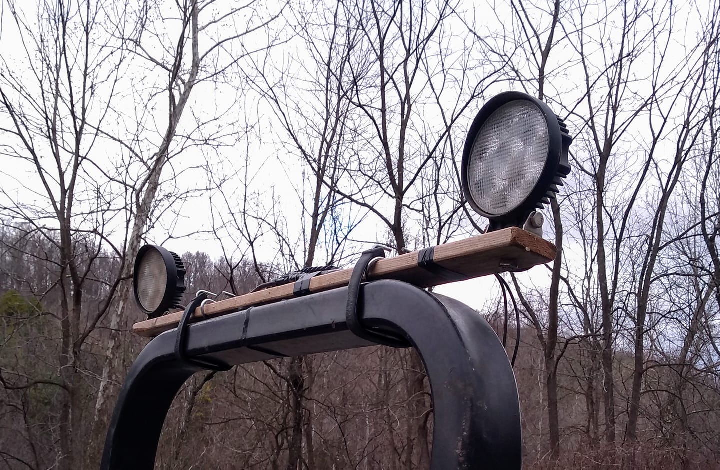

I need the lights for my 3038e only occasionally - usually for plowing snow at night. I have to get ahead of a heavy snow because my CUT with bucket and blade can't easily do more than 6 inches at a time... Long gravel drive - one full mile through a forest. So I mounted lights on a board and bungeed it to the top of the ROPS - 2 forward lights and one back. It plugs neatly into the empty aux plug on the tractor and is activated with the existing switch. Works like a champ. And I can take it off easily when not needed because I do a lot of work in my forest and the limbs will knock off anything on the ROPS, under it or over it. A simple and cheap solution for me.

That works! :thumbsup:

I did the same to my JD 855. Mounted the LED's to inside the ROPS, but used stainless hose clamps. Hold just fine. Power is direct from battery, so not relying on key being in/on. Need to add one pointed backward and switched separate, still...
------------ Easy and simple is always the best..
