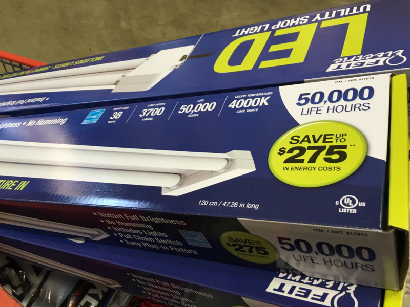

OK, I went to Lowe's and bought a 4 foot LED light today for $45. This 4 foot LED light gives off 3,600 Lumens of light and is a lot brighter than the 8 foot double bulb Flourescent light it replaced. It is a flush mount light. There are no bulbs to replace ever. They claim to last up to 35,000 hours. It is a 40 watt. I need 3 to 4 more them. Anyone need to buy some old used heavy 8 foot double bulb flourescent garage light fixtures?

I'm at Costco now. Buying 4ft LEDs with fixture for $29. Was just going to buy bulbs but they were on sale at same price so going to add more lighting to garage instead! Will compare brightness and RF interference this afternoon.

We are going back to Lowe's Hardware and get 4 more of the 4 foot LED lights:
(40 watt, 3,600 Lumens, last 35,000 hours)
I hope to have them all installed by the end of the day. This is a nice upgrade to the garage. The wife and I spend most of our awake hours doing projects in the garage and I think she is more excited over these lights than I am.

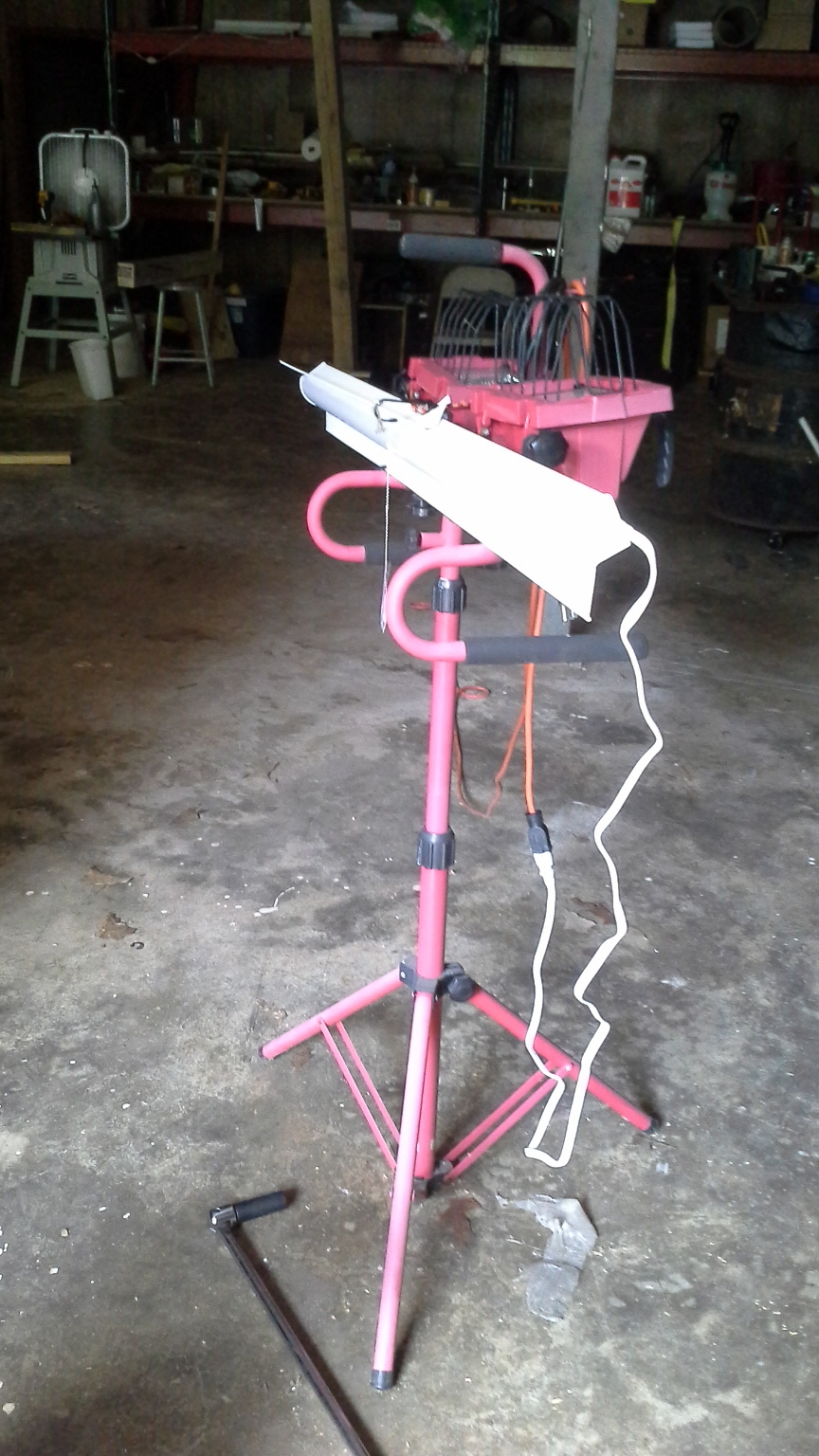

I had been wanting an LED dual headed work light. I've got an old HF halogen.
Voila
Main reason I did it was because it was so hot last summer using the halogens was cooking me.
