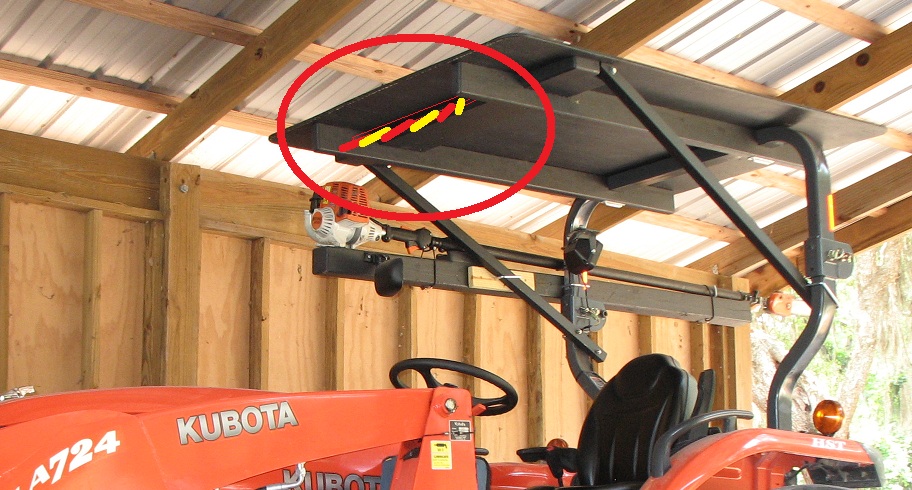

Well, we're gonna find out. Preliminary write-up/ plan here, with pics, results & discussion to follow.
I bought a couple 3-packs of small but very bright handheld LED flashlights at HD. (The package comes with the 3 flashlights, 2 of the strap-on LED head lights, & 15 Everyready AAA batteries (3 for each light) for $14.00)
These little flashlights are very impressive! It dawned on me that I might able to line them up & mount them on my tractor's roof for added lighting since the loader blocks the headlights.
I've been hesitant to buy the standard fixed LED lighting units because 1) they are darn expensive, and 2) I wasn't sure what the beam result would look like or how bright they'd be. If I knew for sure I'd be happy with what I'd be getting, I'd pony up.
I'm going to attach 6 of these flashlights to a 2x4 & bolt that to my tractor roof with a single lag bolt going into each end of the 2x4 so that I can just reach up & pivot the whole thing up or down in order to focus the light where I want it in front of the tractor (in closer or out further away). Also, each flashlight will be mounted separately on a single bolt so I can rotate each one to point where I want it. I envision all 6 being oriented evenly across the front of the tractor for a somewhat uniform amount of light.
Last night I turned off my headlights & drove around using just one of these flashlights, & it was amazing. That 1 flashlight is as bright, or maybe even a little brighter than, my Kubota OEM headlights. I'm excited to see the light output of 6 of these.
The on/off button is on the back of the flashlight, so I will have to reach up & hit 6 buttons if I want all 6 on at once. On the other hand, there may be times when I don't need all of them. We shall see.
Like many flashlights, these allow you to focus or widen the beam by turning the lens end of the flashlight.
Some things I wonder about:
- How long will the AAA batteries will last? I may wish these could be wired into the Kubota 12V system, & if I love this setup, I'll look into that.
- Will the flashlights stand up to the sometimes harsh bouncing of the tractor?
Anyway, pics & results to follow ... Do ya'll think it'll work?
The 2x4 mount will be bolted between the two vertical 2x4's in this poor pic I tried to draft up:
attachment.php

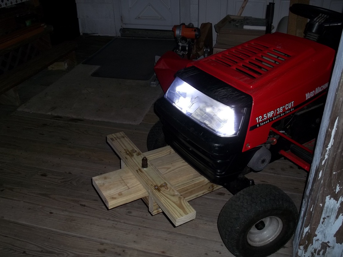

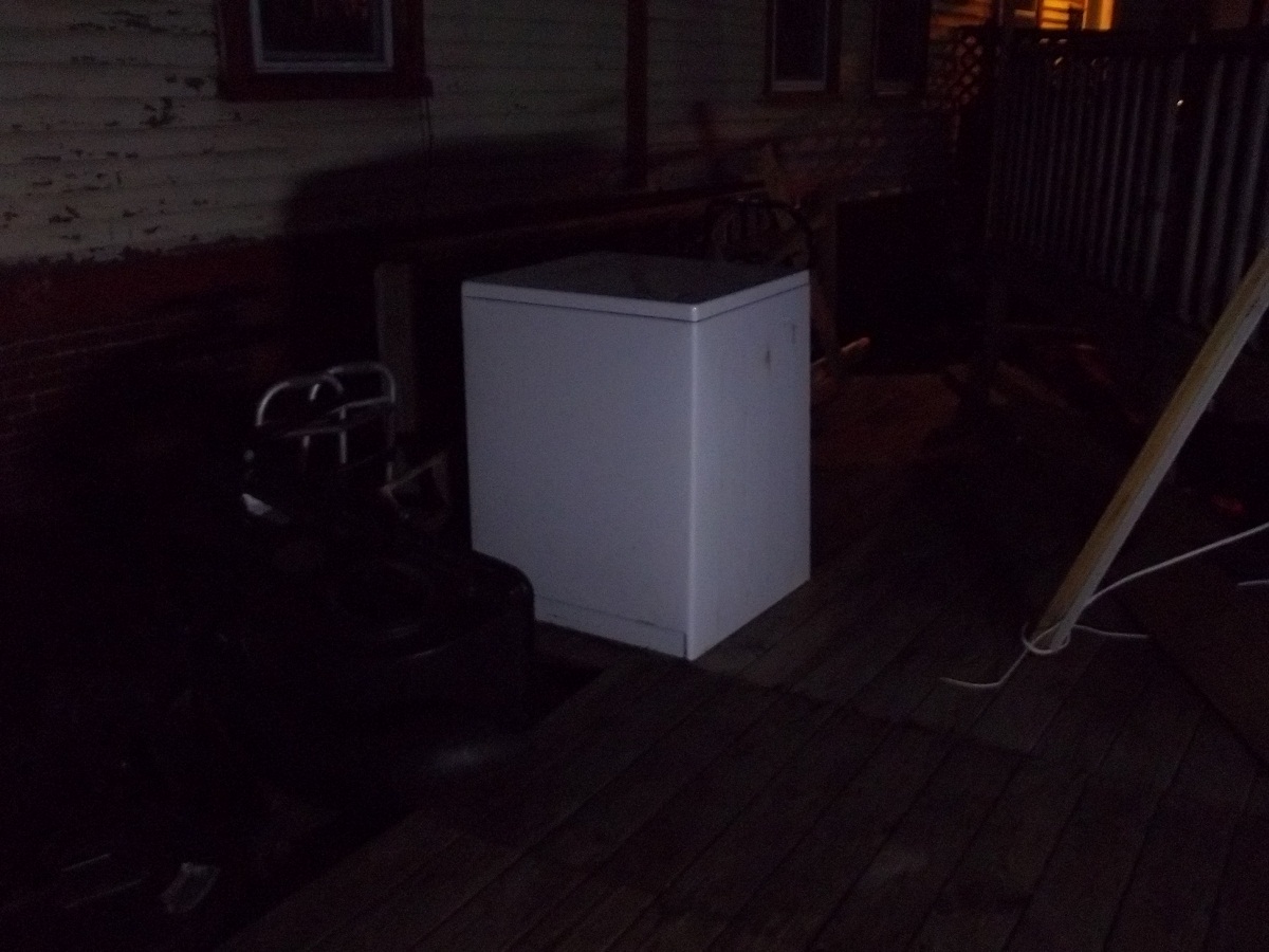

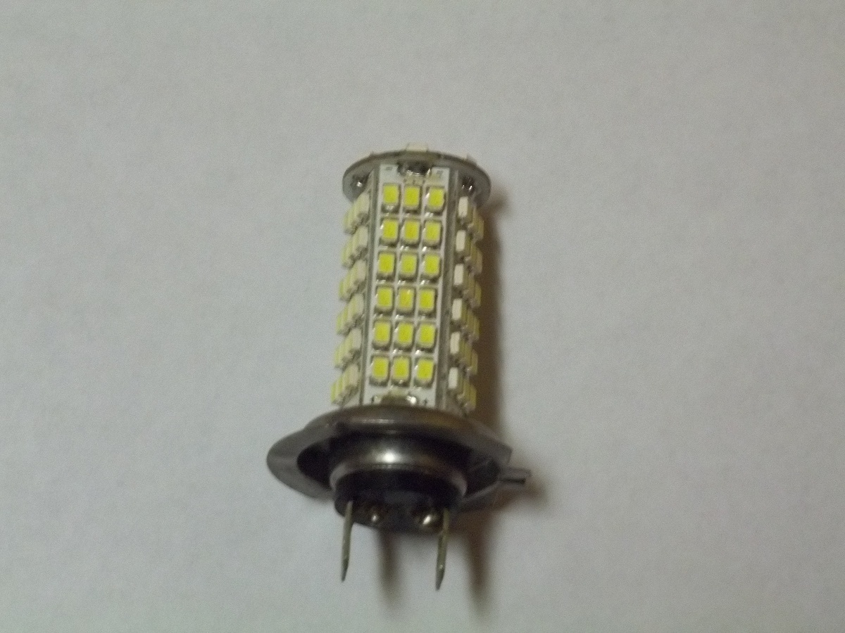

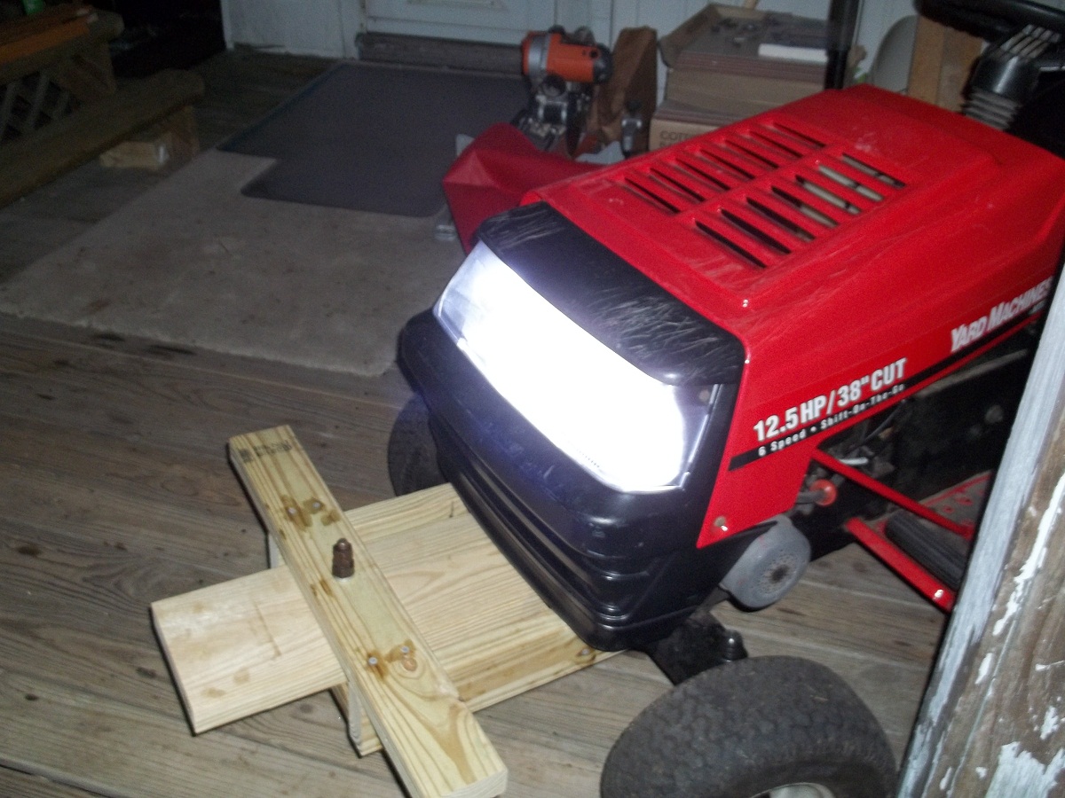

Hi, I hope this will help you :)
I recently put 6 LED's in my Lawn Tractor (See Pix below). Got them on Ebay for $6.45 for 2 of them. It's called H7 Car 102 3020 Chip SMD LED about 400Lumen each Example... Ebay Item number: 330661662827.
NOTE: Do NOT get the one that is 3528 Chip SMD LED, they suck alot of power and give you less light.
I made 2 just regular light, and then 4 on High Beam with a switch on my Tractor. Mouse over the Pix to see Descriptions and Info. Also I enclosed a Sample of Solar Light Encloser I remade, maybe give you some idea...

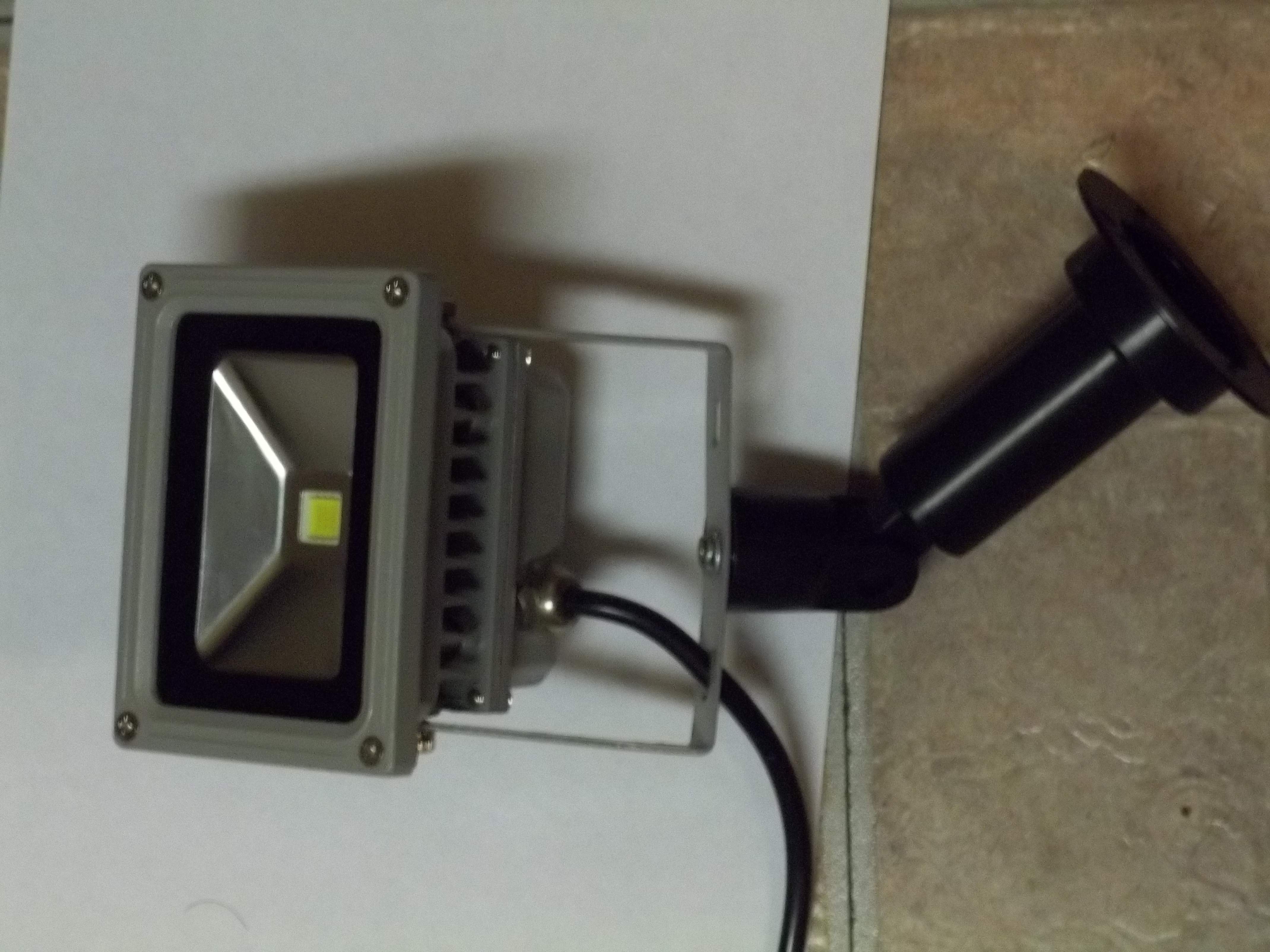

I suggest you to buy the 10W LED Spotlight / Floodlight (Last Pix) also it's Waterproof, it's cheaper $24.00 on Ebay (Even Cheaper now $19.00 Item number:120827918357) and you can just hook it to your 12V Lights on your Tractor, just put a switch so you can turn off and on that is all, also rated at 1000Lumen Cool White, which is bright and I might put it on mine soon... For Back Up in the Snow Storm :)
I think you bought what I did at HD, it's called CREE LED if i'm correct. They are bright for their 1W. But they said the Battery will last only 2 Hours most, for 3xAAA. Another thing you can do with these is Connect them in Series... That way you can use them right from your Tractor 12V. Just connect them 3 each since they are rated 4.5V per bulb.
Any questions, just ask... I have done bunch of LED's... Including my house and I have pix to prove it, LOL
Hope that will help!

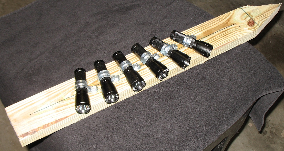

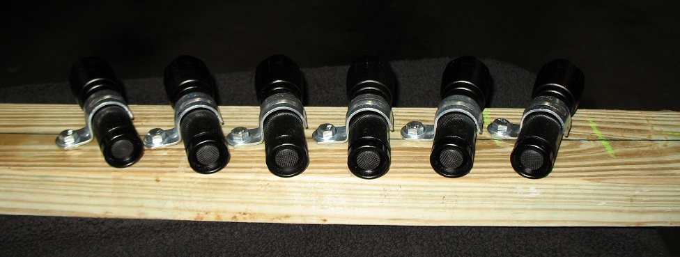

The flashlights mounted to the 2x4 (2x4 not cut to length yet; or painted!):
attachment.php
attachment.php

Those lights look like one I have a buddy gave me. He got a 3 pack at costco and I will say these lights are IMPRESSIVE for the price. Very very bright. Does yours have 3 brightness sightings?
I agree on the brightness being impressive! ... but no, they only have on / off.
I cut the 2x4 to length & mounted it last night, but it was cold as a _____ ... yes, even here in FL! ... so I'll take pics of the mount & the light results ASAP.
OK, it took me a while to digest your post, but I did now :thumbsup:
Are the LED's you put in your lawn tractor direct bulb replacements? Or do they require modifying the stock light fixture and/or modifying the wiring?
The LED floodlight you posted might work well if it can handle the bumps it will experience being mounted on a tractor roof. What do you think?
/ LED flashlights for tractor lighting - Will it work??!!! #14
Answer :D
LOL
Answer :D
They are H7 Bulbs, look at the end of it, you see the Metal.. They are SPADE CLIPS, you can get them at Walmart or Automotive store, simple to do, just cut the wire and then clamp it. Or if you got a soldering gun, that would be a breeze... How else can you go wrong, Possitive to Possitive, Negative to Negative, LOL
Answer :D
All you need is Bolts, the side Bolts that is on there you can just tighten them to the angle you want, you can adjust in the future too, that is a +++++++. The other end where you would Bolt to your Tractor have 3 holes.. i think that would hold nicely.
I hate to see you waste your batteries... Also, you have to switch on and off 6 X, LOL
I also mentioned, you can open the Flashlights, drill holes and connect them in series and solder them... but NOT water or snow proof, headaches in future...
Like this... in 3's
1+ go to 2- and 2+ go to 3- then 3+ go to your battery +
Lastly connect your 1- to your battery -
Because they are rated at 4.5 volts, since you connect 3 of them you got 13.5 volts, your Tractorr battery is about 12.5volts ... So you can use them directly to your tractor battery. No need to buy AAA batteries,,, LOL
Also, you can put an on and off switch between the 3+ and your Tractor battery +, this way you can just turn them on with a switch.
TIPS:)
Instead of doing all that, just buy the Floodlight i suggested before... No Weather gonna get it, rain or snow, your light will be ok, adjust any angle you want and no hassels, and no batteries to buy... More money the other way.
PS. You are gonna get more and use it as you headlights, and back up at night too, you'll see lol

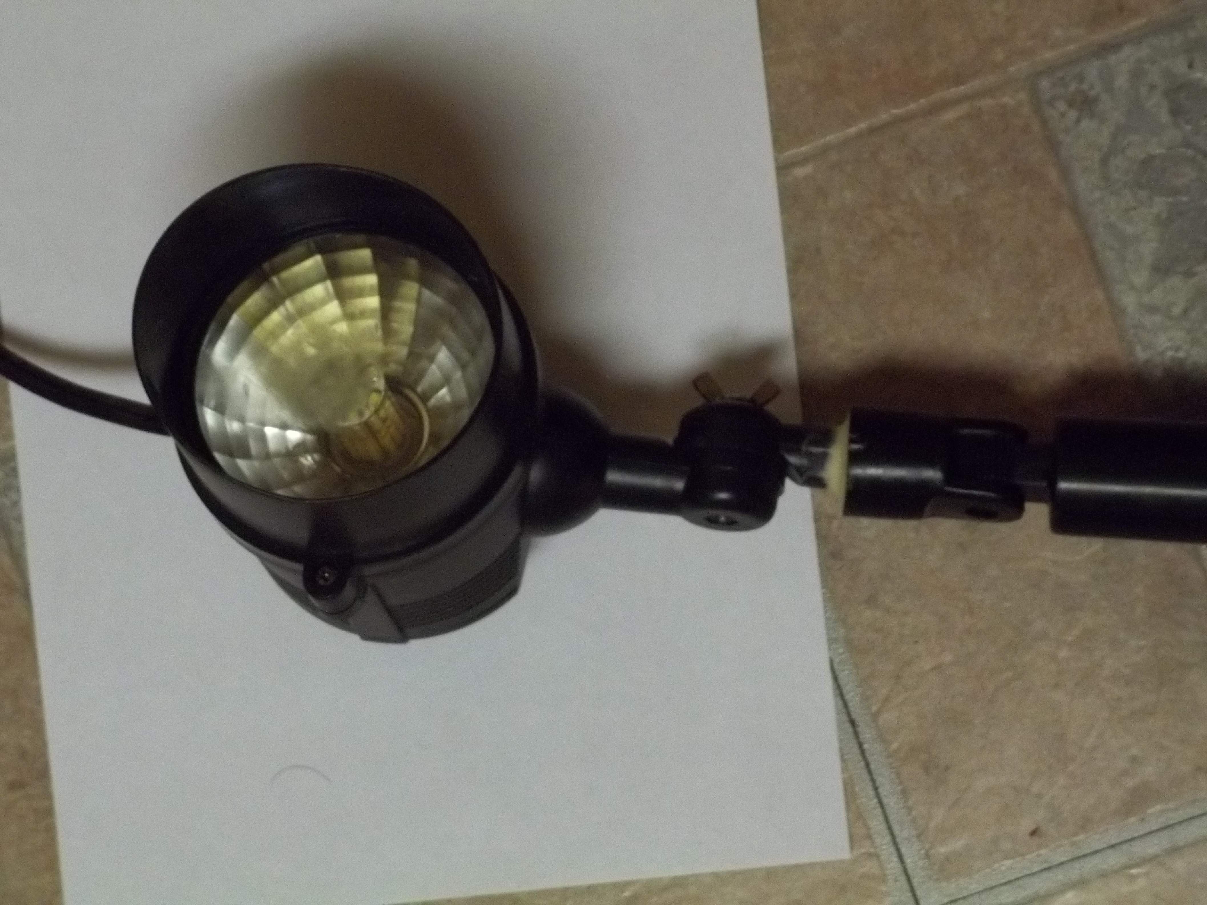

This light attaches magnetically. Good bit of light. Im going to mount a metal strip on the front edge of my canopy and try a couple of them.
27 LED Portable Worklight/Flashlight
/ LED flashlights for tractor lighting - Will it work??!!! #17
I have one of those, wouldn't give enough light for me in THAT application, but may meet your needs.
