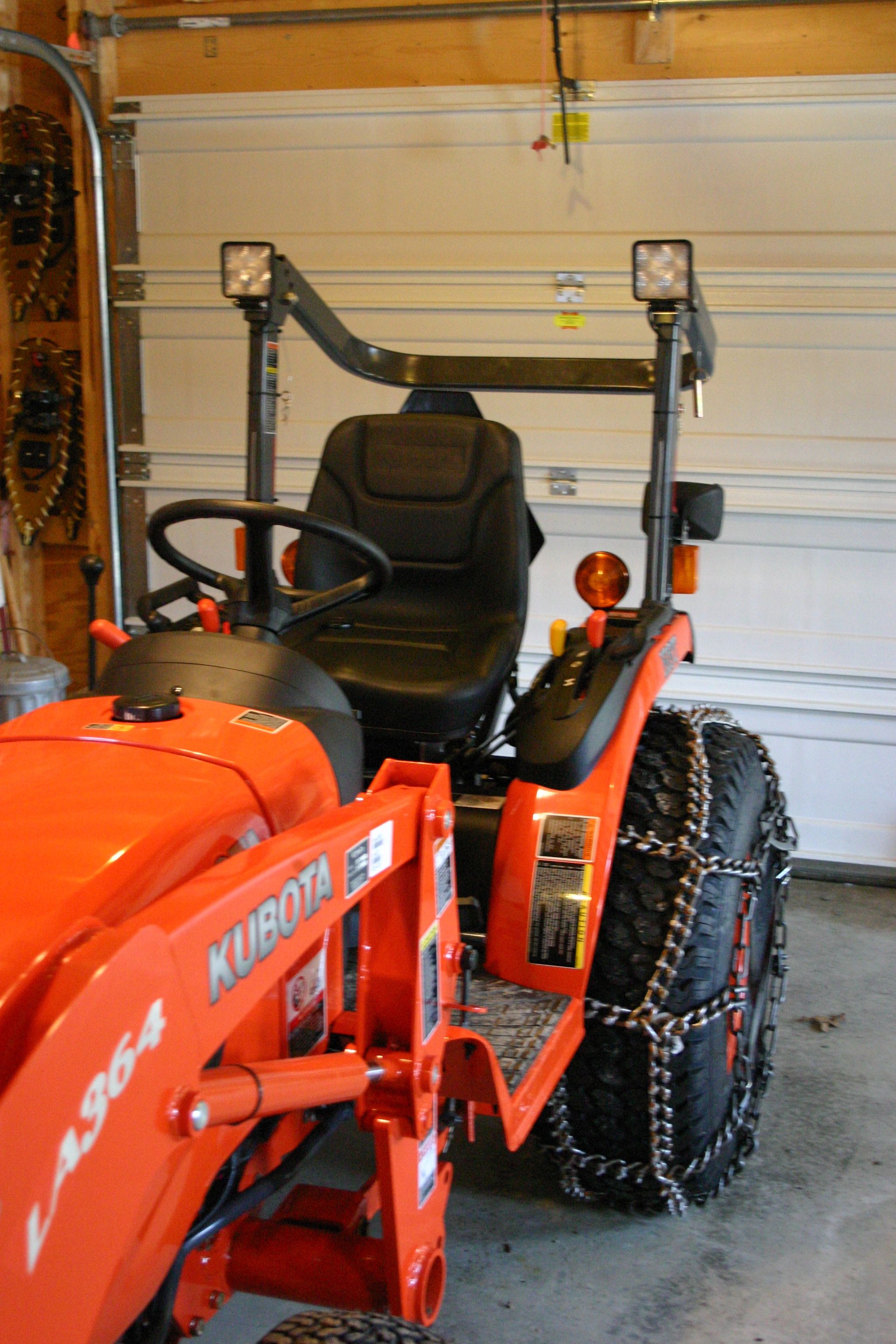

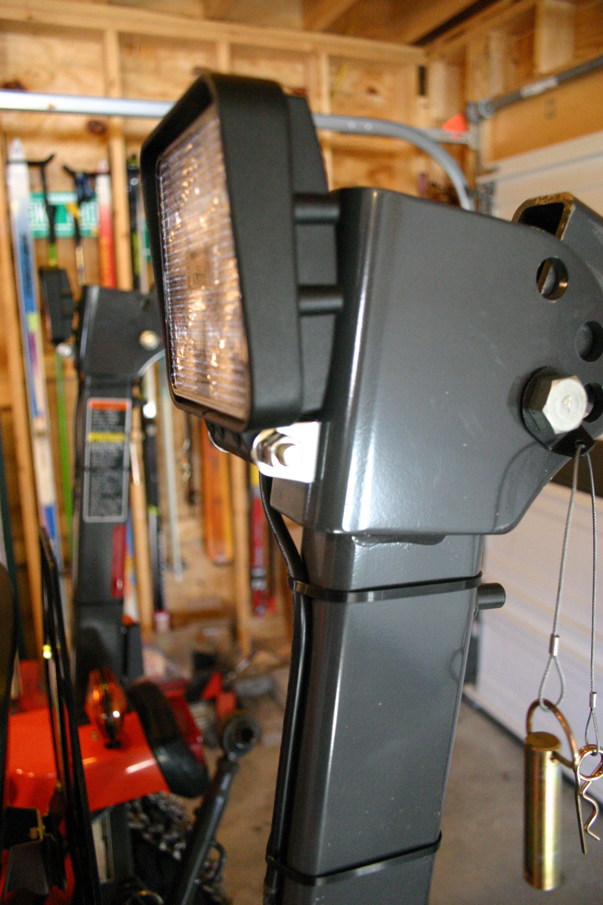

I bought a pair of the square, 9" LED worklamps from autolumination for mounting on my ROPS. Couldn't have been more expensive, at $75.00 each. Couldn't be more disappointed in the quality of the lamps or the light they emit. After soldering everything up, shrink-wrapping, etc. and installing (even with a Hella relay), they don't illuminate 5' in front of them. Worse still, one of the units had 1/2 of the LEDs blown out upon arrival (I should have checked, but went and installed one successfully and mounted the second one permanently, only to find that one was blown).
I was very unimpressed with autoillumination's customer service as well. I emailed them about the blown LEDs - and got a response, "we've never had any complaint and doubt you've installed them correctly." Well... I only installed automobile lighting professionally for 4 years. They made me pay for a new one as well as shipping. Got the replacement from them and while they did credit me for the $75, they still didn't pay for shipping.
Not 2 months later, the first lamp I installed blew out 1/2 of the LEDS.
I will say, when you handle the lamps themselves, they seem to be of very high quality - nice casings and stainless hardware. But, if you're looking to illuminate in front of your tractor, you're better off duct-taping a pair of flashlights. Cheaper, too!
/ LED Conversions? #11

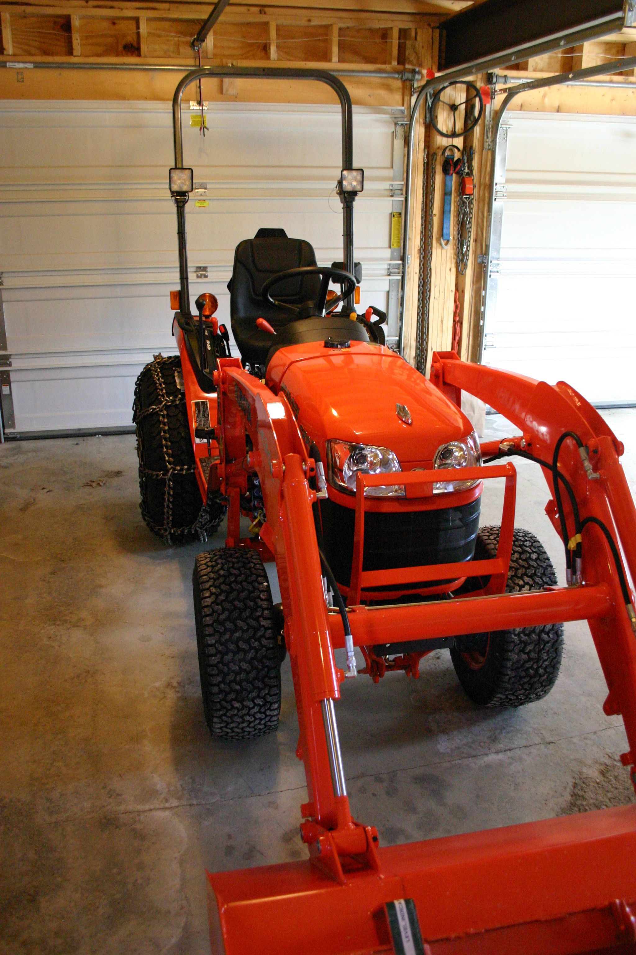

For what it's worth, here they are installed. What I liked about the square ones was the way they were perfectly sized for the ROPS - in that they weren't vulnerable to damage by sticking out to the side and I could still fold the ROPS.
